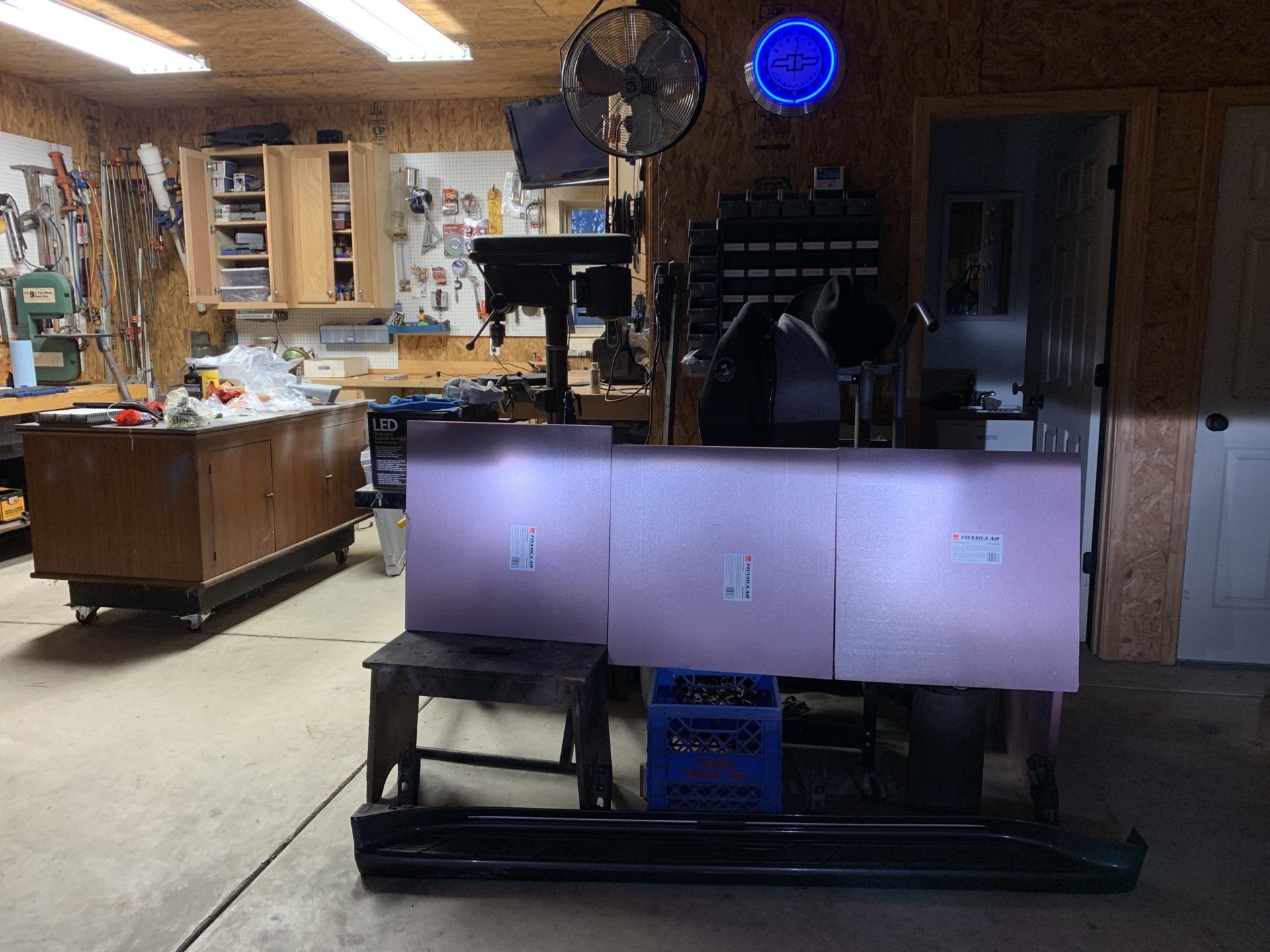

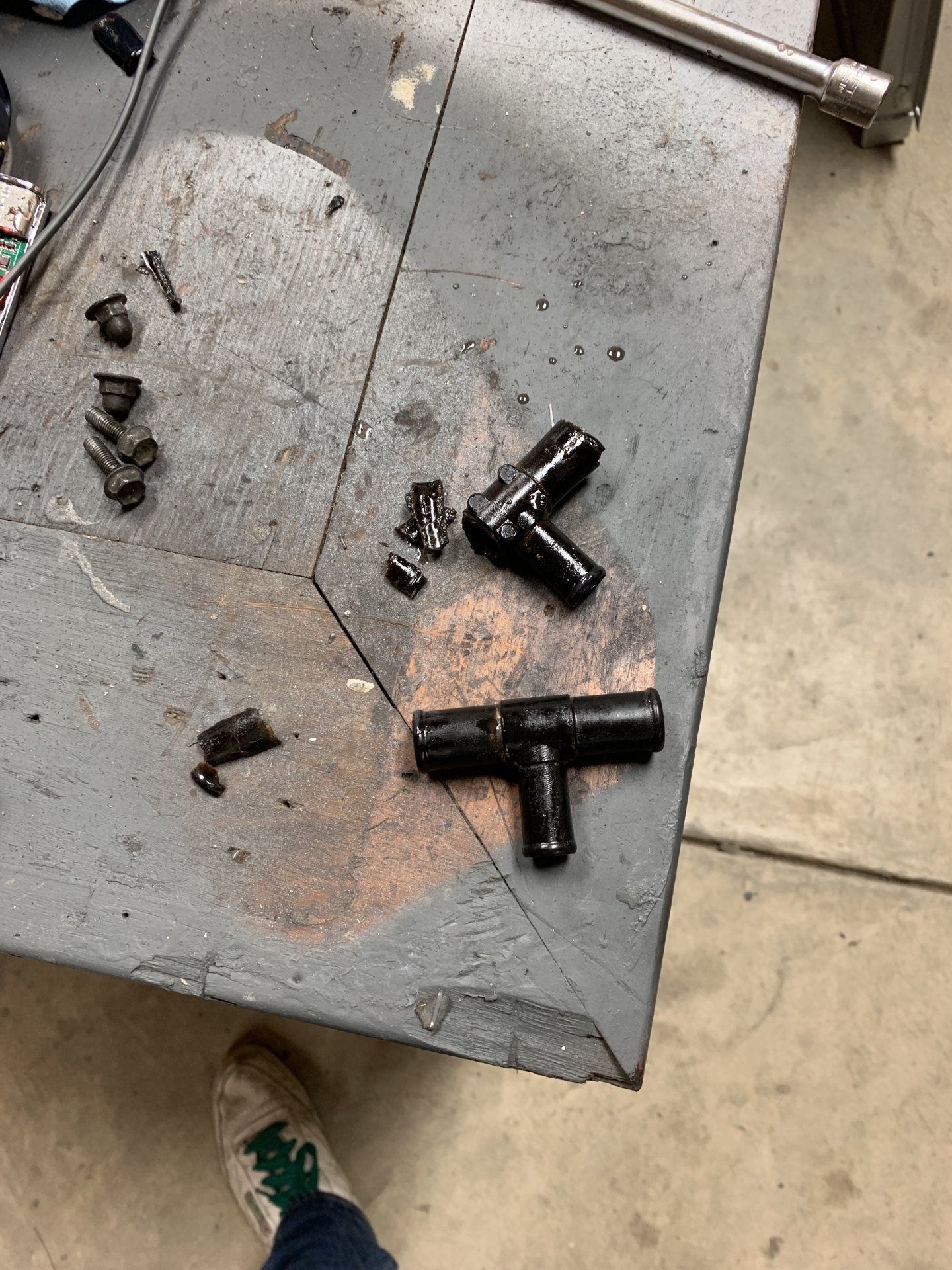

Heater Ts and headlight adjustment (got lucky!)

Could you elaborate on the headlight adjustment? Thanks!
I only did it on the passenger side since the driver's side was aligned correctly. The passenger side has a little white dowel sticking out the back that adjusts the angle up or down. A 1/4" drive 3/8" fit perfectly over (and incidentally got stuck on there) the dowel and at that point, I just used a 1/4" drive extender, a 1/4" to 3/8" drive adaptor, and a 3/8" ratchet to adjust up and down.
