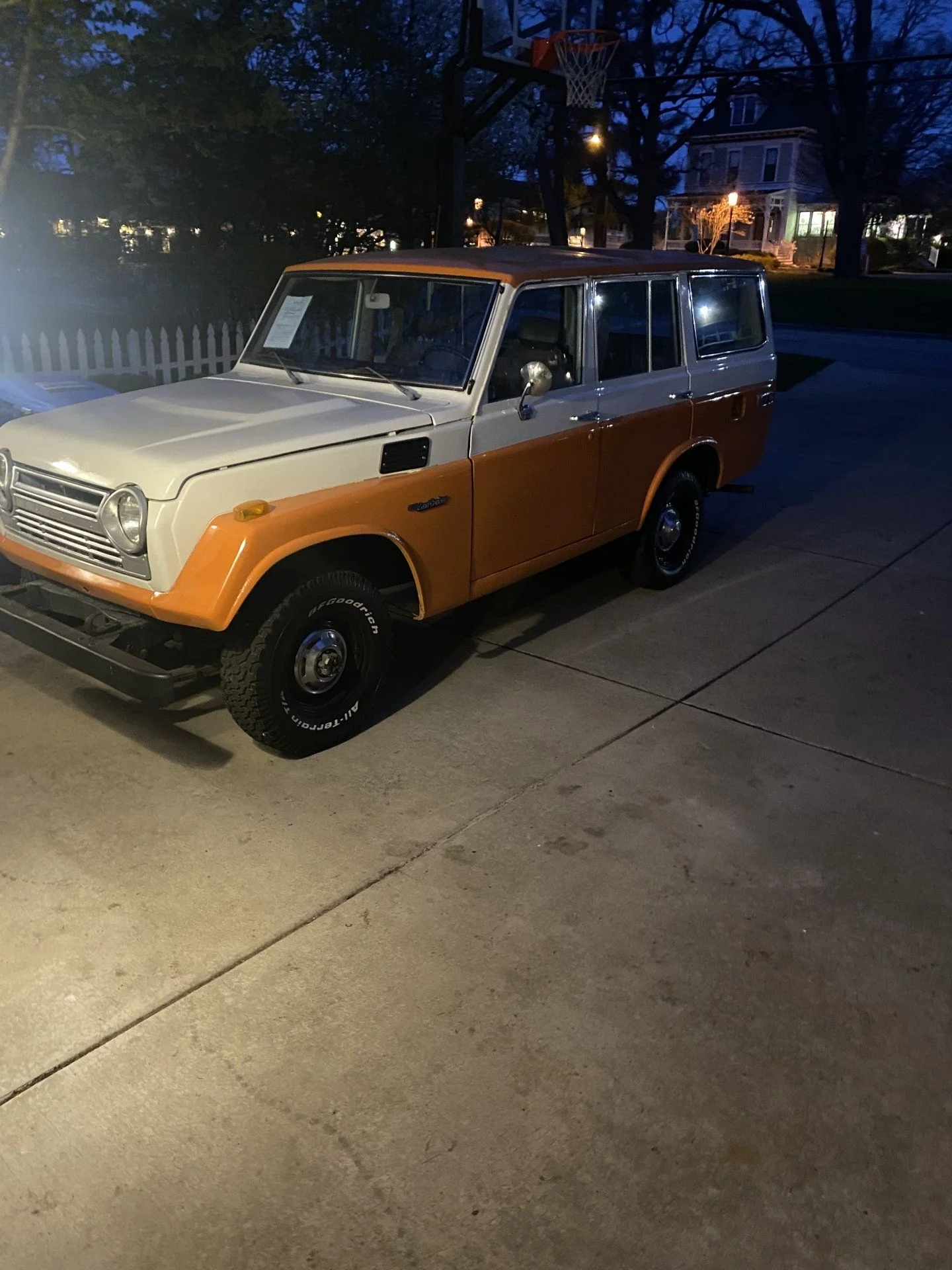

ive been reading and this is great! So fun! I just got a 79 and someone from this forum already helped me with a tail gate question. I’m curious what people are using for lifts and what it takes to get 33” preferably 35” on this old girl?
thanks
And lose the rowl tires... I kinda swoon when I see them.... 79, best year EVER! Edit: RWL.... Maybe worse?

If your leaf springs are good, you can fit 33’s on there no problem!
What size tires are on there now?
Congrats; fine looking swine. x2 on more pics and on turning the tires around. :D
I am running 33s on OME springs. I don't have before or after measurements but I'm guessing you get 2+ inches out of the set up. Kurt at Cruiser Outfitters can hook you up with a set. They are not plug and play unfortunately though. You have to move your rear spring hangers a couple of inches.
Call up Cruiser Outfitters and get their Old Man Emu kit, but you do have to move the rear spring hanger for the rear springs
Or call up Alcan spring and get them to make some springs that will work with the factory mounting locations.
Last i checked the springs themselves were about the same price.....OME vs Alcan
