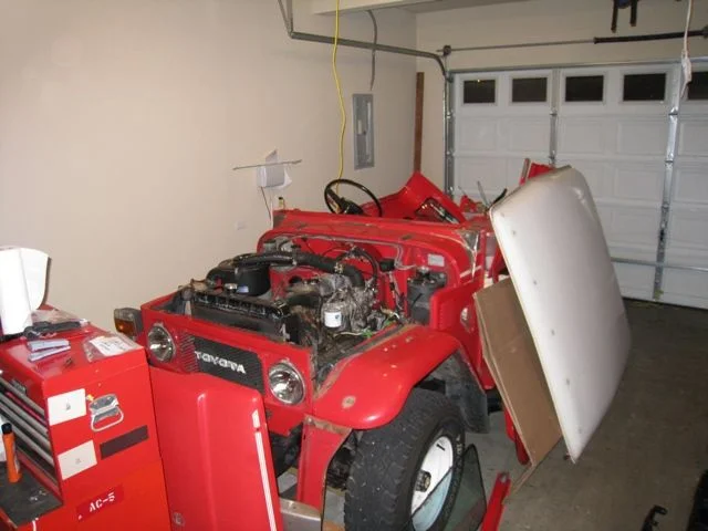

I'm in the process of dismantling my 82 BJ42 to do some rust repair, not really bad, but lots of small places that would cause me to repaint the entire rig. So...

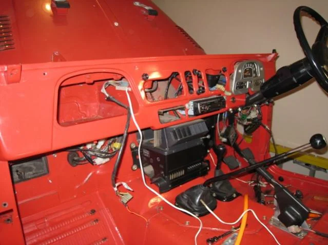

Everything has come off pretty easy with the exception of the upper door hinges. The two upper most bolts (RHD side) are hard to get at (fuse holder tabs, etc...) and the 12mm 12 pt box wrench appears to be slipping on the bolt head. I have f*#*ed the head yet so I wondering if anyone has a tip, tool or idea on how to get those last two bolts out. And since I'm on the subject of hinges...are the hinges seam sealed on the outside of the post or is it a gasket? When I pulled the three hinges, it "almost" looks like a gasket.
Lastly, anyone have a tip on hard top glass removal? Since I'll be repainting I just figured I get the windows out to see what's underneath the seals. I broke the windshield getting the old one out...seems like PO had it glued in.
Here's a few pics...somewhat constrained by the garage size...kids bicycles taking up too much space! :rolleyes:

there is no easy way ,are you using a hex wrench and not a 12 point ? you might get better acces by removing the cluster.my rachet wrenches have always worked well for that . good luck
I dont know why your takeing the hings out that rig is in good shape .Any way its much easier with the brake and clutch bracket out and the stuff on the other side . use a 12 mill ratchet wrench or a stubby ratchet preferably a flank drive wrench or 6 point.Once they are broken free they come easy .Try and relieve the seal around the body then bunt it up and down ( the hinge),then slide them out .I reuse that seal by just adding more seal upon replaceing. Seriously though Unless the bushings are shot dont mess with them.The windows come out by relieveing both sides of the rubber and come from the inside out .Leave the window in the rubber when you push the rubber out.
unless you are needing to adjust your front door fitment, there is absolutely no reason to remove that part of the hinge and in doing so you are setting yourself up for not only unecessary work but a nightmare re-adjusting the door all not to far down the road.
Drive the hinge pin out and be done with it.
Just because things can be taken apart doesn't mean they should.
The trick with glass is to work the seals when warm and never ever put stress on the glass in the long direction. Glass, as you found out, is not very flexible. Work with a small screwdriver and go slow with a helper. That is going to be an expensive lesson but that is how we all learned.

seriously that looks like its in good shape. i took my hinges off only because i couldn't get the hing pins out after weeks of soaking in pb blaster etc. and using an air hammer.
try a ratcheting wrench if you still want to take them out..
I've got the cluster out and am amazed at all the extra wires the PO had run to no where. I need to get a 12mm 6pt...ratchet head is too fat to get up in that upper column.

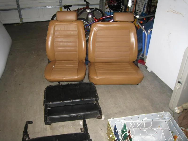

I'm pricing a re-upholstery job at the moment...the driver's seat vinyl after 27 years is cracked. I also purchased a set of the small jump seats to go with the cruiser. I plan on going with marine grade vinyl with the split bench, troop seats and door panels...the price I've been quoted ranges $800-950. Does this sound about right?
You can do it yourself for less than half that amount. It's work but it's not too tough. When I did mine I added heated seats for about $180. Glad I did. Check out SOR or CCOT for their seat cover options. I've seen people get theirs professionally done for what seems an incredible deal so If you're not up for doing them yourself, get a couple other bids.
Here's what the seats look like... The seats are somewhat different since the passenger headrest is positioned differently. I haven't seen bench seats covers for sale.

Bizarre. I don't understand a headrest positioned behind ones shoulder. It also seems odd that the jump seats don't match the color of the buckets. I think I would trade those out for true bucket seats in either gray or black.
I don't mind the bench seats...it works better for me when my dog drives with me!
I originally had the long jump seats that matched the front seats, however, I could not install a roll bar with those seats. I got these shorties to install with my Toyota roll bar. So...cracked vinyl driver seat and mismatched jump seats means new upholstery for me.
