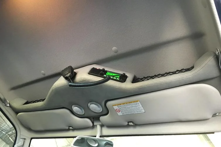

Going to do an overhead console deal too.....i liked this one due to how the sun visors fit up into the part. Looks really nice. Might run a switch panel up there.

That console is really slick.

I’d be in for an overhead too so long as it works for sunroofs.

Not so sure about clearing a sunroof.....
While not the best photo, I have this setup. On the other side resides a CB and HAM radio. This setup obviously wouldn't work with a sunroof.

I have not looked at this thread in some time. Funny but I am doing some things with that overhead console.
It is made by Cruiser Consoles in Toowoomba, Australia. I measured my 1999 PZJ70 and a 2914 HZJ76 and they are the same where the overhead console mounts. I am not sure is a perfect fit in the older truck but I am sure I can make it work.
Between the seats is also the same width new to old 70-series. So I am also doing a console from Cruiser Consoles.
