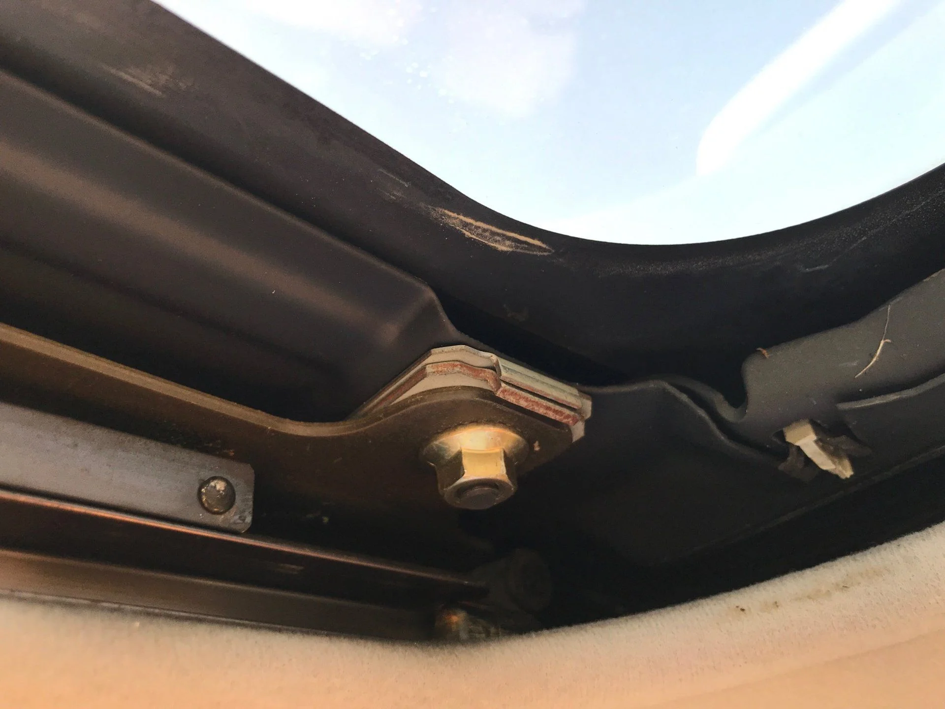

Did some riveting things when I got home from work yesterday, so I figured I would share it with the team.

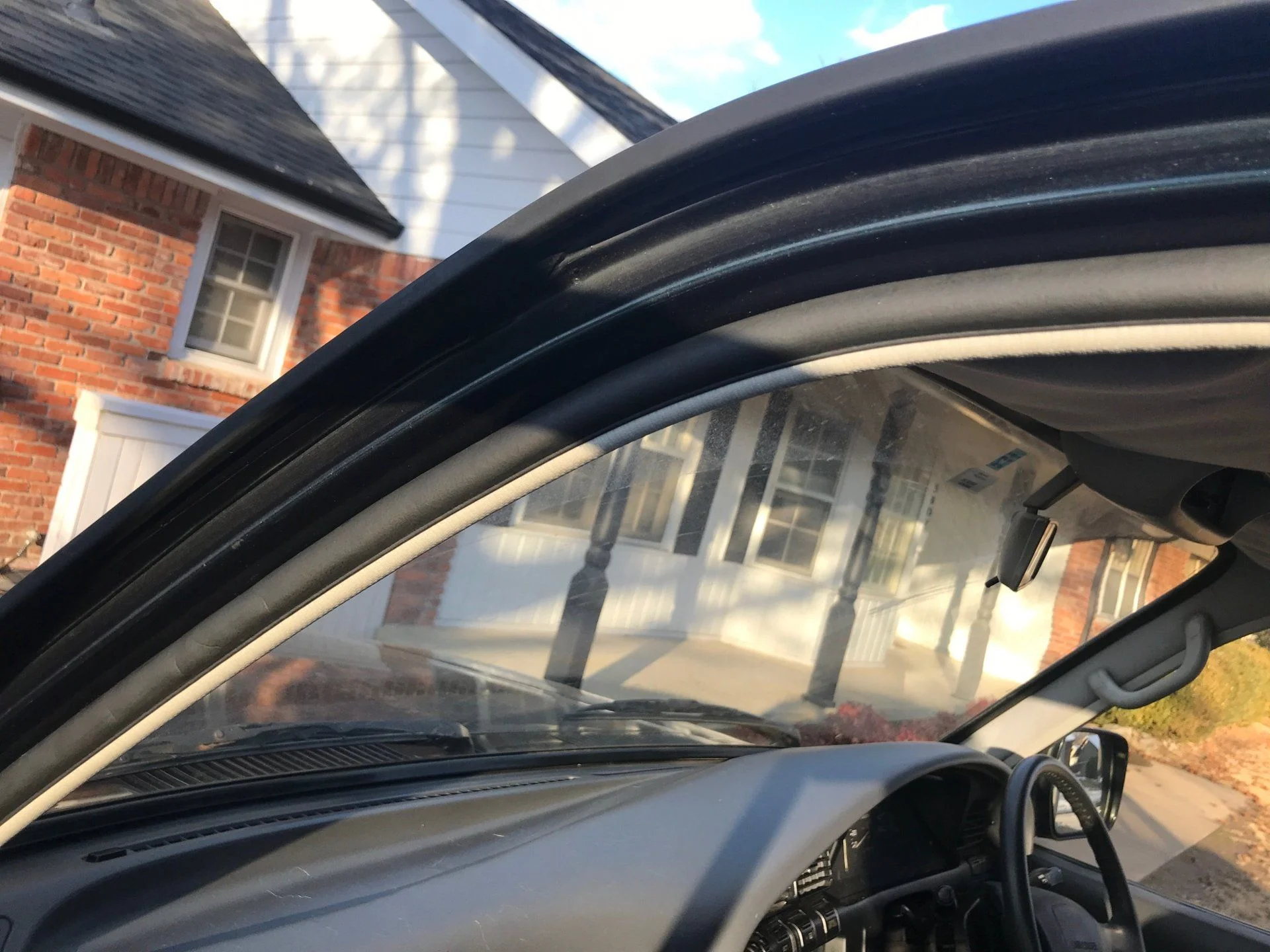

There is a few tolerable noises in the rig, some plastic panel rattles, dash vibrations, tire carrier clunk all mediocre low level noises but the Sunroof chatter , rattle, clunk is frustrating
I feel like there isn't much information regarding these shims on here because most sunroof threads are regarding leaks and wind noises. The part numbers are as followed, each shim comes in two different sizes:
Front: 63277-20030 & 63277-20050 (2x the thickness)
Rear: 63277-20020 & 63277-20040 (2x the thickness)
Once you take off(break off) the plastic trim for the sunroof its pretty obvious where the shims go
I still have the chatter so not sure if I need more shims or if its the dowels that need work. Have a half day today so looking forward to getting into it more.

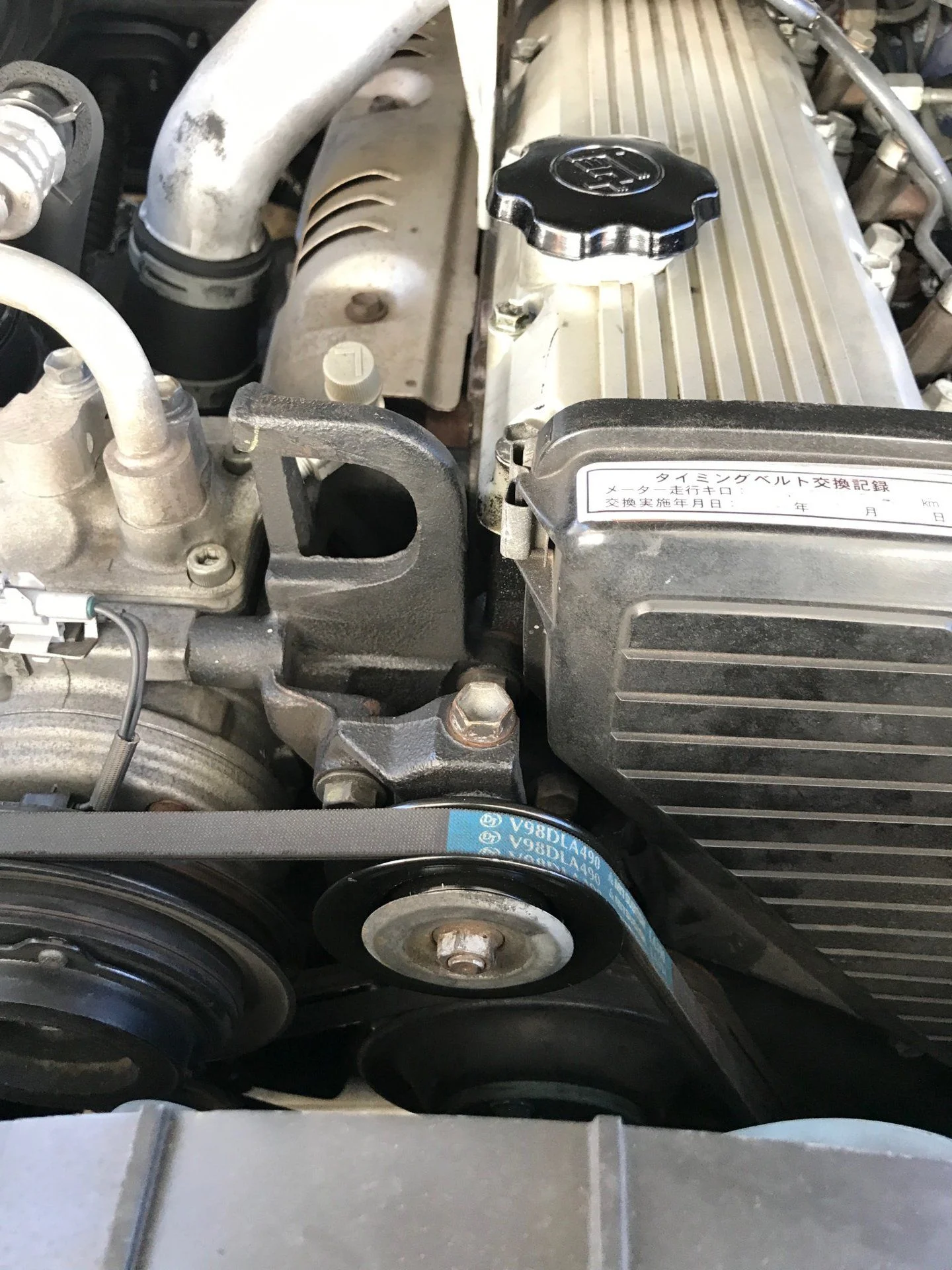

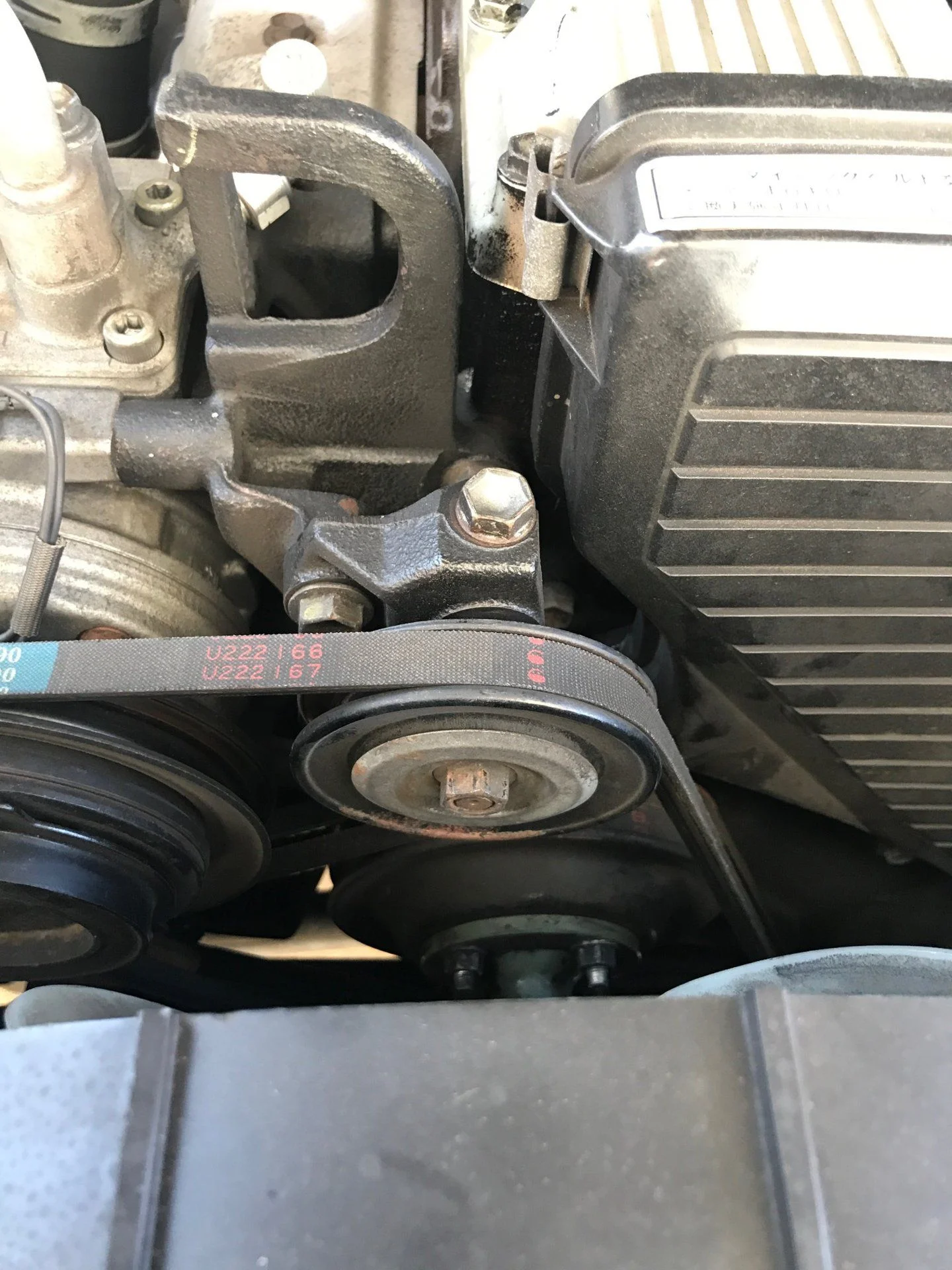

Had a pulley noise going on, belts seem fine, tension seemed fine. Decided to take a whack at the easiest fix and bam quiet as a church mouse

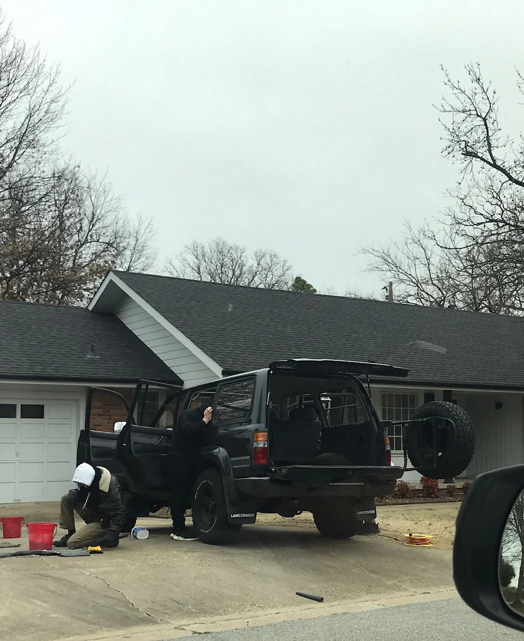

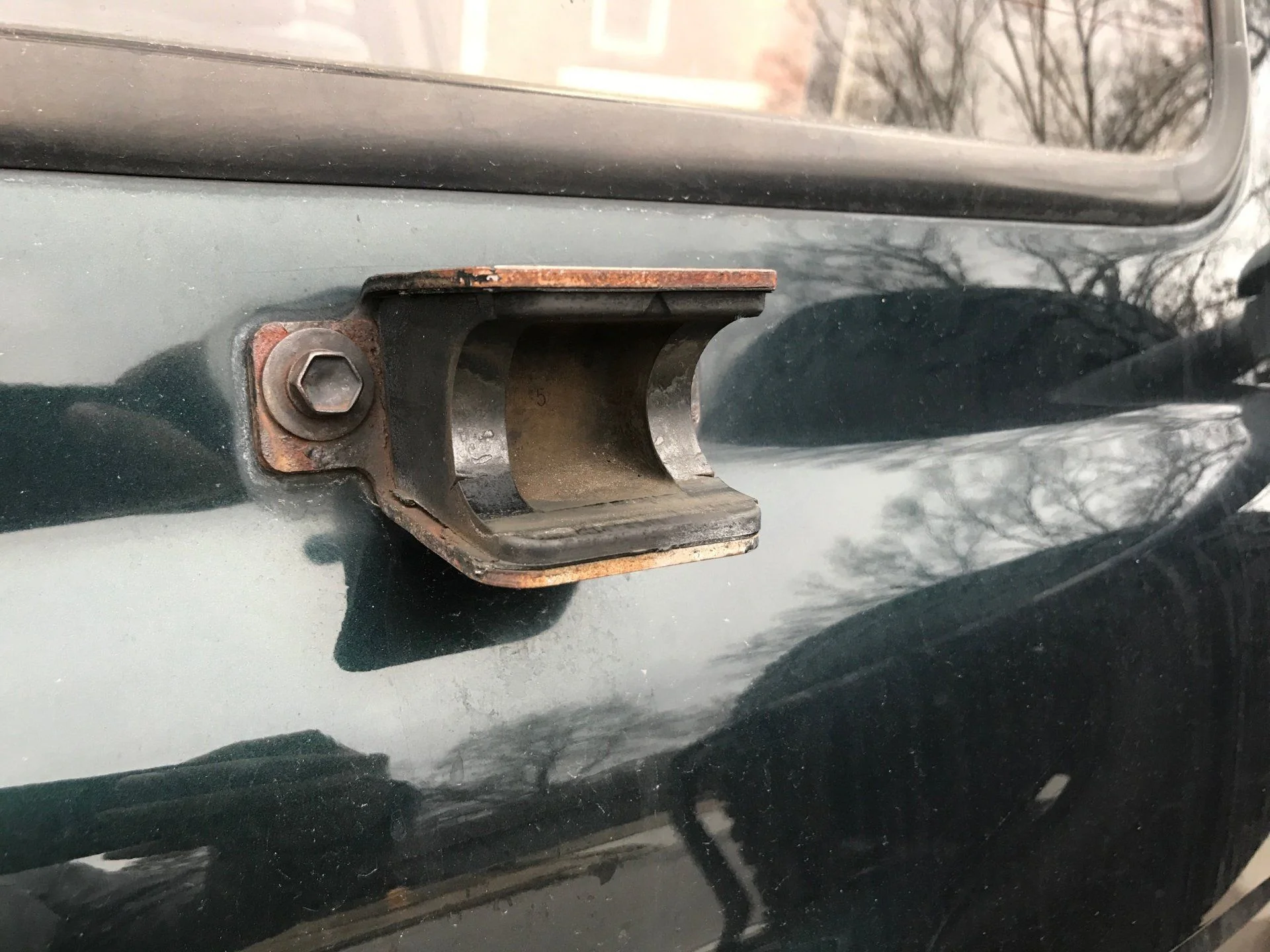

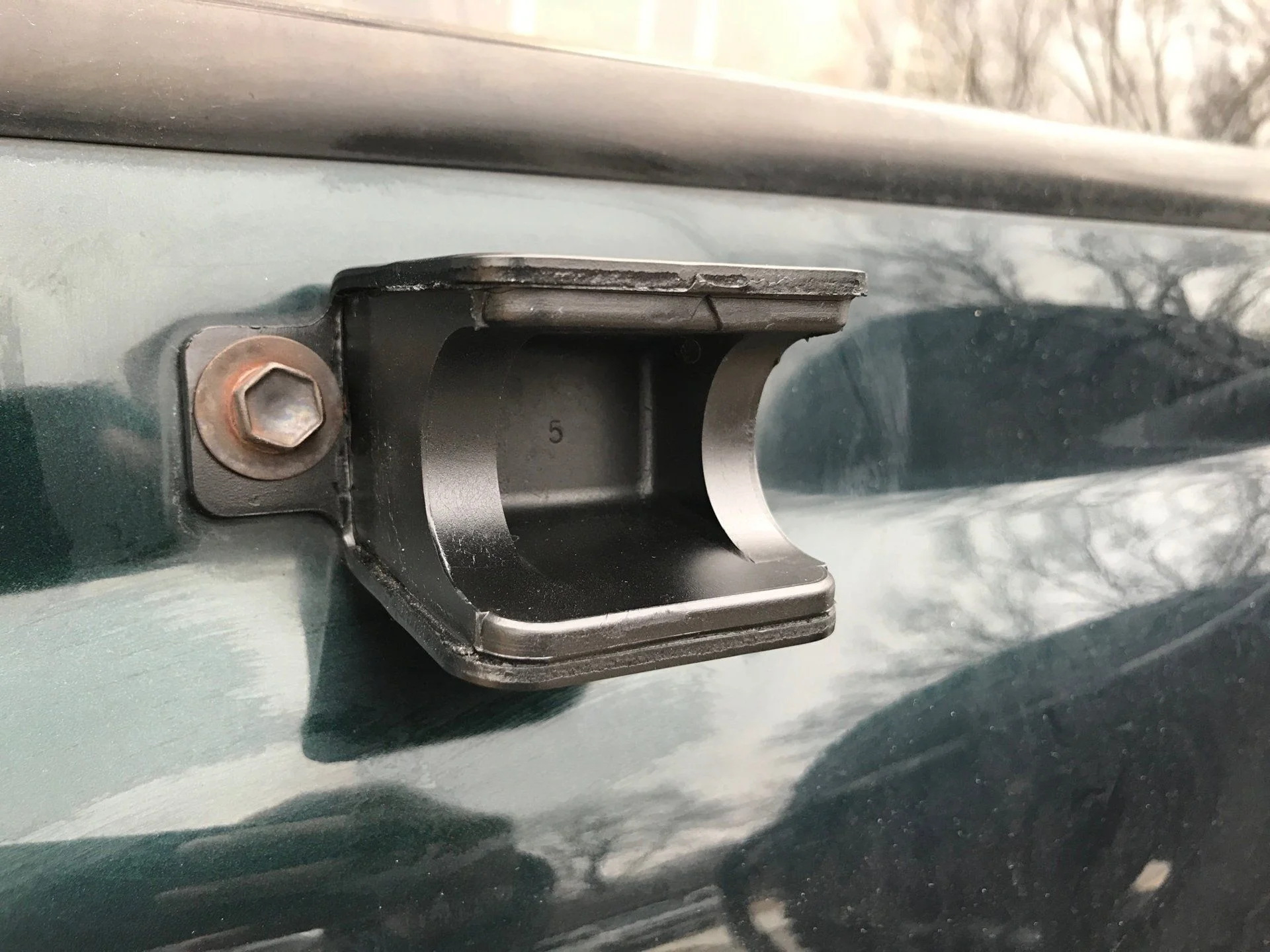

The wife wanted to go to Target, because it was a day that ended in "y". So I decided to look around for a sunroof fix, I checked my round dowels and they are completely flat, I tried spinning them like some have suggested and couldnt get it to budge.
The goal was to find a cushion of sort that I can stick there, be waterproof but be sturdy. And I found this glorious thing, will report back with how it worked out.

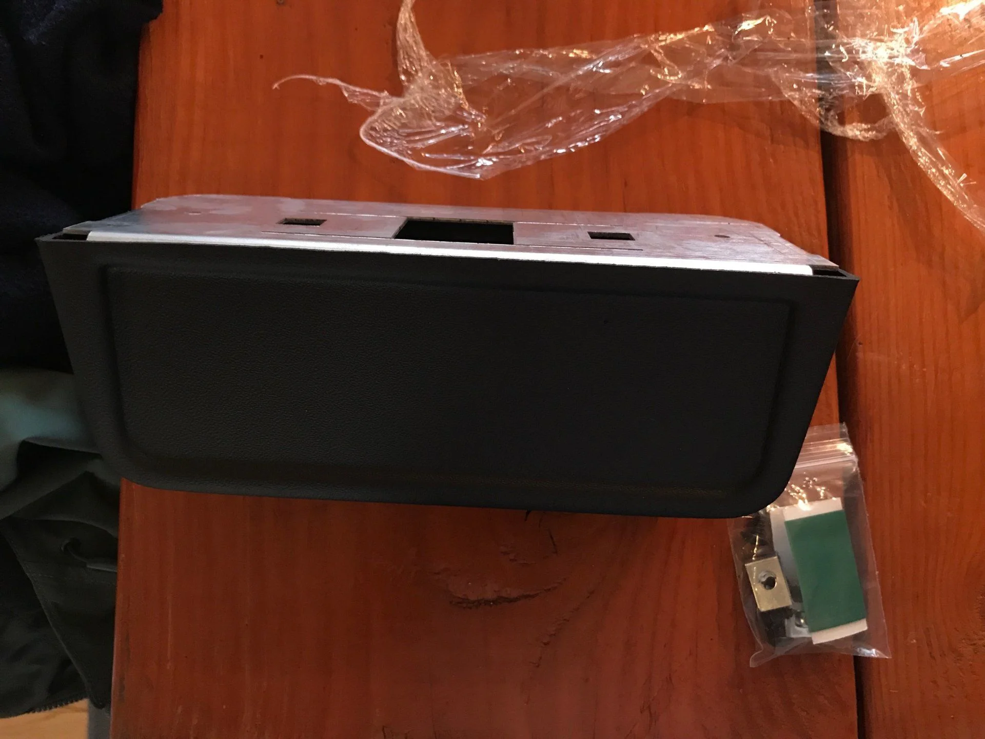

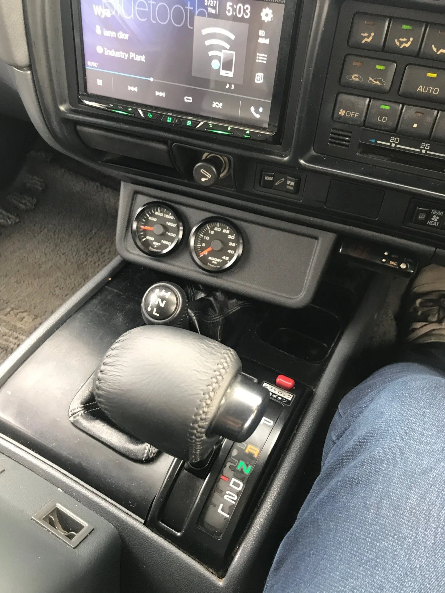

Still accumulating parts for what should shape out to a big install day. Took advantage of a Speedhut sale awhile back and picked up an EGT gauge and Boost gauge, tried to match the interior gauges. It will be pretty sad just seeing the boost hit 10-12psi for now, but 30psi is in the future somewhere
Will be installing the gauges into a Mudpod

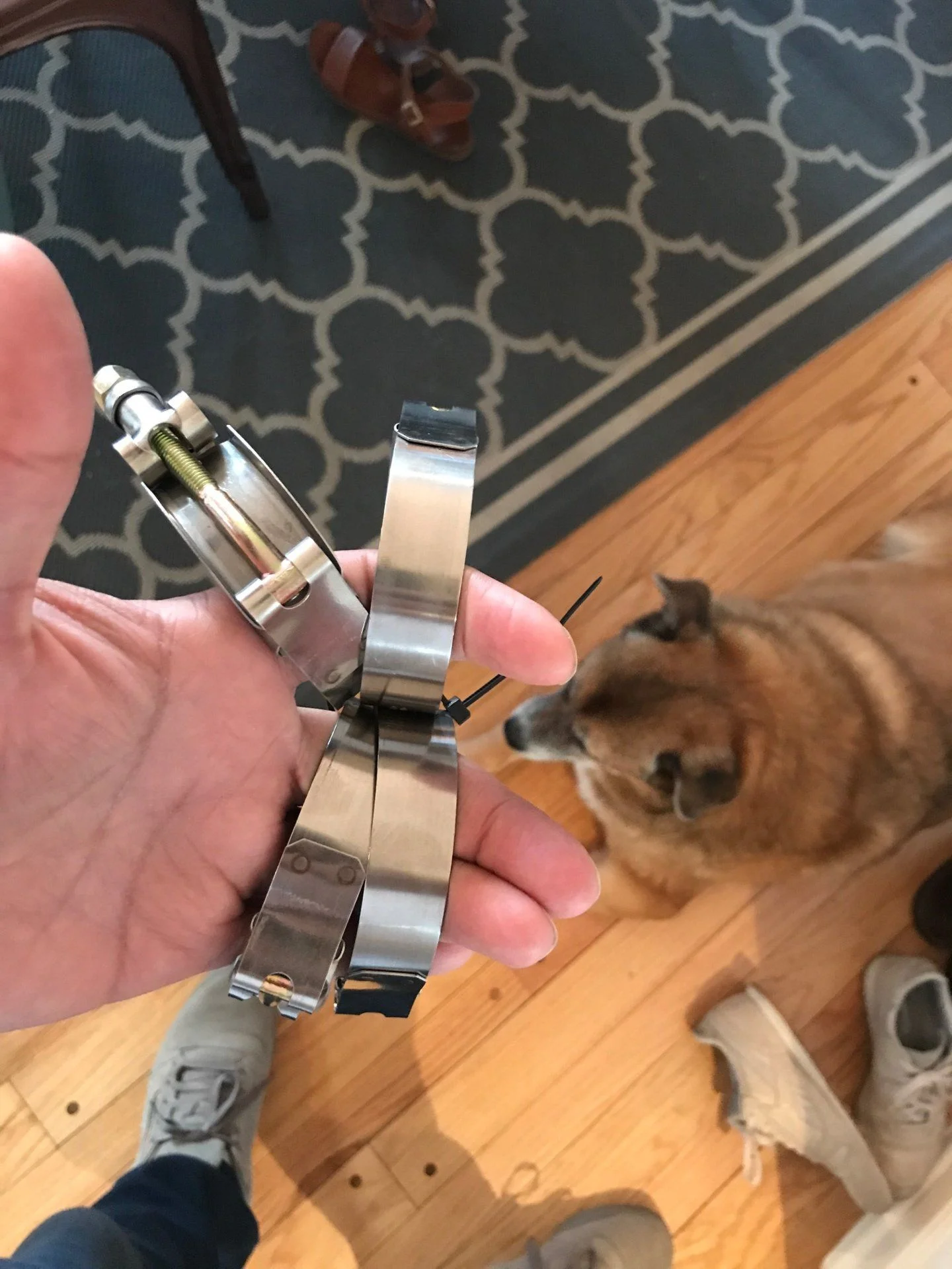

Also picked up some legit clamps for the intercooler install since

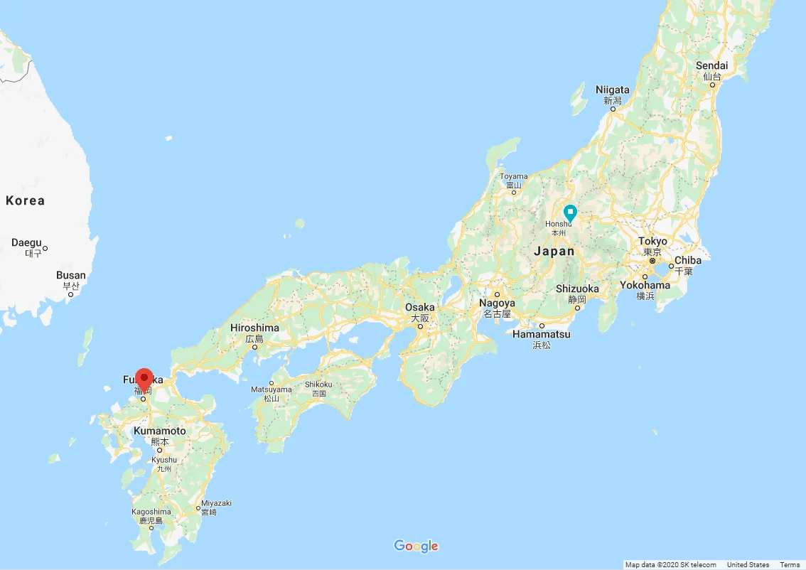

Also started to dive in some of the documentation that came with her and finding her origins, it looks like she may have lived in the same city her whole life, dealership was there and it was last registered there, Higashi Ward of ***uoka

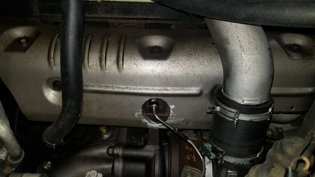

Got the EGT and Boost setup with the mudpod, looking at about 12psi and EGTs are all pretty low during my normal commute(500-800), will try to find some hills around here to see what it could go up to. If you know toyota diesels you also no one of the fears is managing EGTs, happy to find out I havent been driving out of spec and causing damage without knowing about it.
Now that I could monitor changes I will probably up the boost and play with the boost compensator.

Really happy with how OEM the mudpod looks, the curves and texture is just spot on for being made for a different car.

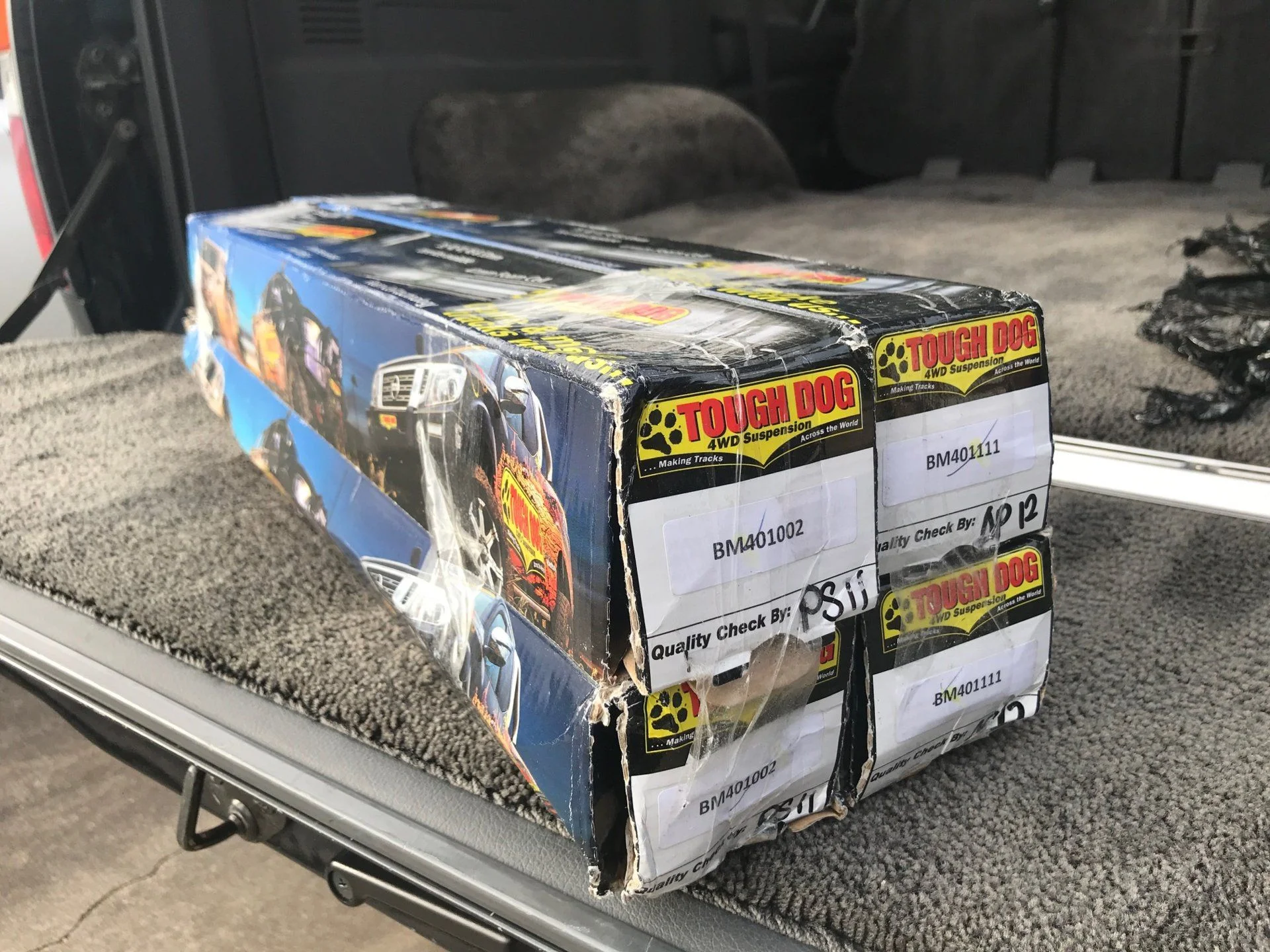

I seemed to be in a minority when looking for shocks, I wanted no lift but also wanted something well built and well tested. After what felt like months of random searching I landed on some Tough Dogs, great reviews, comparison test like this http://www.euro4x4parts.com/images/4wd_action_165_tough_dog.pdf , etc.
Not many options to get TDs here, our mud vendor and all around great guy @TRAIL TAILOR is 4-6weeks out and the only US supplier, so I reached out to an Aussie shop to see if they were willing to ship across the globe. Normally this would be way too expensive but since the USD to AUD is very favorable at the moment it ending up being a fair price, they were shipped out last Thursday and got here yesterday(3day shipping). If you can wait I recommend using TT because in the end of the day it would be cheaper still and you know.... support local, but if you need it sooner just DM me and ill give you the Australians shop contact.
