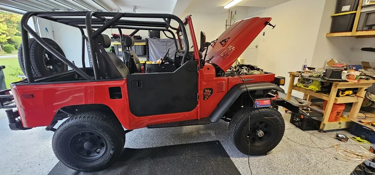

Memorial day weekend was a washout, but I got to spend some quality time in the garage.
I just created another thread about some of my electrical woes.
But here's what I got done:
I bought a pair of cheap Amazon UTV lights to use as dome/reading lights. I wish I had known they were USB-B charging. I had to go but a separate cable. I assume everything is USB-C now-a-days.
New LED headlights, and turn signal lenses. - I'll get another set of lenses sooner than later. These are cheap knockoffs and the fit isn't perfect. Also just changing the lens made the signal go from working perfectly to when the lights come on the the turn light comes on too. I have no clue how that happened...:rolleyes:
I removed the backseats. Which led to me removing the soft top. Unzipping the back released the tension enough the back became unhooked. Since I was planning on taking the top off soon anyhow, I just went with it.
I de-chromed almost everything. Until I ran out of paint. so the tailgate latches and hinges will be next week. The side mirror arms are half way done. But with more paint it will allow me to do some touch ups on the roll cage too. The hinges and latches were chrome and I touched up the doors too.
Then just to get under the skin of purists (j/k) I released my not so inner nerd and made some Darth Maul vinyl decals for the kick vents. From the first time I saw it at the PO's house it made me think of Maul.
Now I have the most beautiful FJ40 that's stuck in the garage 😭
Spent all weekend washing, clay barring, compounding ( the hood took 4 times to get some of the imperfections out), polishing and waxing.
Now I can't get it to start. I've run down the battery so am charging it back up. I wanted to take it for a quick spin this afternoon and nada. In the 2 months I've had it, it's always been a little diva to get started, but today it just won't turn over.
It's a shame because Tuesday I was going to take it to the local Land Cruiser club meet up. I really won't have time to toy around with it until next Saturday.
