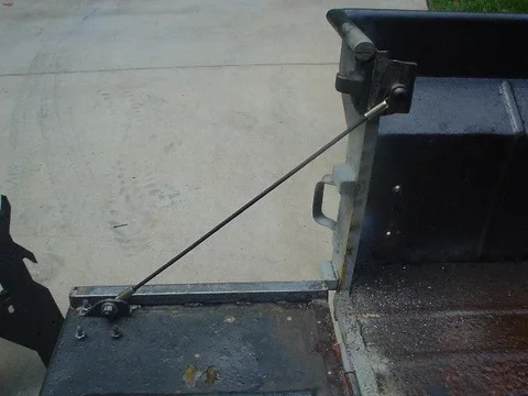

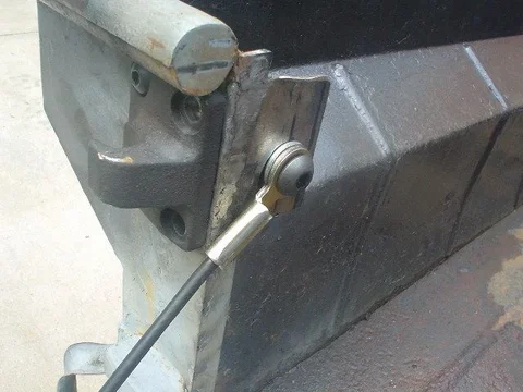

Well the truck is still in the body shop but it allowed me to get the tailgate finished - finally. Check it!

The tailgate cables are from a 72-80 something Blazer. They are a little over 22" long and were only about $20 for the pair. I figure trying to make something out of cable would have not been worth the bones.
At the top I cut the bracket off and an angle after I took the pic so they do not look so burly.

NOICE tailgate!
Those sharp square corners at the top front edge of the angle iron you used to reinforce the sides look like a nice place to catch your hand while loading or unloading something...
I do not disagree, but am way ahead of you. Thought the same thing and I cut them like this after I took the pics:

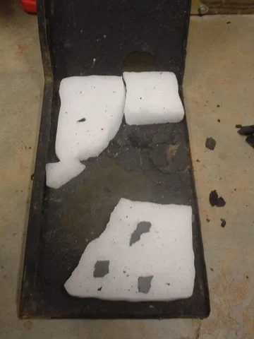

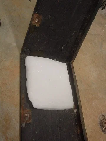

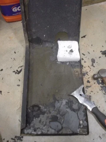

And on my way back from ATL today i stopped in Marietta and picked up $5 worth of dry ice to try to remove the undercoating from the fenders before blasting...
Surprise!
It freaking worked!
The trick was to let it sit and be in complete contact with the surface of the ice. then I chipped it right off with a 7 in 1 tool. It still took some elbow grease but only took about an hour.
