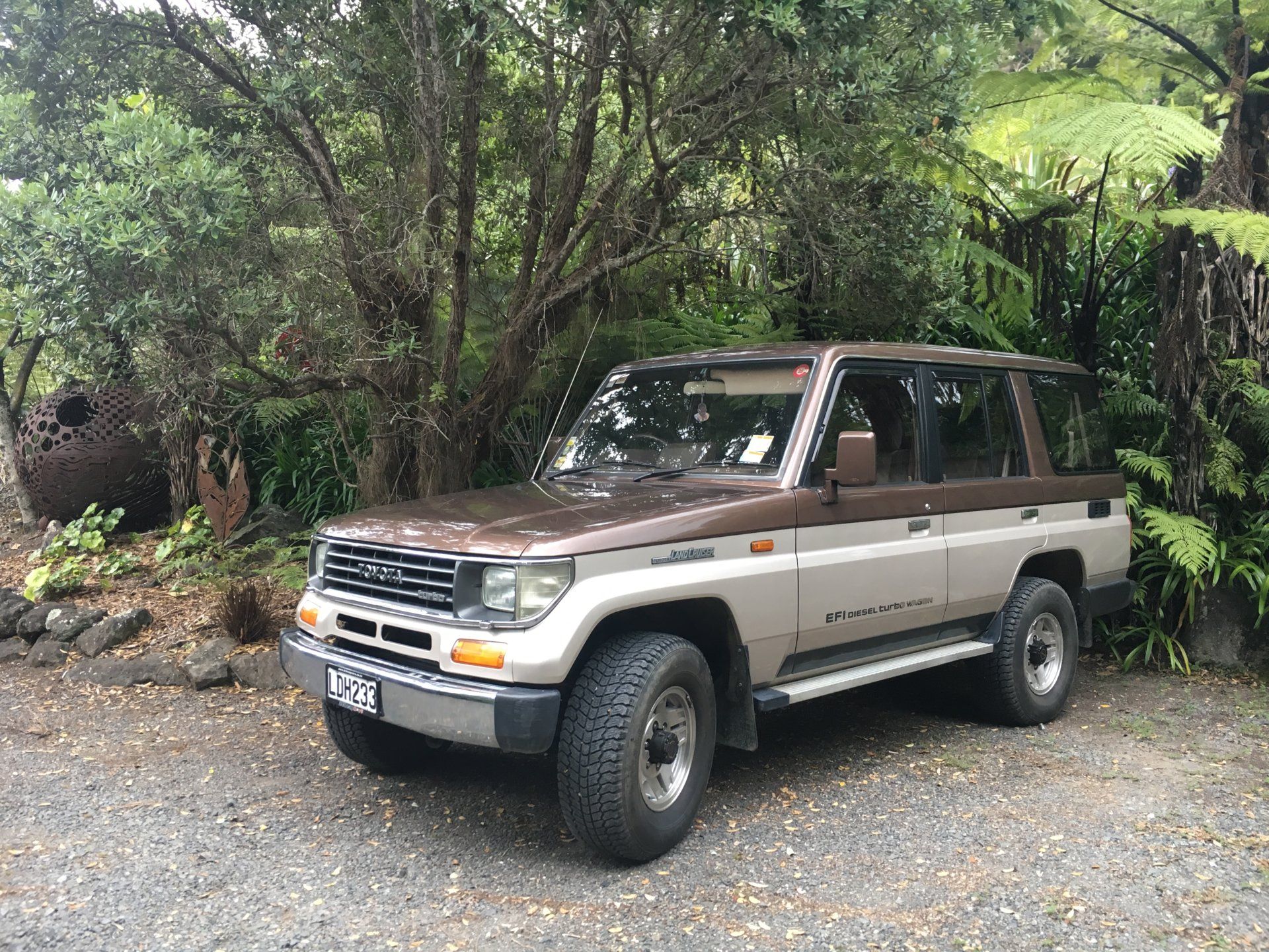

I wanted to create a thread for my new 1992 LJ78.
Picked it up 3 weeks ago with 110,000kms on the clock. Really tidy

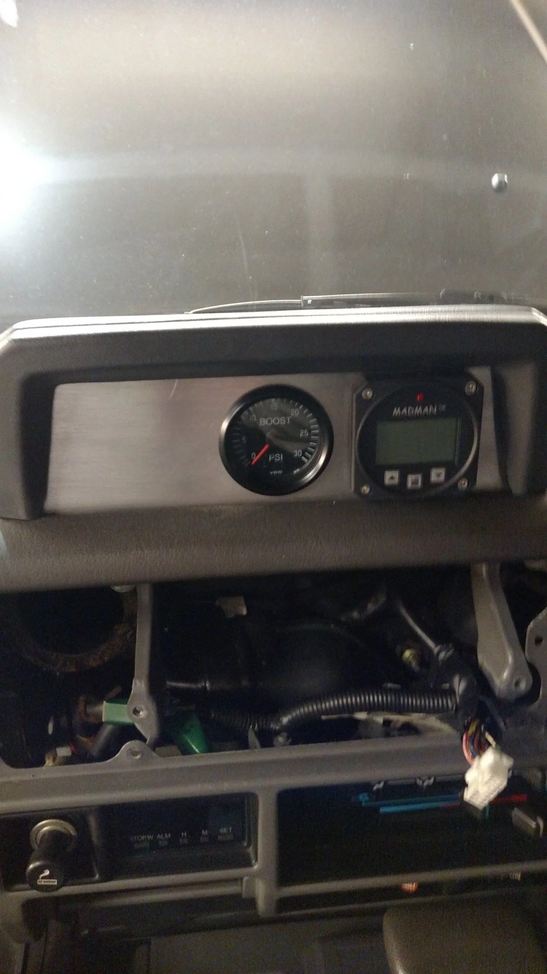

One of the first things I am thinking of doing is trying to install a manual boost controller and then a boost gauge, egt gauge and temp gauge.
Does anyone know a good manual boost controller to buy and then how to install it? I am thinking having the gauges replace the temperature and alimeter gauges in the centre of the dash. Has anyone done this and have designs for it?

Good plan on moving forward with some gauges. Personally I left my interior/exterior temp sensor and altimeter pod intact because I find the temp sensor part useful. Especially when temps are hovering around freezing, I know to watch out for ice on the road. To each there own. Sure is a nice spot to put gauges.

I haven't gotten around to updating my thread in a couple of weeks, but yes. Gauges fit fine in the dash pod.
Watch out fo the depth of the center gauge as there is a metal brace for the back of the Alt/Temp pod that isn't terrible far back. A shallow gauge works just fine.
I am going to use the last spot for trans temp or exterior temp later on, I have just been doing so much lately to mine I decided to wait on the last gauge until I get caught up with the projects already in the works.

Sweet looking Prado! It looks just like mine, even has about the same odometer reading (I just turned over 113k), but yours is in better shape. In my last Prado I redid the altimeter pod with gauges, there are photos of it here: 1990 LJ78 in Montana

Also, when you get an EGT gauge I would highly recommend putting it in pre-turbo rather than post-turbo to get a more accurate reading.
