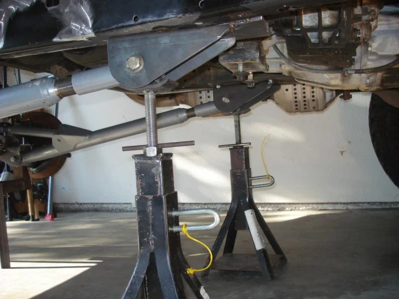

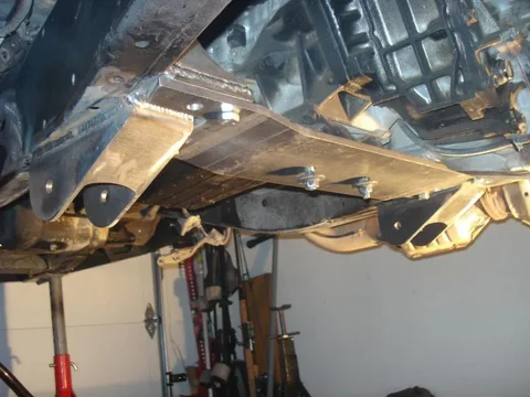

The cross member was a different matter. I had all kinds of ideas but I wanted it to help support the front radious arm brakets, be removable and be able to add on additional skid plates as I see fit. I have to take pics of the finished crossmember.
Did you improve clearance at all with your new cross member? Or did you just keep the same basic design of the OEM cross member?
I kept the same tranny height but the crossmember is a single piece of 3/8" x 7" flat bar. It is thinner (not much) but alot stronger. My plan is to fit a early style tranny mount so that I can use flush bolts through the bottom.
