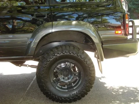

Front and rear wheel well.

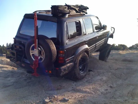

Absolutely Stunning. I freak out with every update. Any Flexed shots?

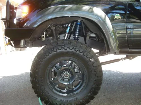

I apologize if I missed it, but how much lift did you end up with? It looks like about 6". I am guessing the front coilovers are well balanced with the rears due to the weights you provided. How does it brake?
Very nice job. I would love to do that to mine someday. I would love to see some trail/flex picts next time you get out.
I belive it's around 6" but my plans are to go to 37's and lower it 2". The rear Slee springs are awesome! The braking is great now with the ABS and rear load adjuster locked out.
I'll get some flexy shots soon. I've been busy with working in Vegas about half way through the build. Looking forward to getting out for a good run/test. I'll post the only one I have so far.

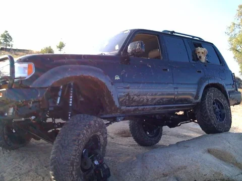

These are the only flex shots I have so far. I've set up the the front suspension to fully stuff the tire deep into the wheel well with full steer. I look forward to more testing.
Jodo
I dig the BMW and the dog peeking out the rear slide window!
