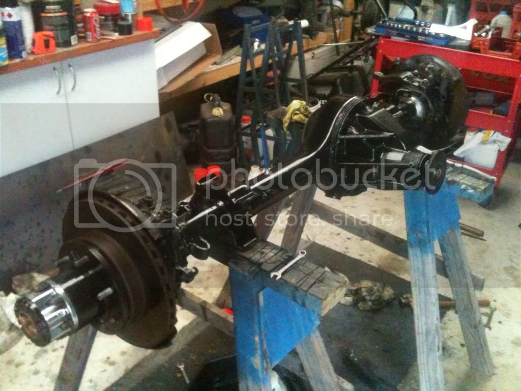

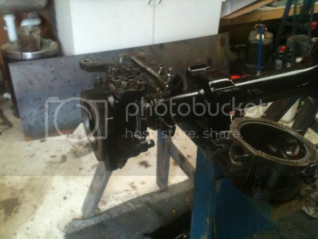

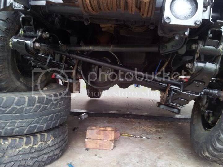

ok so i did a bit of work today on the diff got it all back together which is a nice an messy job didnt get too many pics mainly cause my hands were covered in grease the whole time

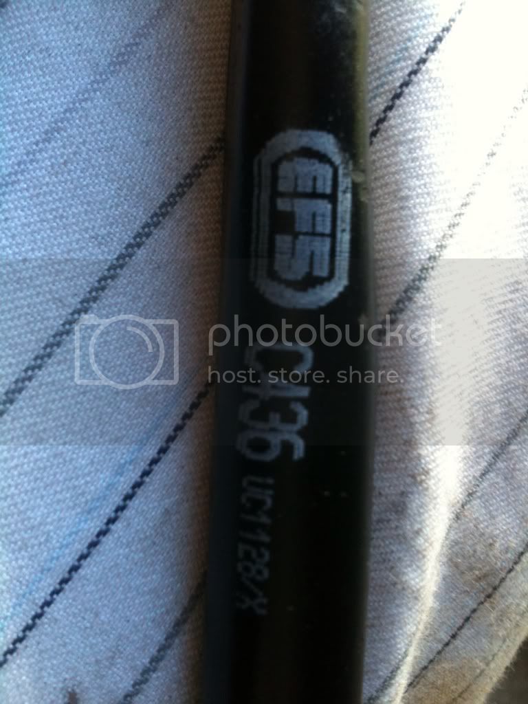

after i got it all together i decided to check whether the hubs locked properly and unfortunately one side wasnt working so i pulled it out an had a look and the spring had broken i had a look when i had it all out and it looked perfecly fine so i dont know what happend but ive ordered a new one and also ordered EFS extended shackles and a brake caliper repair kit. i was going to just fork out some money for new calipers but thought i might aswell give a repair kit a go since its alot cheaper and spend my money on extended shackles and other small things

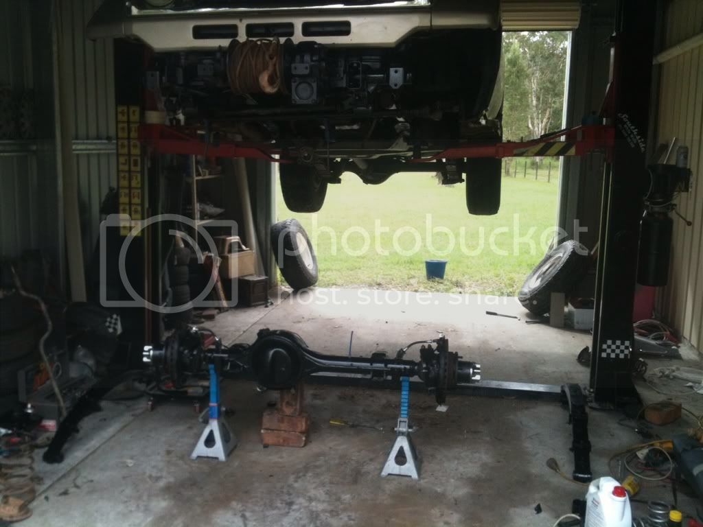

should hopefully get the diff back in tomorrow with the new springs and i might try and get some flex shots

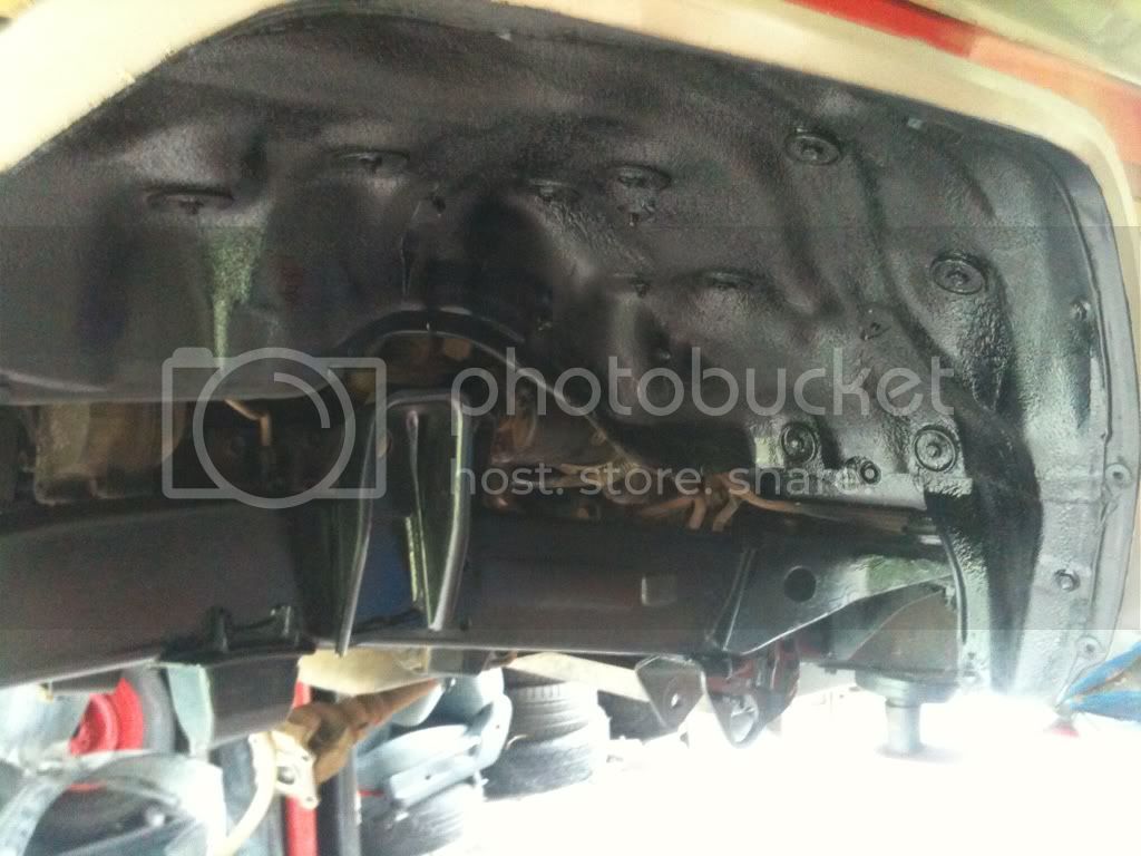

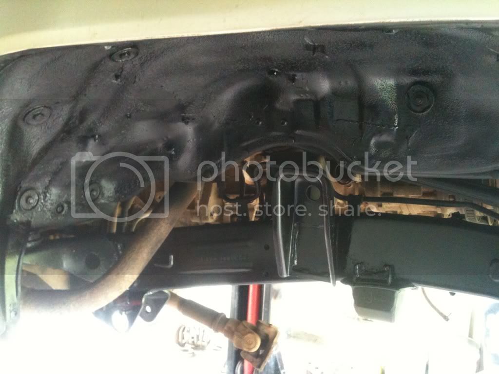

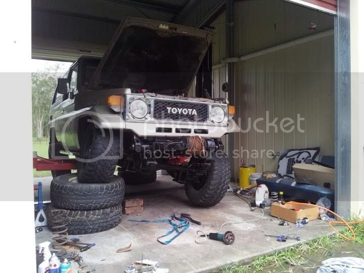

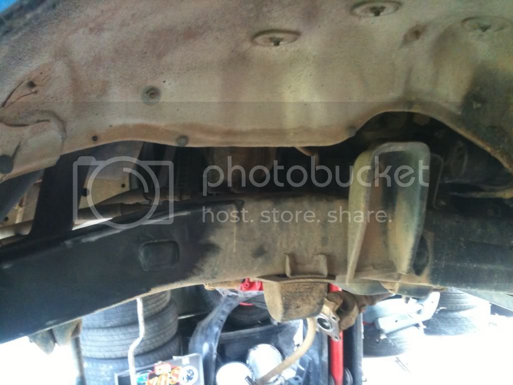

ok so today i preped the chassis and everything for the diff to go back in i wire wheeled the chassis and sprayed new body deadener on the inner guard

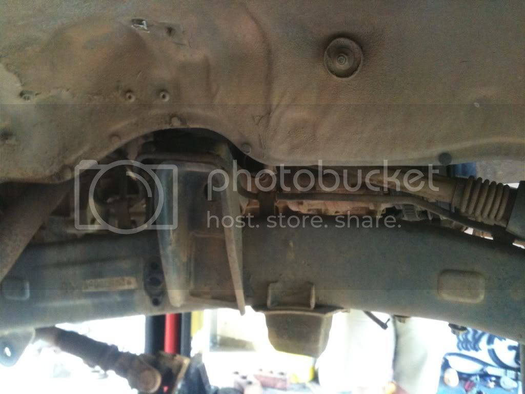

It went from this
To this
then i put the diff back in with the new leaves

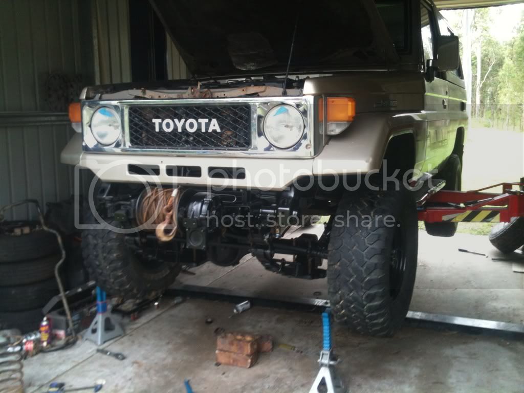

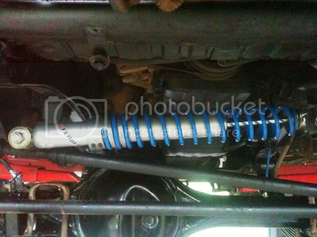

also installed my new steering dampener

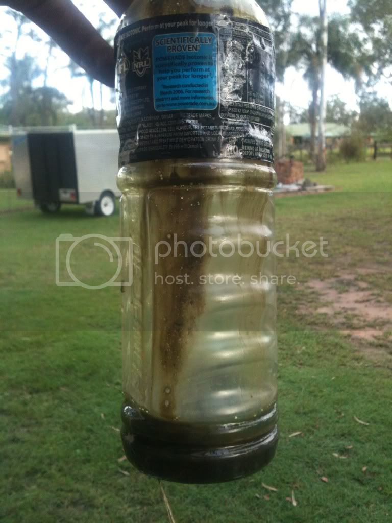

and i changed the oil in the pto which it looked like it had never been done since it left the factory
this is what was left black chunky bits of oil and water

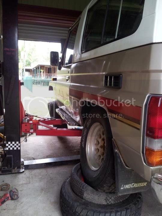

then i got some flex shots
hopefully next weekend i should have the brakes and everything in and start on the front bar and sliders

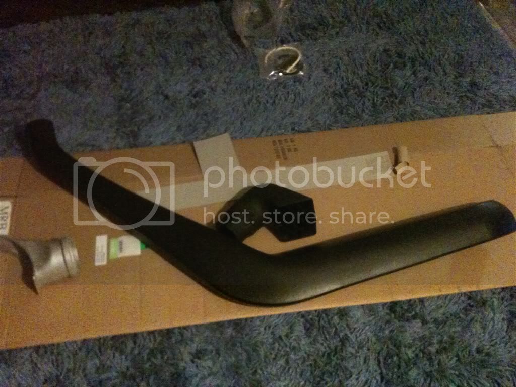

Bought a snorkel a few nights ago and received it today

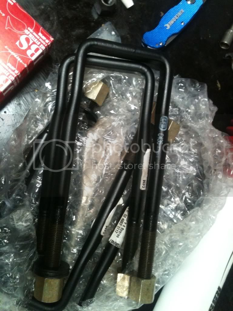

Also got new ubolts for the diff because the original ones were too short so this weekend I have a few things to do hopefully should start making the front bar by monday

And the snorkels umm homebrand. nah it's just a noname brand made in Brisbane for $150 delivered

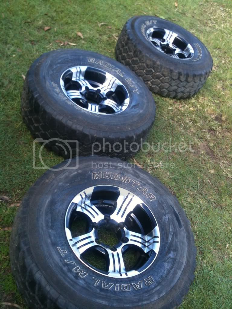

Also this morning picked up a set of allied alloy wheels
And got some new EFS ubolts

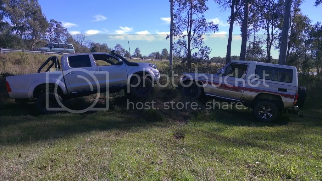

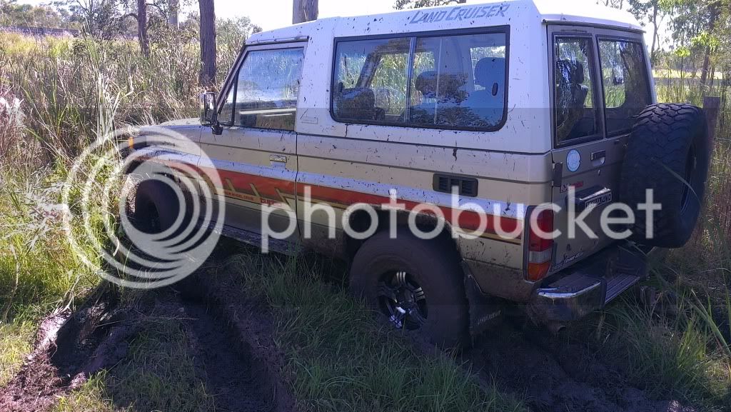

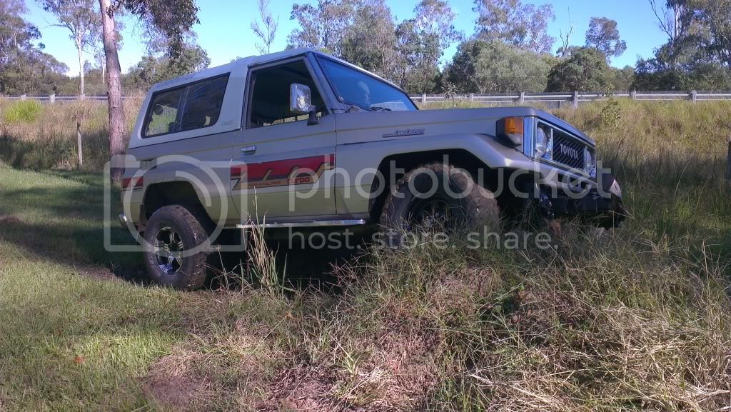

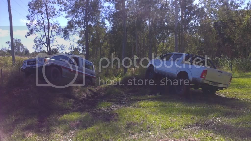

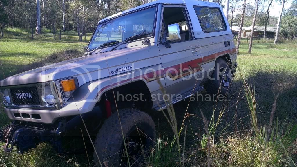

Finally got the cruiser out of the shed and had a bit of a play in the mud and got it bogged a couple of times
Some pics
And one of when I got it bogged

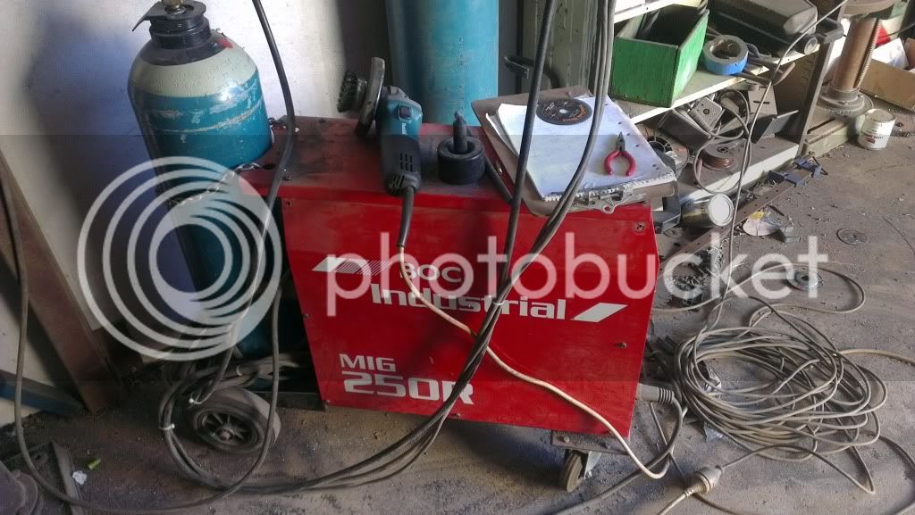

And then I cleaned it and put it on a truck to my work and started playing with this...

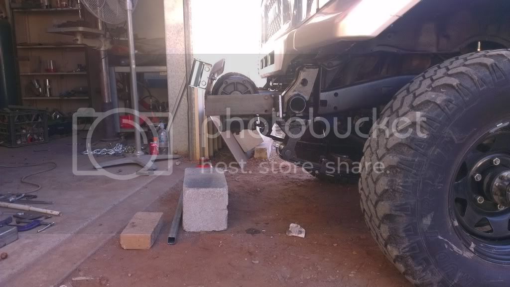

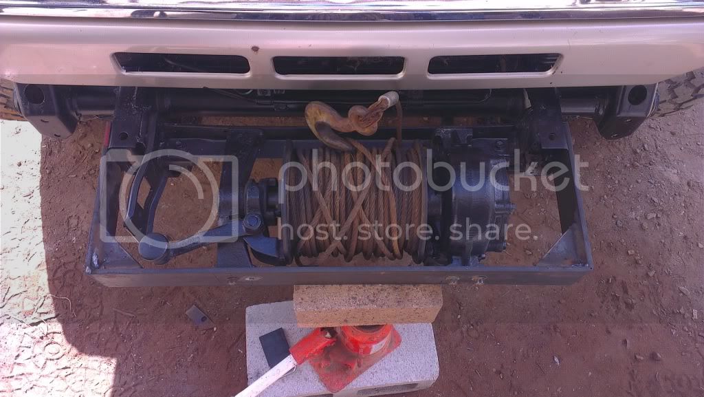

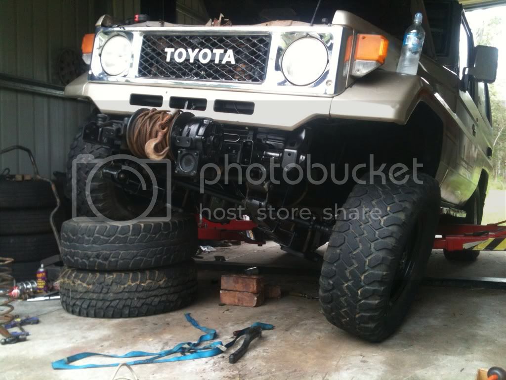

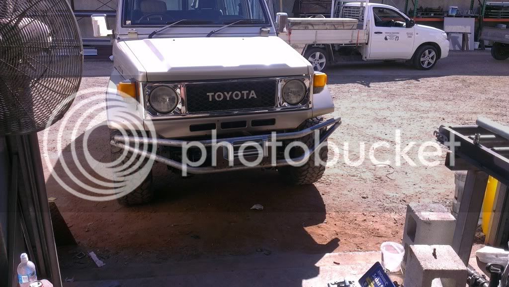

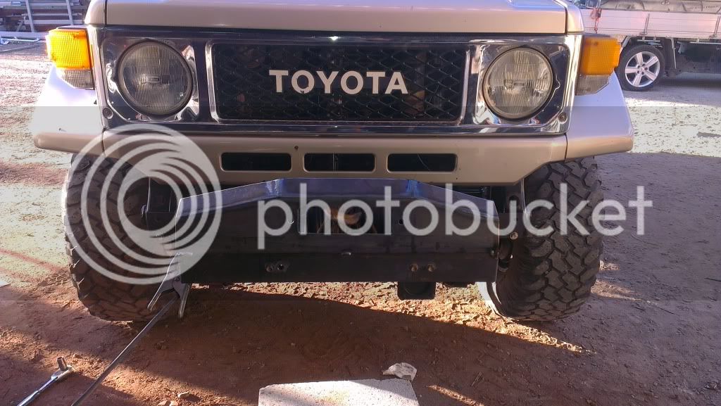

Ok so yesterday and today were spent on making a front bar to suit the PTO winch first off we started out with a simple tube bar that looked alright but as we mounted it we started to see how hard it was to get it straight, center and mounted securely
This is the first attempt which failed

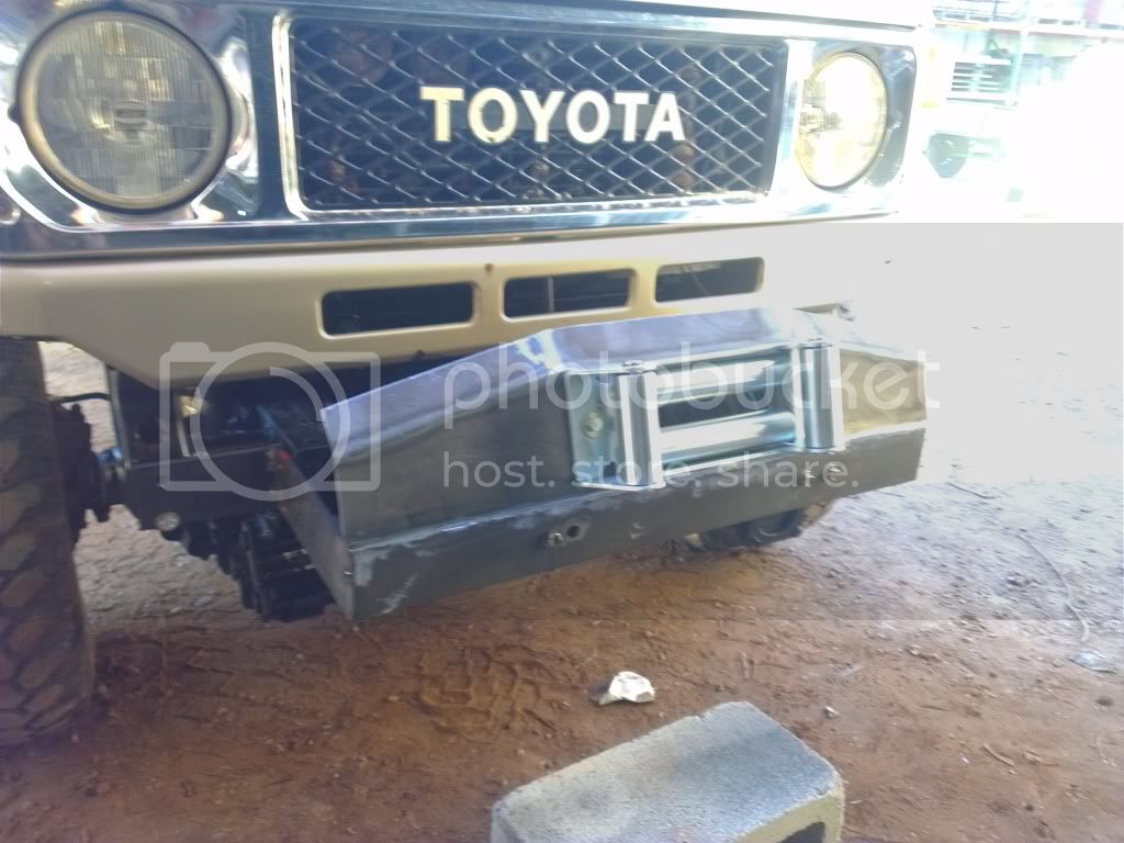

Then we went back to the drawing board and had a go at a plate bar
Pretty basic mounting just bolts onto the chassis with two bolts either side and bolts onto the front of the winch we made the bar so that it would give us as much approach angle we can get without removing the winch
That's all we got done we still have the sideS to work out what to do with them yet and then make rock sliders which may not be till next weekend

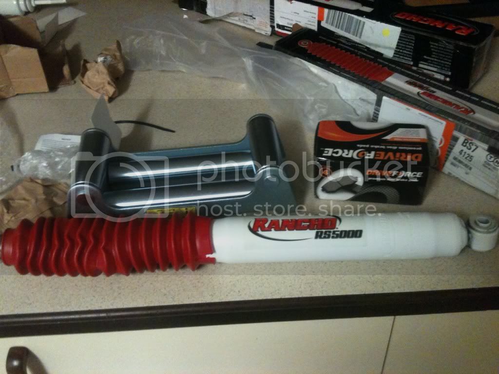

Rancho's :( why not go rebuildable shocks they save money - e.g. FOX, AMADA EXTREME, PROFIRMA etc.
The problem is you are not using enough,you need at least 20-25 to get the benefits of Ranchos
