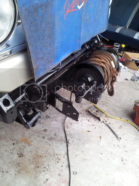

Yeah as BobBJ74 said its a pto winch activated by a lever in cab and the speed goes by what gear you select, Mines an Auto i dont know what the name of the box is.

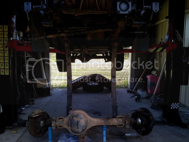

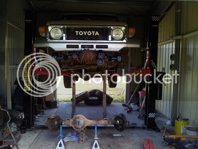

Yesterday we tidied up the front ready for the bar to be made, Gave it all coat of flat black.

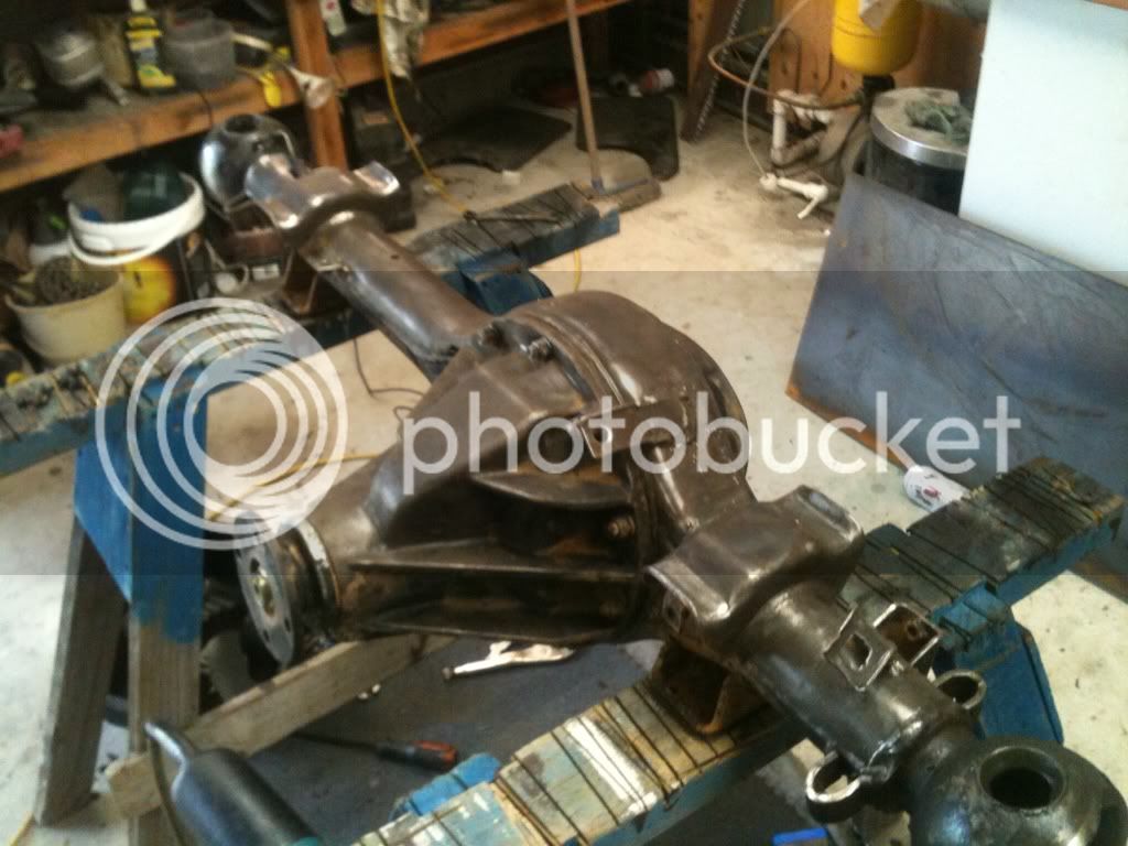

Then we dropped the diff out ready for the swivel hubs and bearings to be done today, We are also moving the diff forward 24mm, Removing the swaybar, Putting in the Efs lift springs and changing to Bilstein 5125 shocks with pin to eye adaptors. Heres some pics of yesterdays progress.

IMO keep the front swaybar you dont really loose flex and it makes the car much better offroad. Ditch the pin to eye adapters, they are a compromise and will limit your shock size and flex, put in new shock towers if you must use the billies.
im not going to throw the sway bar away ill see how it goes with and
without it an workout what i prefer more, the pin to eye adapters
were just an idea that my brother told me this is my first
fourwheeldrive so im learning im not sure as to what brand shocks
im going to stick in it.

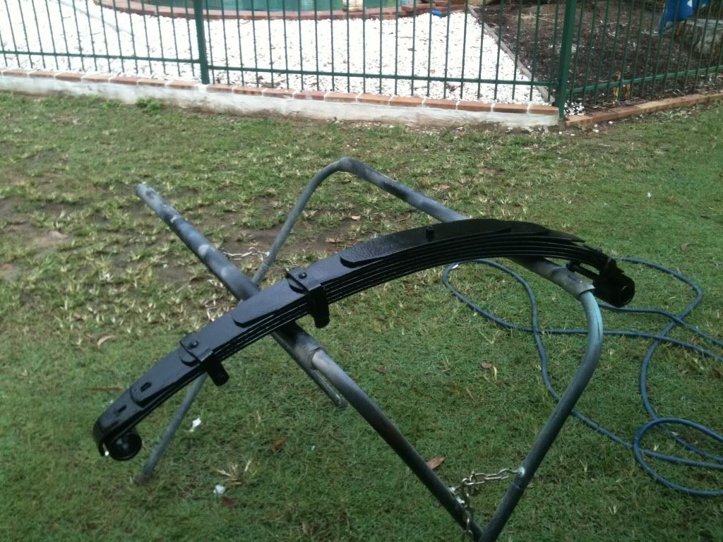

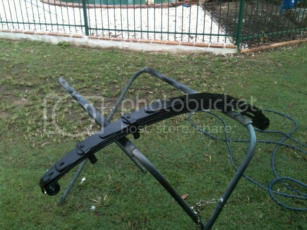

i cleaned up and painted the efs leaves and also stripped the diff ready for a wire wheel an some paint

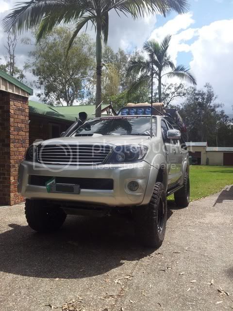

also this is pic of my brother thats helping mes hilux i plan on
making the cruiser bigger and better than this, he always has better
stuff than me so i have to make my cruiser more capable than this:D
http://i952.photobucket.com/albums/ae8/joshyarrow/hirrux.jpg

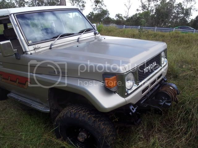

A pic of my old one in the same colour as yours before I swapped over to a black steel bullbar ;)

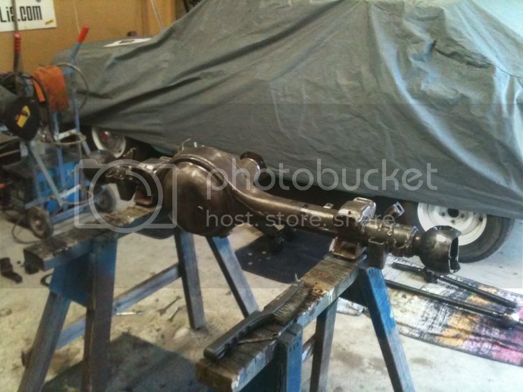

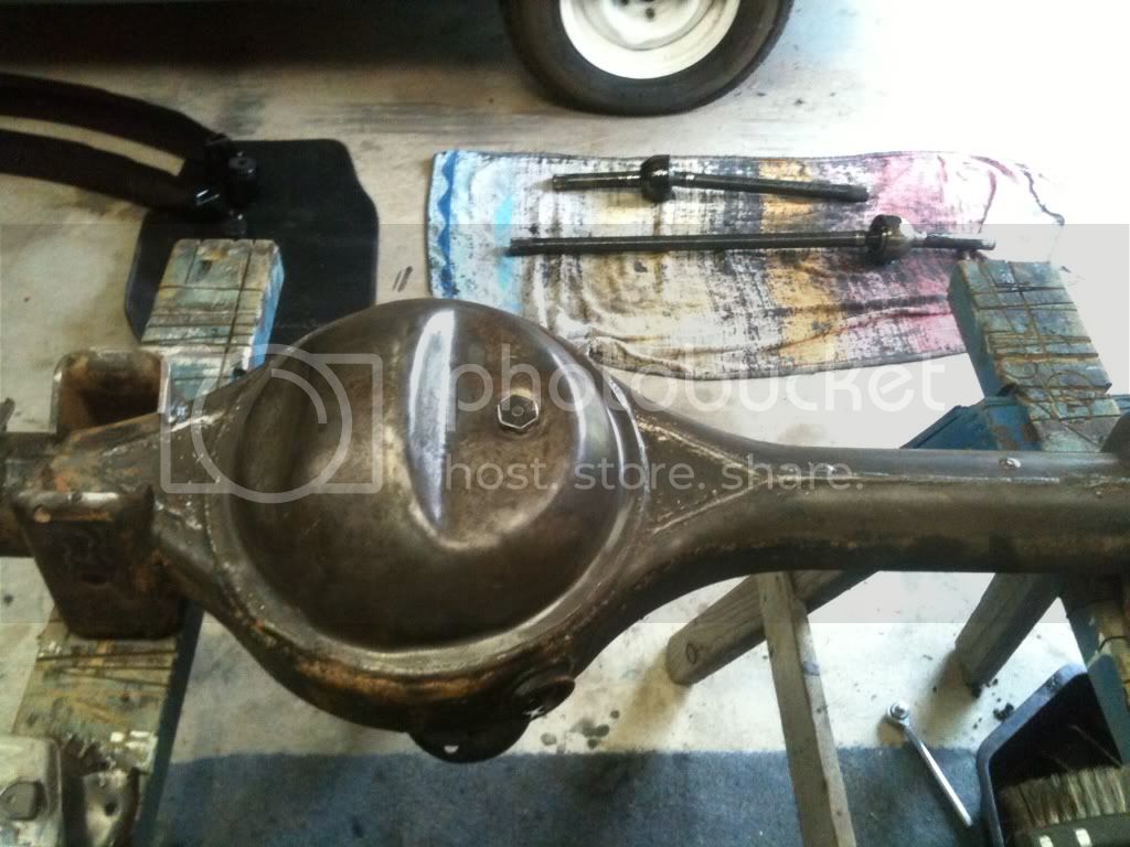

I gave the diff a quick wire wheel this arvo came up alright

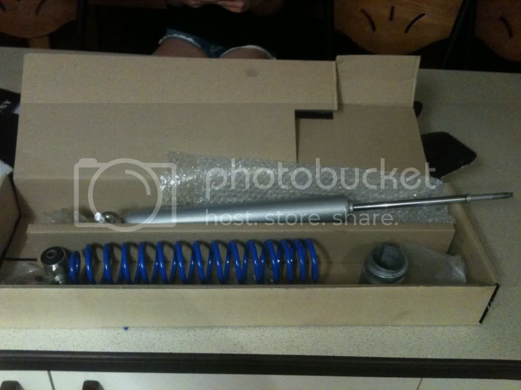

Also ordered a pair of rancho shocks for the front and new brake lines
I want to pull the diff center out and give it a clean but I'm afraid I'll go out an buy a locker if I open it up
Tomorrows plans are to paint the diff and clean all the parts and reassemble with the new hub seals and bearings and get the old steering dampener off an quickly wire wheel and paint the steering arms and front portion of the chassis and get the leaves half in ready for the diff to go back in

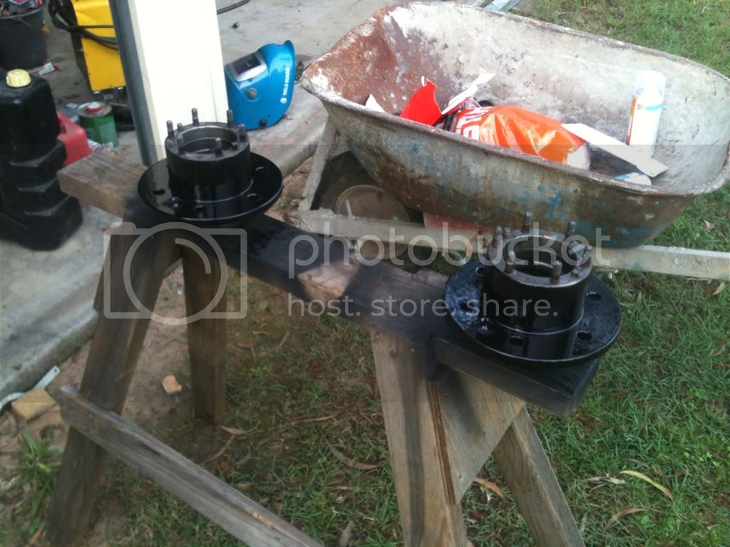

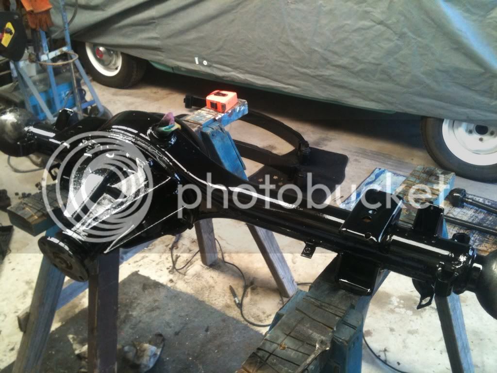

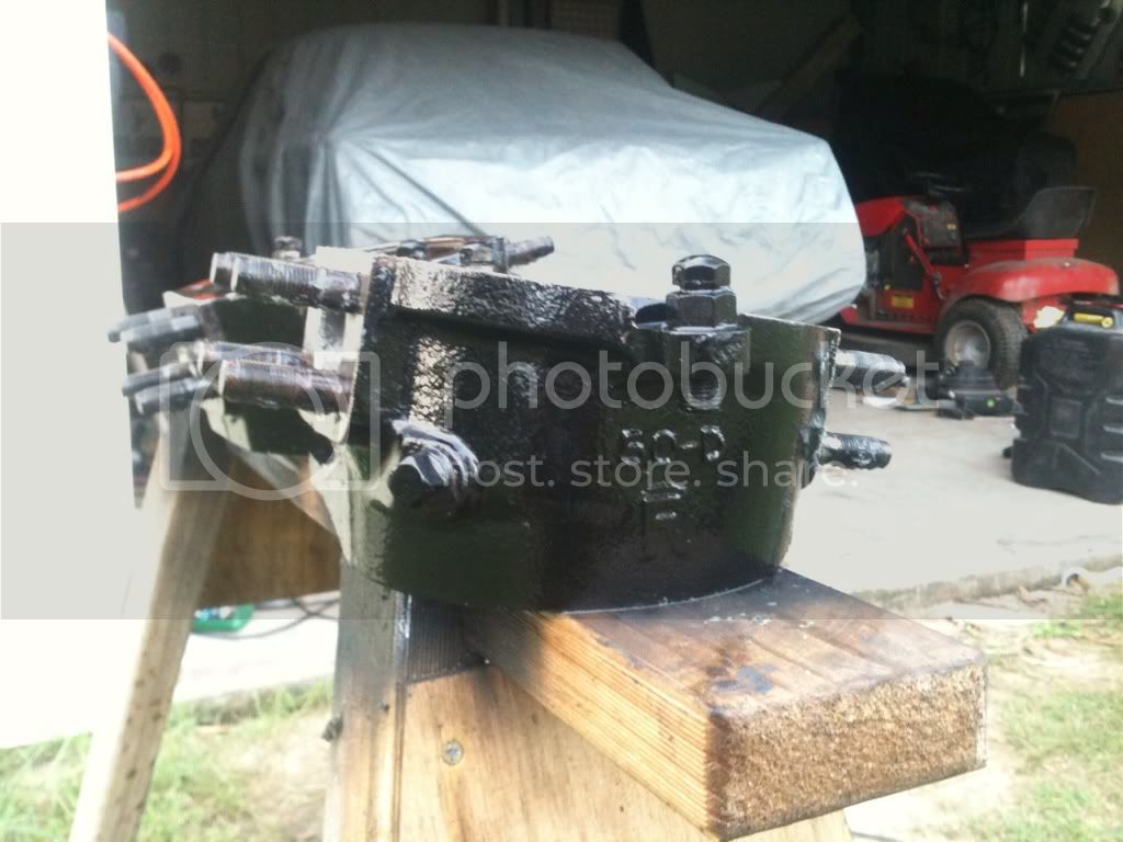

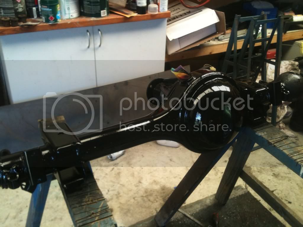

Did a heap of cleaning up today cleaned all the bits for the diff ready for Saturday to throw it all together and back in then move the cruiser to my work so I can start on the bar, rock sliders and rear bar an get the exhaust done

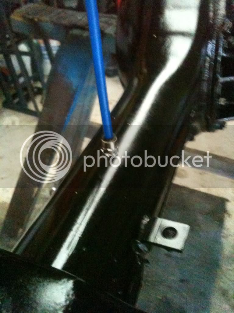

Anyway a few pics of the parts I've painted
And also got a fitting to go into the diff breather thread and am going to run the breather higher than the stock position
