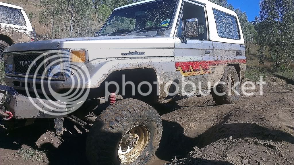

The suspension rides really well plenty of flex I don't think I lifted a wheel at all during the trip only thing that's a bit bad is the body roll around corners on road but it'll teach me to keep slow so I keep my licence.
..and was the EFS kit from Redcliffe Springs?
Nah we just bought bits an pieces from different places the front leaves we got from a wreckers for $150 and looked up the code on them and they were efs 3in comfort leaves then the front and rear shackles I bought off of an eBay store for $200 an we've just left the stock rear leaves in

Yeah I'm not too fussed over the beep just wanted to make sure it wasn't something bad I just turn the radio up went out wheeling today and I just can't say how much I love this thing fourwheeldriving the only thing that's been a problem is the diff hitting stiff an getting hooked up but other than that its awesome will post some pics later

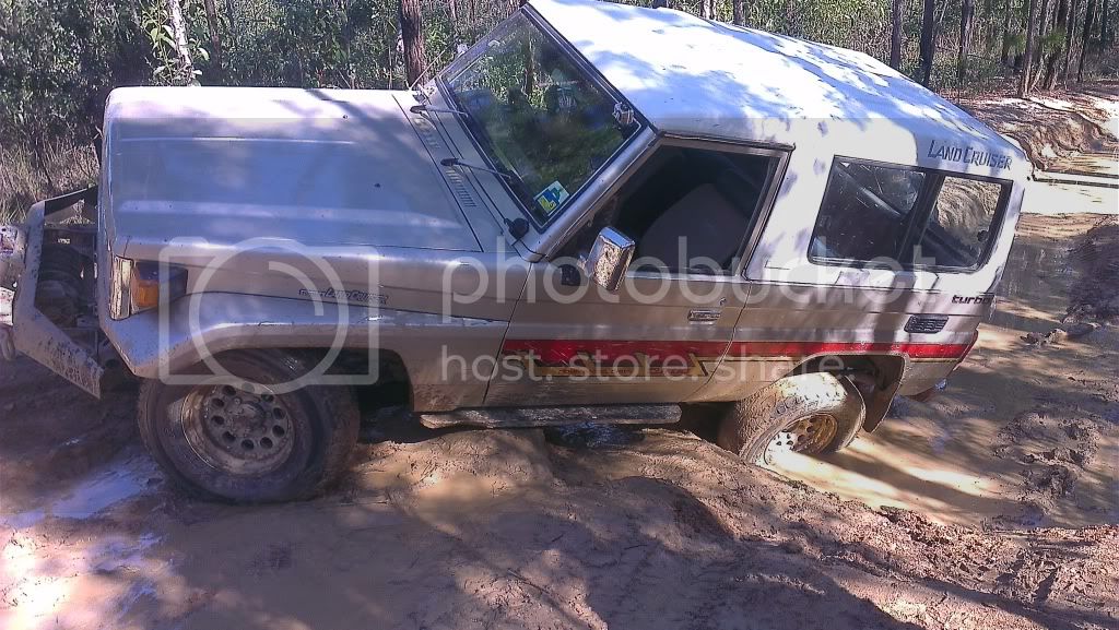

I couldn't believe how much the leaves inverted

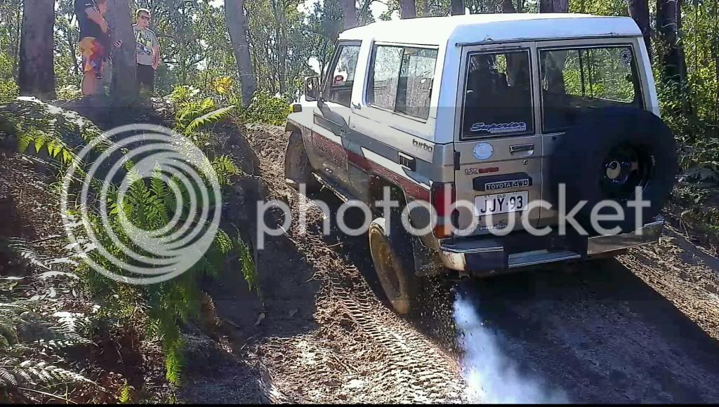

And I went down to a 4x4 park near beaudesert called cityview and was yet again surprised at what it got thru I didn't find anything it couldn't get up
The new wheels are perfect don't scrub anywhere except the inside of the rear wheel arches

Man that is incredible articulation. Do you run a front sway-bar?
I ended up doing Duck Creek Rd [did a write-up in Trails - Events - Expedition section] but I'm keen for Cityview after that vid. I have a 2" lift, 31's, LSD rear. Seen any trucks with a similar setup to mine getting through?
