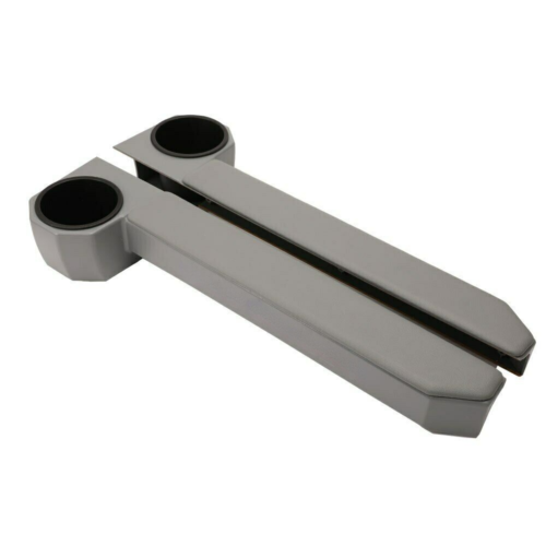

These are also available and seem to be in the US. Doesn't say if they have magnets or not, but does say that "Our this cup holder can be adhered to the car very well with adhesion promoter." :D
