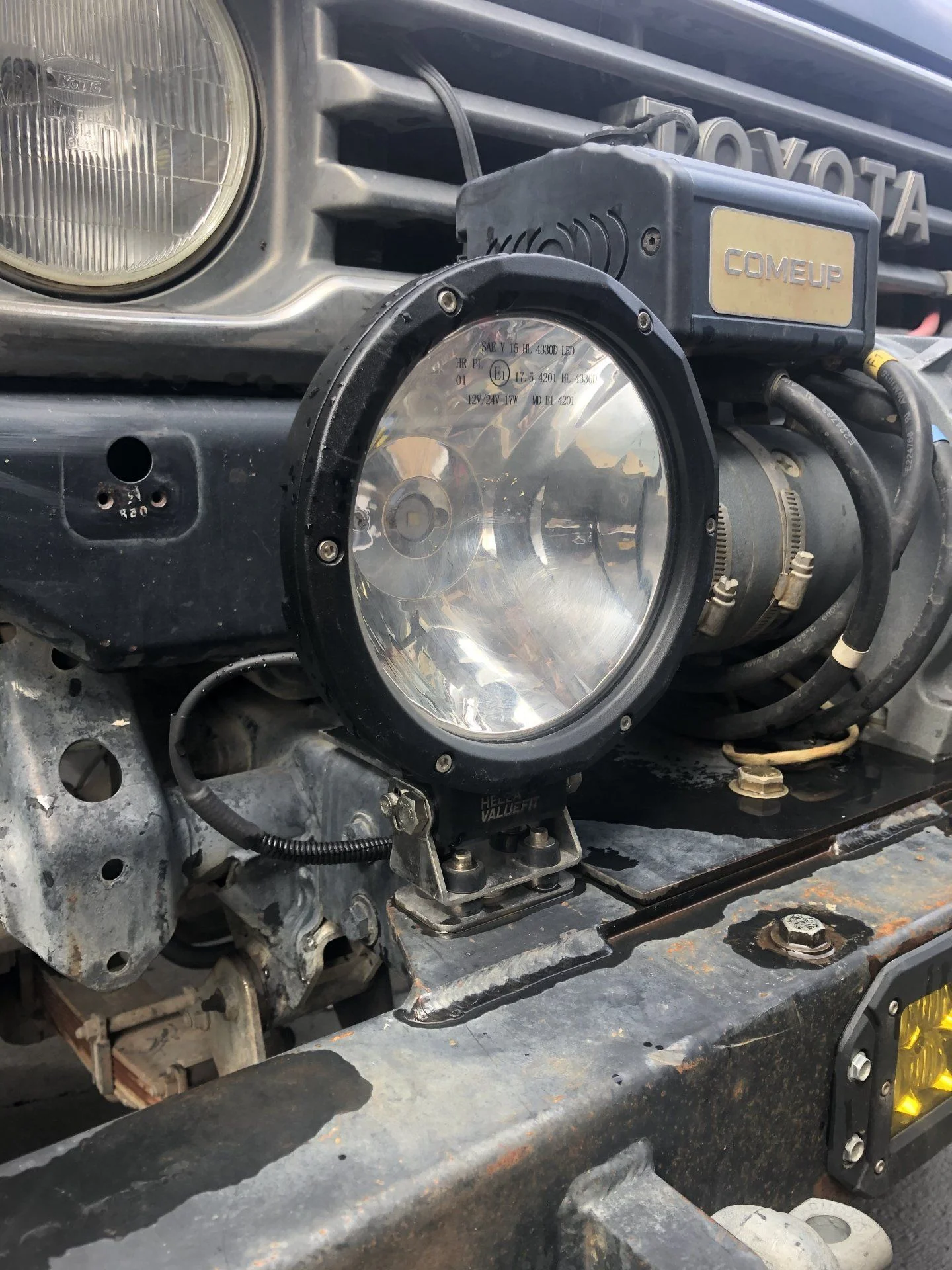

Oh yeah, if anyone wants reasonably priced LED off-road lights that work with 24V, the Hella Value Fit series are very good!! I have the 7” driving beams on.

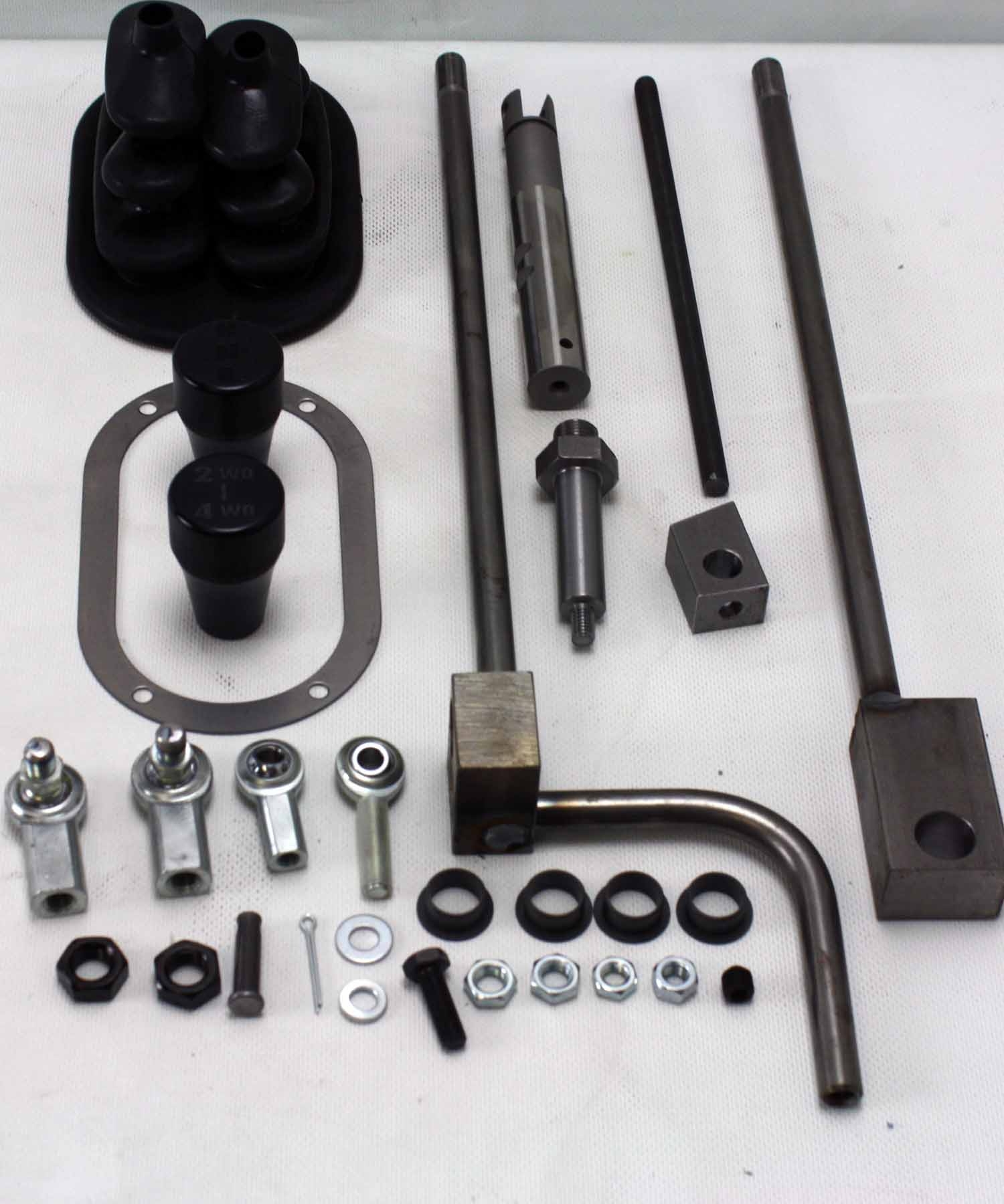

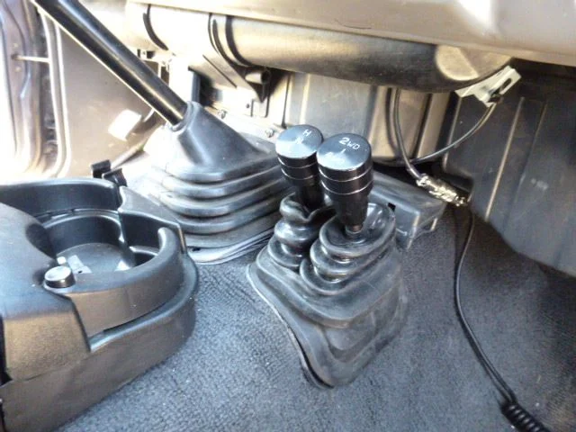

Could you please elaborate on the AA twin stick?
Juan

It eliminates the push-button/vacuum actuator for the transfer case shifting. allows independent selection of HI/LO or 2wd/4wd. I have too many problems with the stock system in the winter. it's going away

The above pic is a 60 series but you get the idea
Hello,
Thank you for the explanation. No switches, no vacuum, very reliable.
It reminds me of the Willys M29 set up.
Does it enable you to have L2, Low Range, 4x2?
Juan

Yeah, it will allow 2wd low range. I know lots of people don't have any issue with the stock setup, but it aggravates me.
