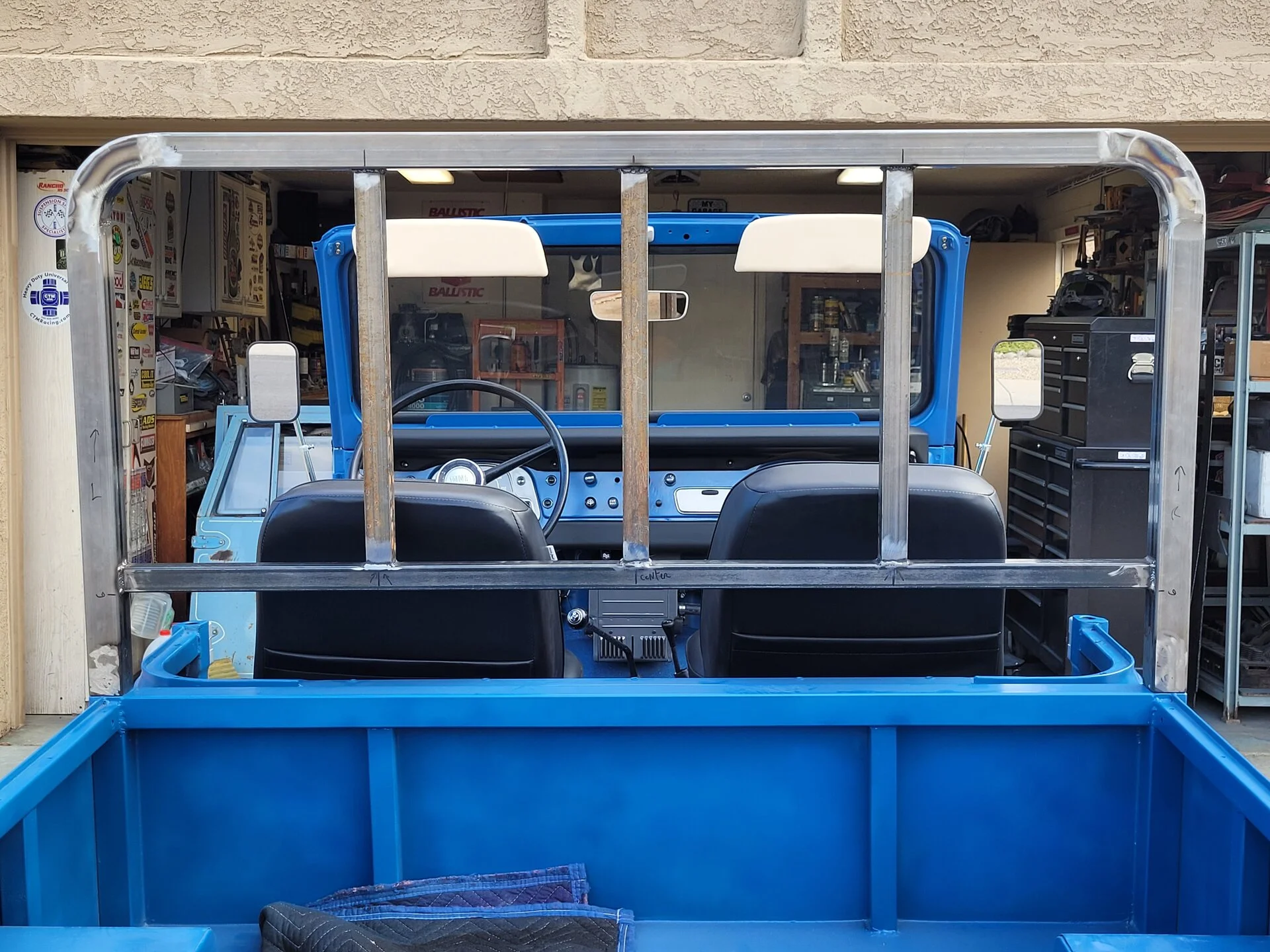

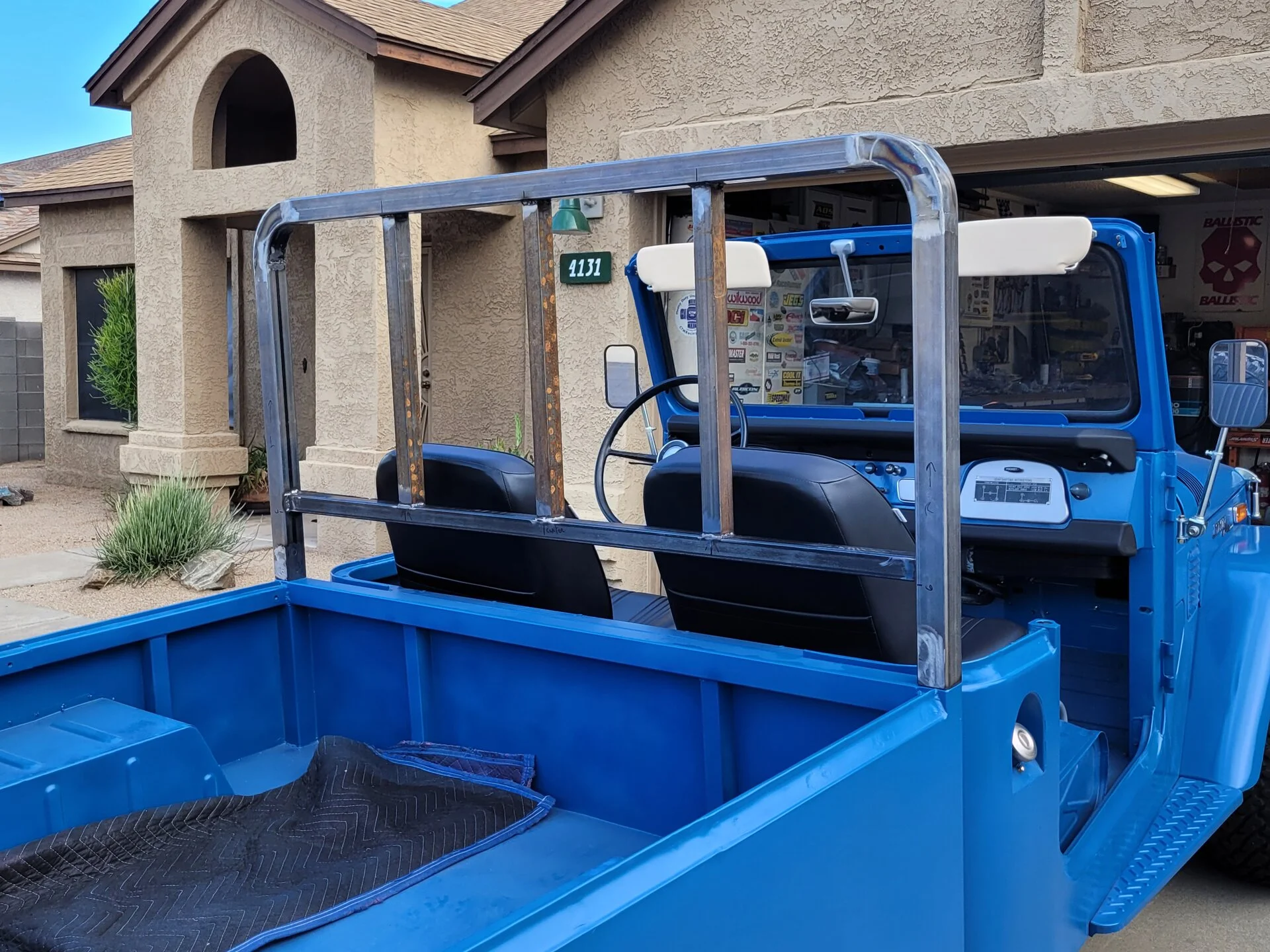

Building a headache rack for the fake 45. The fiberglass 40 roof cap is taller than a regular 45 roof. So, I had to make the rack a little taller. Honestly, I think it looks weird without the roof installed, but it will allow me to run a bikini top. I need some cover from the sun.
I cut out the flat corner curves, then capped the top and bottom. It was alot of welding and grinding but it turned out well. In hindsight, I should have made the radius a bit bigger.

I added some triangle shaped gussets to look more oem like. The bar has legs that slide into the bed corners and bolts go thru to the welded nuts to secure it.
Now it's time for a tiny bit of body filler to smooth out a few spots. Then get this rack painted.
