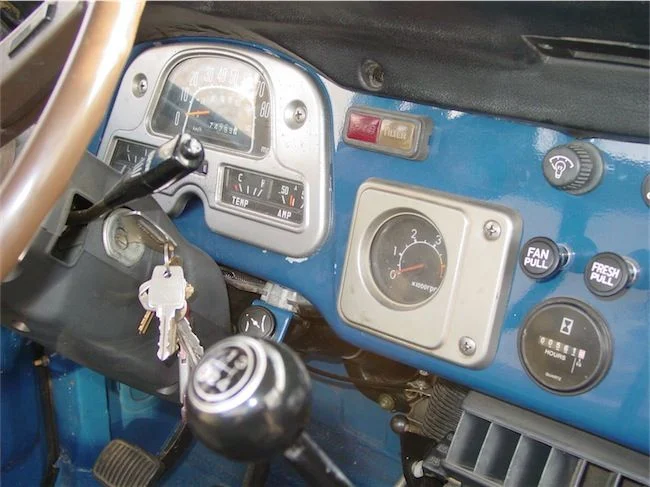

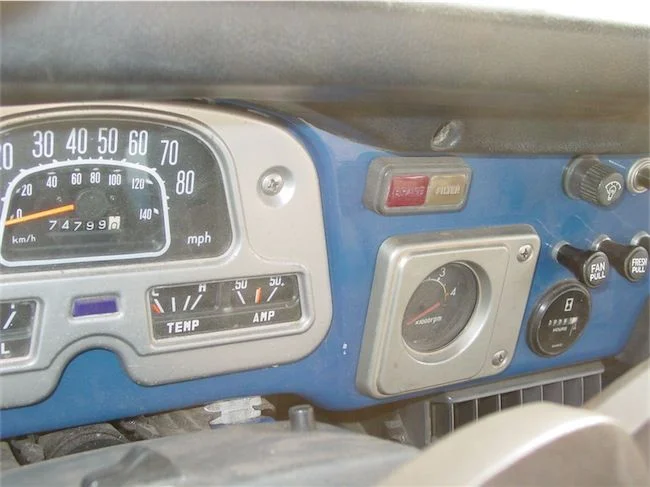

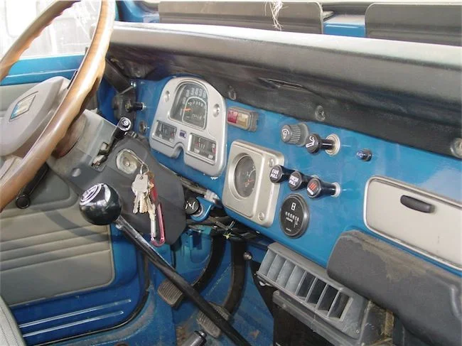

As promised, pictures of my tachometer installation in my dash. Can you see how I re-did the sheet metal around the right side of the steering column/combination meter opening?
You eliminated the "knee pads" to gain a little more gauge room :hhmm:
