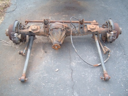

Dumb question - I see you're running an FZJ80 rear axle. I thought the rear FZJ80 axle has the diff offset towards the passenger's side?
But you're also running dual RF1A gear-driven transfer cases, which have the output flange centered down the middle driveline/chassis.
Are you just running your rear driveshaft at an angle toward the passenger's side? Does this cause any driveline vibration/issues?
Awesome build thread!
No issues, and my DS is relatively short due to the dual cases.
Yes, it’s offset, but only by a few inches. Similar angle compared “sideways” to the angle down off of the case to the diff. Does that makes sense?
Yessir, that makes sense. Thanks!
