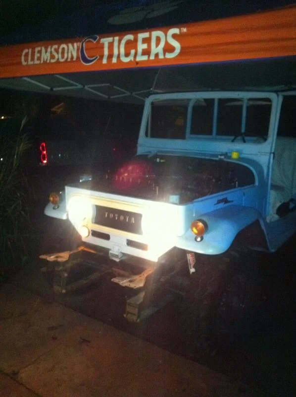

Let there be Light!!
Got a few things knocked off the list... fenders, bib, hood all reattached, but more importantly I have lights. Had to replace all the wiring as I was only getting 9.5volts at the headlights with the original wirring:doh: Ran all new 14 gauge wire cleaned all the switch terminals and I am now getting a healthy 12.5volts at the lights :beer:
