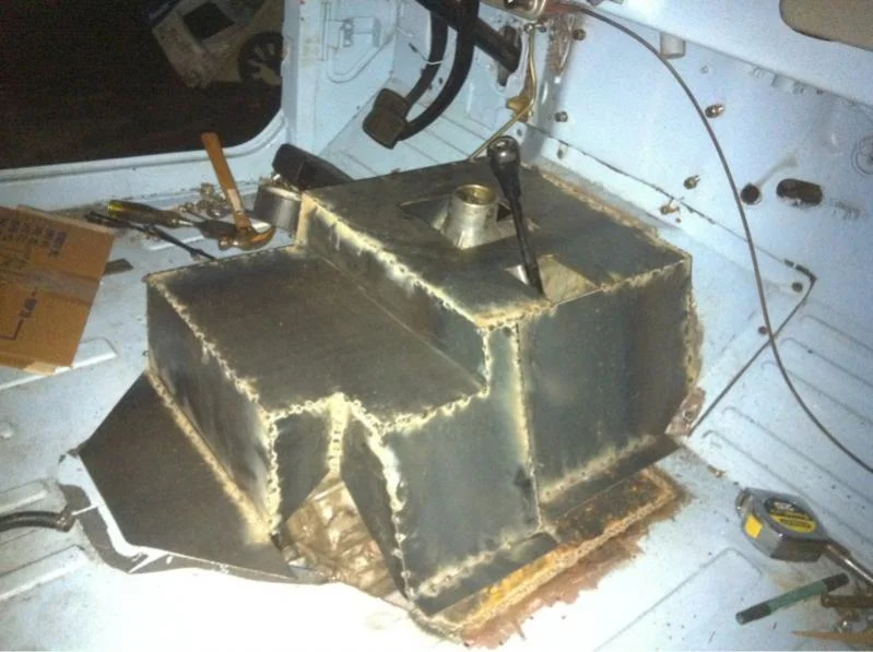

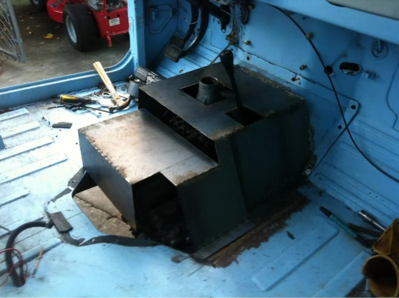

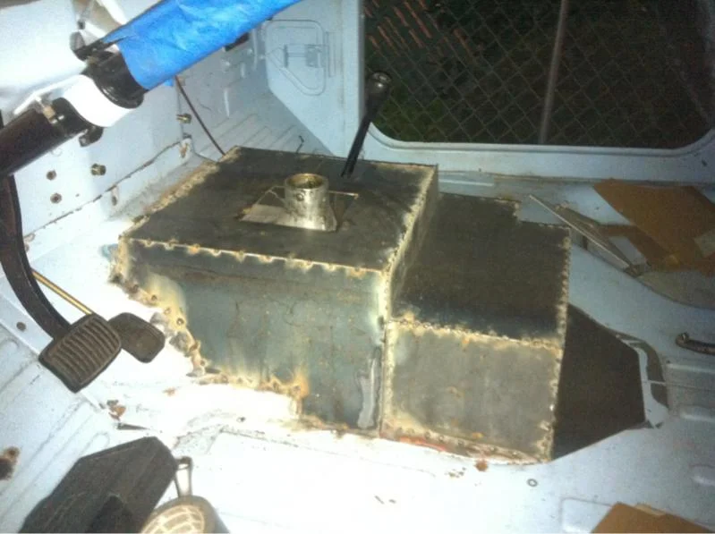

Well I now think I have more hours into the trans tunnel than the actual engine swap :doh: but I am finally done with it well except for final welding, sanding, paint, sound proofing , etc. :hillbilly:
It is very rectilinear in appearance which contrasts nicely to the more subtle lines on the 45 :rolleyes:
Box Box Box but real nice Box "rectilinear in appearance " LMAO only a designer would use that term Great!!!!
By the way great job maybe you and Marshall won't have to ride the mini after all.
:grinpimp: thanks Doc, I really wish I had the proper fab. tool to produce some smooth lines, but with only an angle grinder and a cheap lowes welder my endeavors are limited :o I know to you guys it has to look so simple but it is amazing how much time it has taken, so many clearance issues, it is much more complicated than it appears.....
but like Marshall said it aint got to be pretty just functional :beer:
On v.2.0, radius all your corners and hammer them down to meet in the middle. Then cap them with a circular piece that has been cupped. Weld and grind to desired finish. I know you didn't have time this go around, but just tossing ideas out there for the re-rebuild after R.A.T..

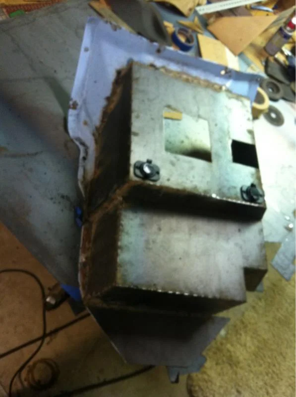

Are you going to paint a helicopter landing pad on that thing...that thing is so big you could land a Huey on there....and why don't you weld on two cup holders so when your sweetin your nuts off out west you'll have somewhere to put your frosty beverage
Lol it has to be that big to clear the H55 and split case.... They dwarf the original 3spd :doh:

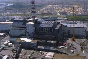

I was struck by the beauty of the work, but thought it looked familar..... then I figured it out.
The chernobyl sarcophagus?
oh man.... ouch ouch, that stings LOL great stuff!!
