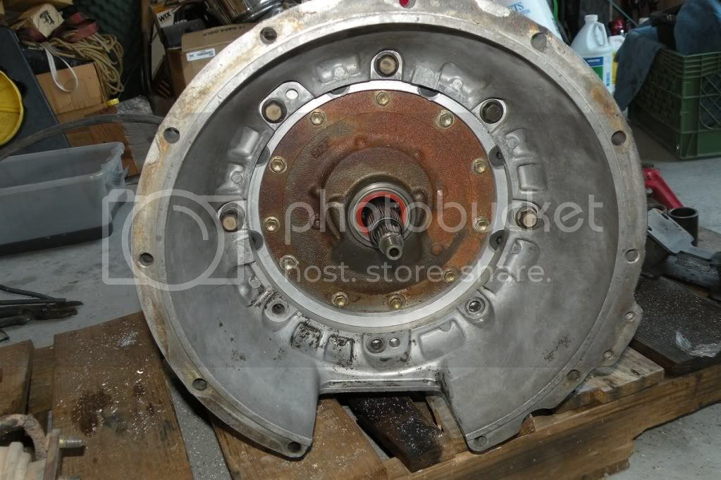

First of all let me state that I have personally never seen an actual 6HE1 let alone had a chance to compare one with a 4HE1 so all that follows is pure speculation.
I believe that the 6HE1's with the starter mounted forward of the flywheel probably had flywheel housings with an SAE transmission pattern as is typical of heavy duty applications. I would also assume that Allison truck\bus transmissions also have the SAE pattern. I know that 6HE1's were available with Allison transmissions. I don't know which ones. So, if you could switch a flywheel housing from a 6HE1 to a 4HE1 then you would be able to use the Allisons and any other transmission that has the SAE bolt pattern. As to whether you could actually swap a 6HE1 flywheel housing on to a 4HE1, I don't know but my guess is that it would be possible. To research the compatibility further, I would start comparing part numbers for the various gears and other components that are housed in the flywheel housing. If you decide to try it, be sure to post your results here!
Regarding which transmission would be best for your application, I don't have any idea as I'm not familiar with the characteristics of the various automatic transmission that are available. Maybe other forum members can offer some suggestions.

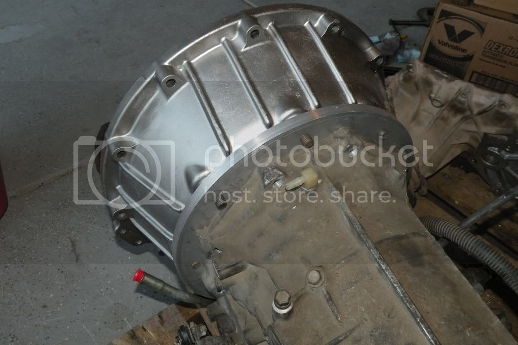

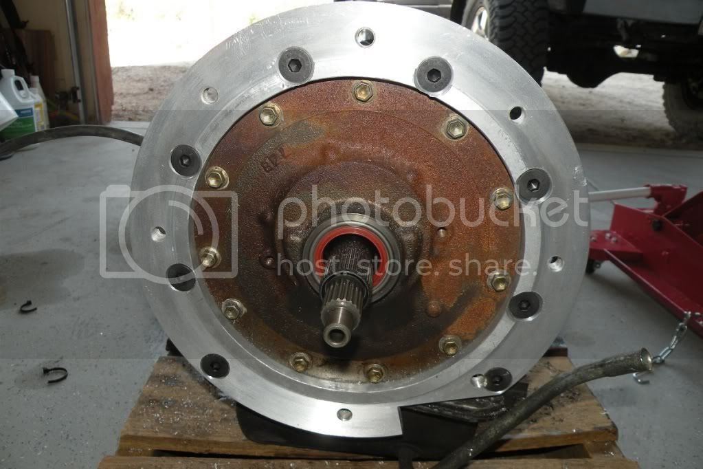

That is great approach! As there seems to be an abundance of JR403E bellhousings, your approach will provide a very slick solution for those who want to run a stock automatic behind the 4BD1/2 diesels. Also, the JR403E was used behind some earlier Mitsubishi diesels and possibly other cab forward trucks so you could be opening a whole new set of swap possibilities.
Agreed! I have a very similar adaptor between my Nissan VH45DE bellhousing an a GM TH400 transmission.
I would be curious to see one of these plates to mate this bell (or a Aisin Bell) to a NV4500.
