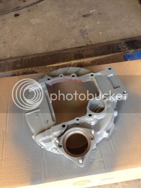

Also painted the flywheel housing.

Look at that, you've got one of those 2 bolt flywheel housings with the 3 bolt starter adapter fitted.
First time I've seen a picture of one.
Yeah I think all the 4BD1T/2T's had them here, I mistakenly bought an extra thinking it was a ball housing and it was the same. It was off a 5spd 1T.
I thought most were one piece cast 3 bolt. The adapters are the rare ones.
Interestingly you can get 24v compact 2 bolt starters, but not 12v. The three bolt housings were used in 12v markets.
My oldest 4BD1 also has the adapter. The newer 4BD1 and the 4BD2 do not have the separate adapters. Good eye Dougal!

On a side note, both my 89' and 90' engine don't have that starter adapter like yours. That's pretty cool, never seen one.

Interesting I had no idea there was a difference. I had another one by mistake and sold it but did not think to check, thought they where all the same. Does this mean there is a nice 2 bolt low profile starter that i can fit? Lol
