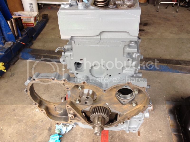

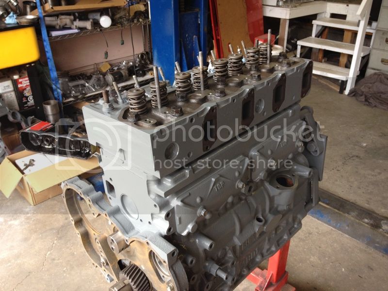

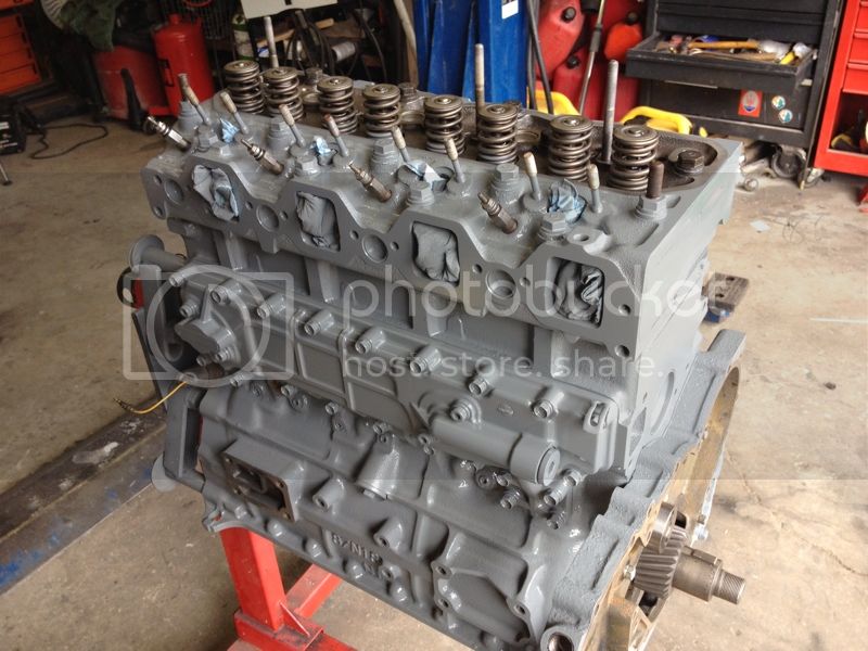

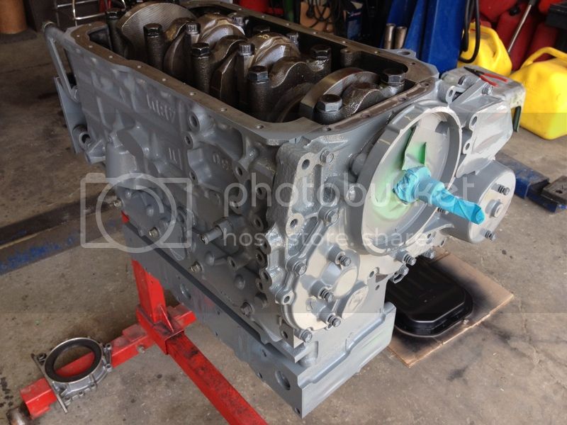

So with the lifters a few days away I moved onto to the important tasks, cleaning and painting parts. I spent about 2 hours masking off the head, block and cast timing cover. Then painted it all, the 2nd time for the block now. The paint went on just as well as the first time, really like this paint.
As soon as the lifters come in I plan to get the valve train back in place and adjusted. Once that is done the engine will be sealed up.

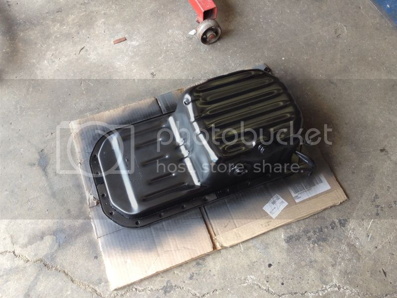

Oil pan ready to go.
