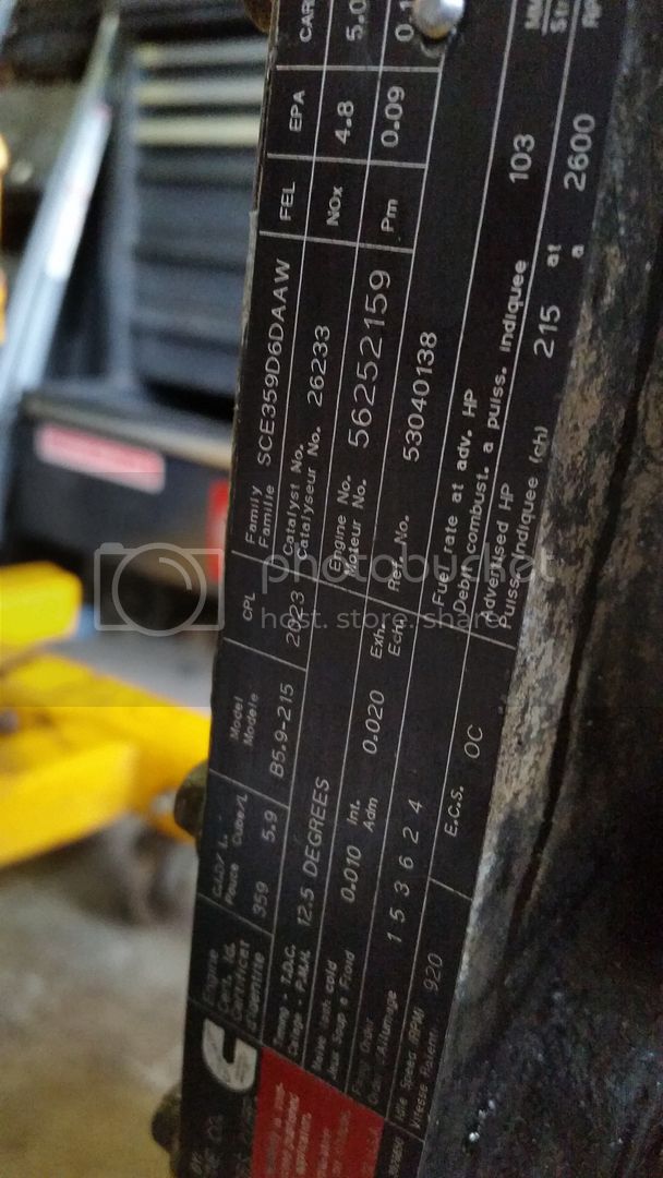

This just landed in my garage....
200k kms (120k miles) was sitting in the guys barn for 10 years but he stored it correctly. Had a Polaroid (lol) of the truck it came out of and millage for conformation. Also fogged all the cylinders when he sorted it and sealed up all the block openings. We fired it up yesterday with some fresh oil and filter, hit off first crank.
Apparently this CPL is desirable for the higher HP rating?

Don't think so? I was thinking a 3k kit would be a nice improvement, just to move the defule up a bit. I have not done a lot of research on fuel plates yet. I do not think I would grind my stock one. Mainly becouse I would want the ability to go back to stock.
I also plan to just keep the stock turbo and do not want to run it smoky and hot.
97/early98 is the best year and a half for the mechanical 6BT. Awesome!
