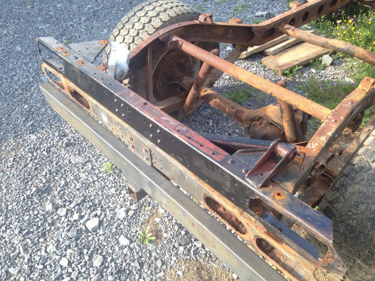

Well thanks to @moosecruiser for the mudship, y mil gracias a mi nuevo amigo @dr_dobro my new rear frame section is here!
Wow! What a difference in metal thickness! My old shackle mounting gussets and corner frames were paper thin (or less!) compared to this! (And sooo nice to be back to OEM tail light shape!)
Getting closer!

-brand spankin new frame sections for the last ~12" of frame.

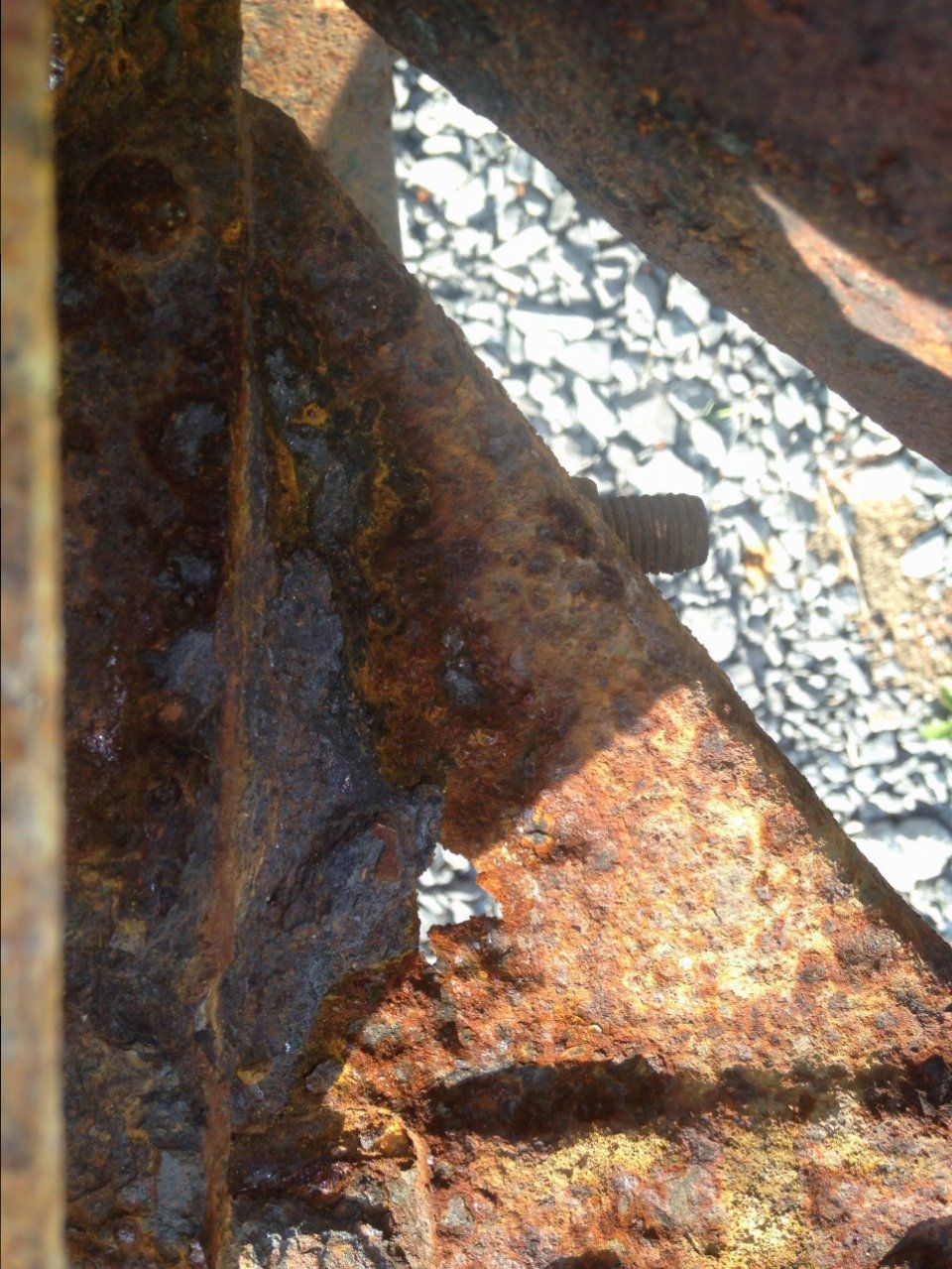

Still not diesel swap related, but working on healing the extraction scars of my new rear frame section. Going good- almost done repairing the holes. Re-welded the attached shackle mount sides and one rivet head. Just a few more holes to patch, and one shackle hanger to install then I'll be ready to fit this puppy to the new frame sections, then chop the old ends off and weld the new on! Getting close to painting time!
One shot of some close ups:
And a few other areas....

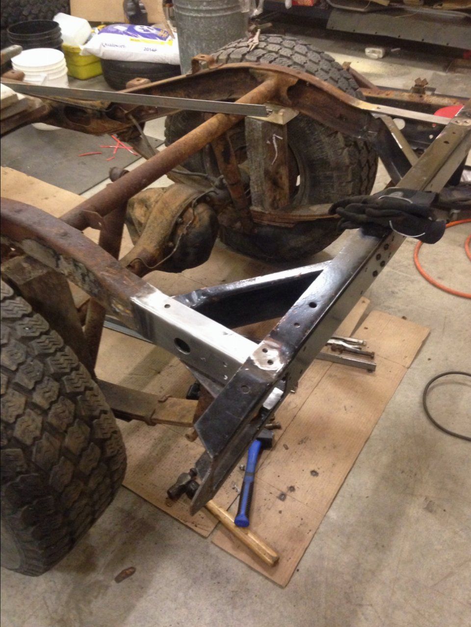

Yeah, I was a little surprised that the replacement part was a square cut. I plan on lapping another plate over the side after I have welded this on, and technically the weld (when done properly) should be stronger than the material beside it.
Considering the fact that this whole rear end will be 100 times stronger than the perforated rusty mess that was on there before, I'm happy!
Welded back together! Just have to do the overhead welds on the bottom of the frame, and the underside of the top. Then add my doubler plate and gusset/aux tank mount... Happy with how it has come out so far...

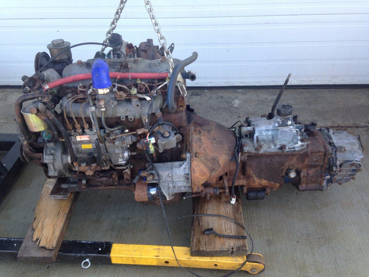

Finally got everything lined up, disconnected and yanked it apart!
My friend Paul came over with perfect timing just as I was starting the extraction.
Worked nicely, lowered the back end of the tranny on a floor jack after lifting the engine a little with the cherry picker. Didn't have to take off the starter or oil filter, just the exhaust down pipe after the turbo. Though it hangs on quite an angle it is nicely balanced!
Each time we lifted a little, or lowered the rear a little, we rolled the truck back. Got 90% of the way out without moving the cherry picker. (Ran out of space behind the truck!)
Needs about 10 pressure washing/degreasing rounds, but it's under there!

Well, 5 applications of castrol superclean and brush, and hot water pressure washing, the greasy old 3B is getting closer to clean!
Before and current (not done yet!)

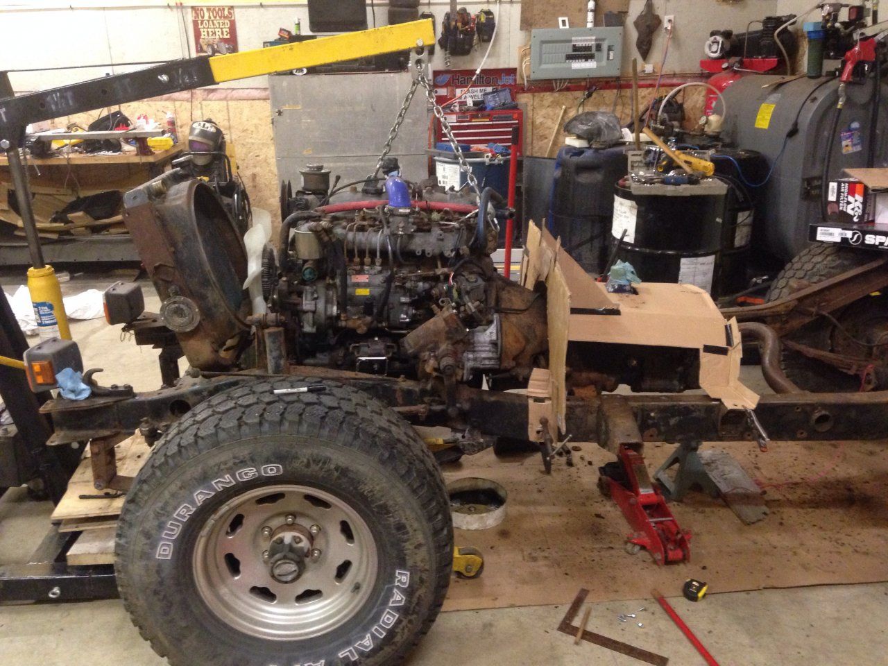

Got the old engine and tranny mounts off the frame. Ground the rivet heads flush, then hammer and punch to get them out the rest of the way. Couldnt resist a test fit, but I couldn't get it far enough back without pulling the bumper off.... And ran out of time.
A lot less room between the frame rails on a 40! It's going to be a tight squeeze!

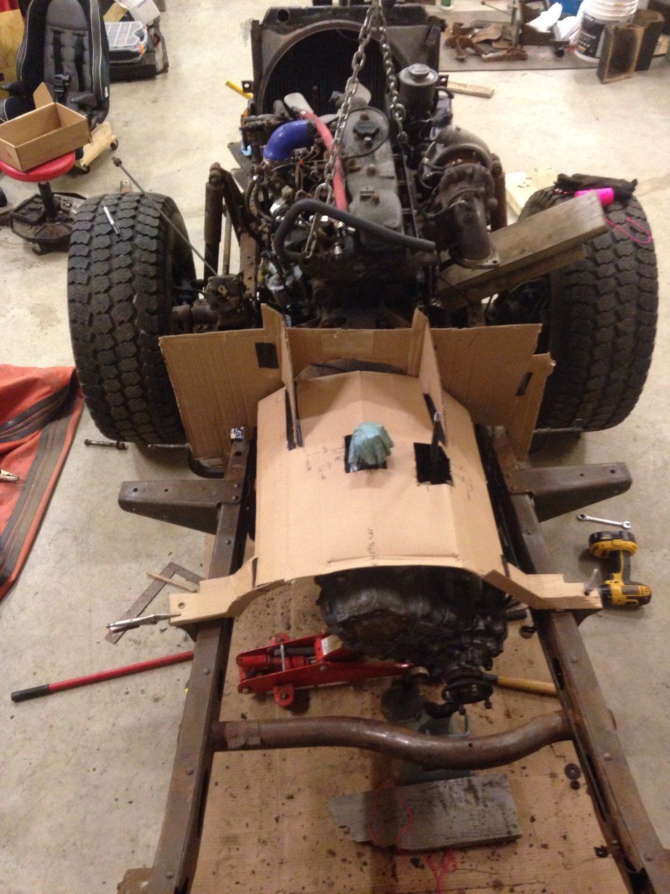

Anyone know any of the dimensions from the front for the mounting brackets? Plan is to line up the shifters with the body, but some guidelines would be handy! (Width is ok as it's set by the mounts I got from Awl_Teq)
Started working on fitting the trans cross member tonight, seems to be lined up.... Still need to massage the actual crossmember to the brackets. Anyone have some measurements to a fixed point side to side (not that anyone views this thread but me), or am I good so long as the output flanges are in line? (They are as it sits now)
I stalk this thread so you're not alone, but with no professional education on this I'm just guessing but surely the uni joints on the tail shaft will not be too worried as that's what they are for, to work on angles, so if it's close it should be good enough? I'd be happy with it, but again it's just a guess but to me the pic looks fine

Tonka8110 yes, but they are generally designed to run either with parallel flanges, or "broken back" in one direction. Work in others just don't live as long. I'm not so concerned with that as getting the shifter to come up in the right place, but I think I'm pretty close, as my template seems to be close.
Kling-on - would be great if you could get me a measurement of the length of the passenger side engine mount (on the engine block). I think mine is too long...
I found the measurements I took of the old shafts, before I yanked the 2F out and my string line matches up with where the output flanges were so I think I'm OK.
I temporarily mounted the trans cross member mounts with some lag screws to see where things landed. So far seems OK but I might shift things back about 1/4" more, would give a little more clearance for my transfer case shifter (according to the cardboard body template I made)
For now at least, it's resting on the tranny cross member and the drivers side engine mount is clamped in place. Pretty sure the steering and starter are going to have an argument when I put the drivers side mount in place - it needs to go up about 2" to fit, and the space by the starter is minimal already. (I was half expecting this but hoping it wouldn't be an issue)
