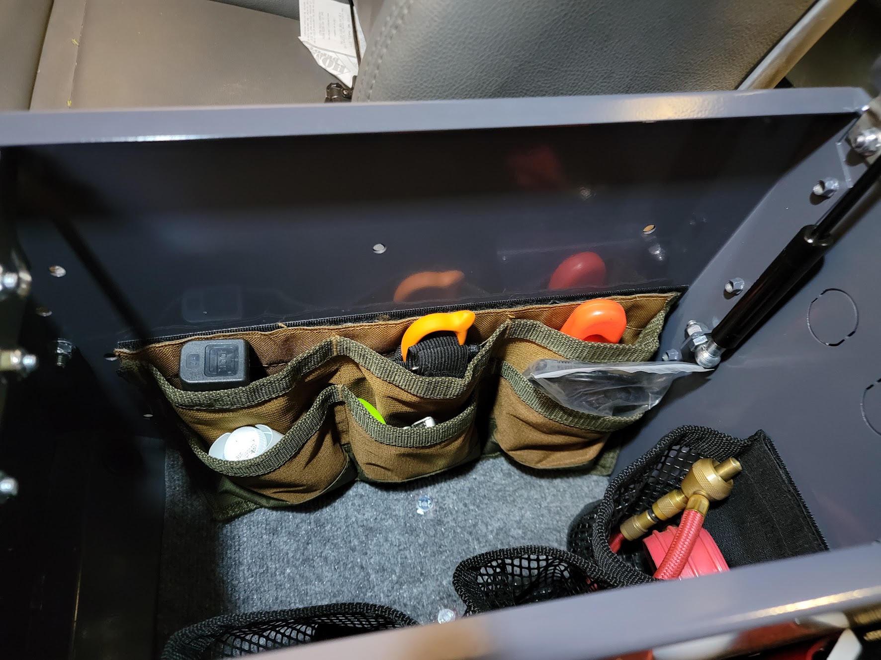

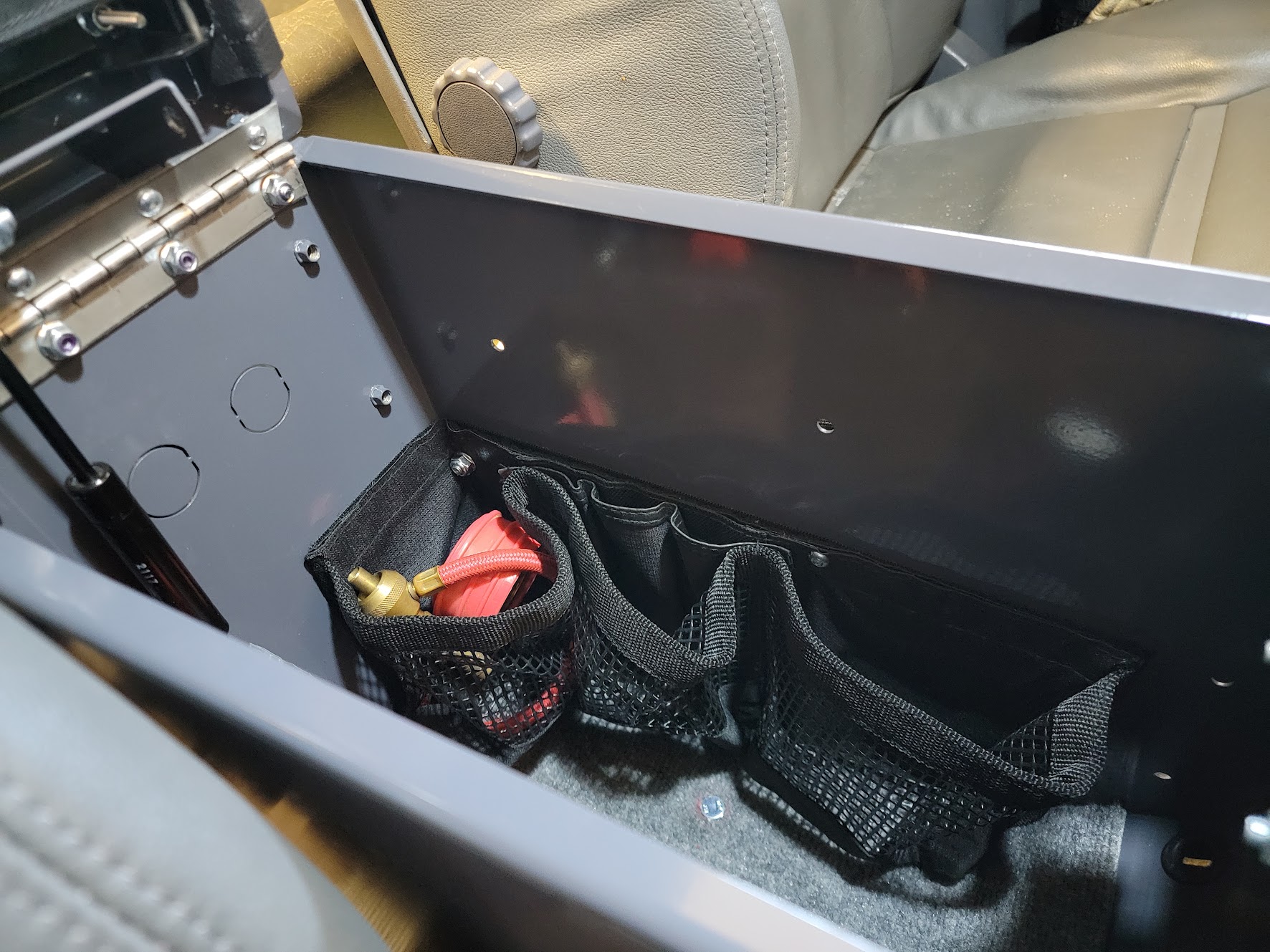

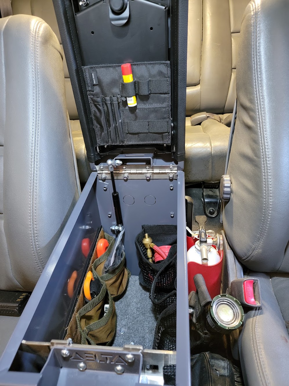

Just got mine, so planning more in the future, but my quicky solution was:
- Marine carpet lining the bottom
- Cut up some "Bucket Boss" five gallon bucket organizers and attached various panels to inside perimeter using 2" heavy duty Velcro
- Blackhawk pen organizer to underside of lid with Velcro
- Home-made kydex sleeve for fire extinguisher and flashlight holder attached to outside
Very cool!
