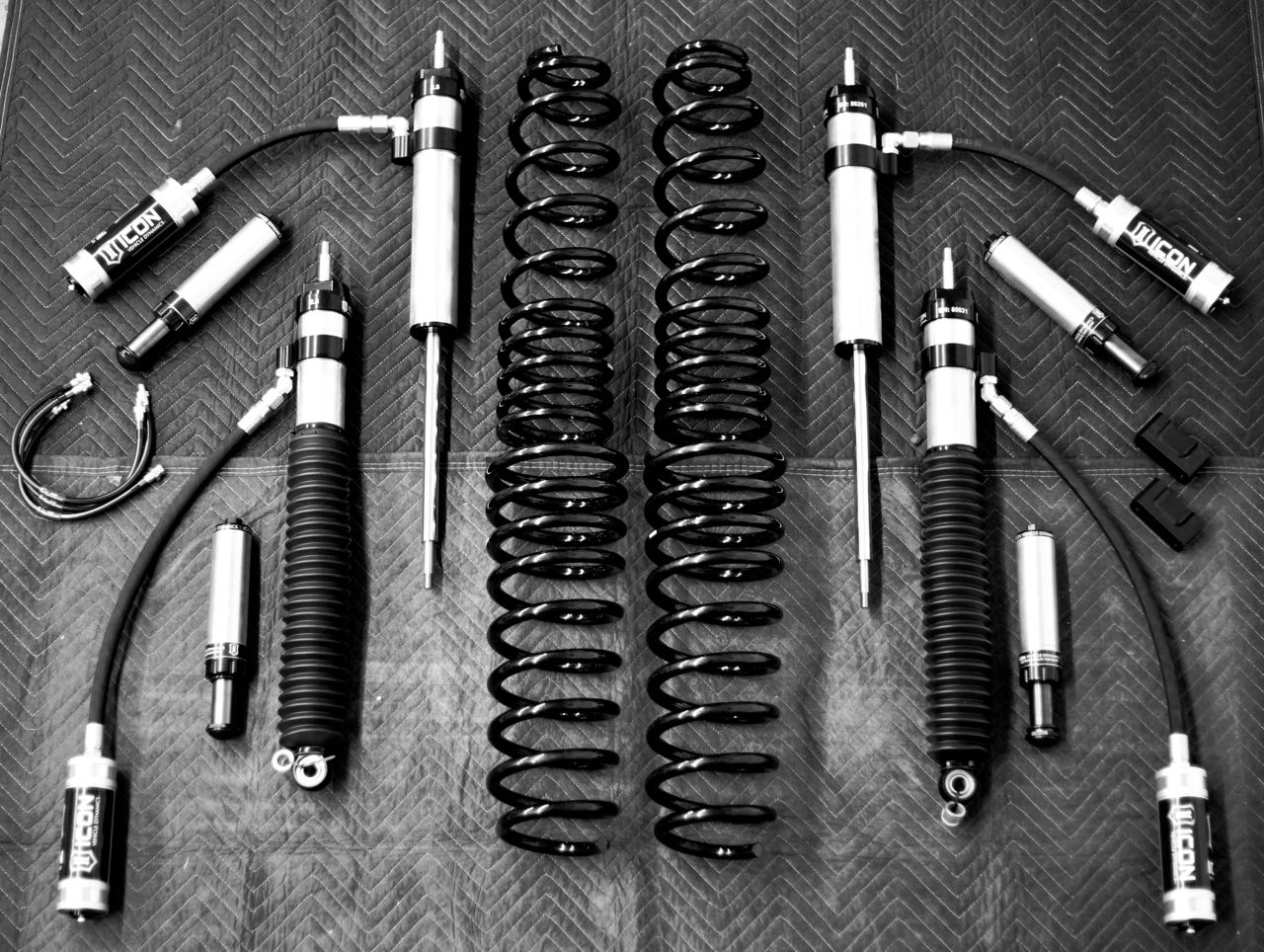

DVS front 1" spring spacer with integrated bump can holder (for ICON bump cans)

ICON 3" lift kit (custom powerd coated springs with DVS brand color) with reservoir shocks (became ICON dealers because of this build)

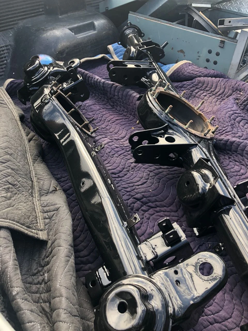

Complete teardown of chassis, powdercoat each component individually (included axles and suspension components)

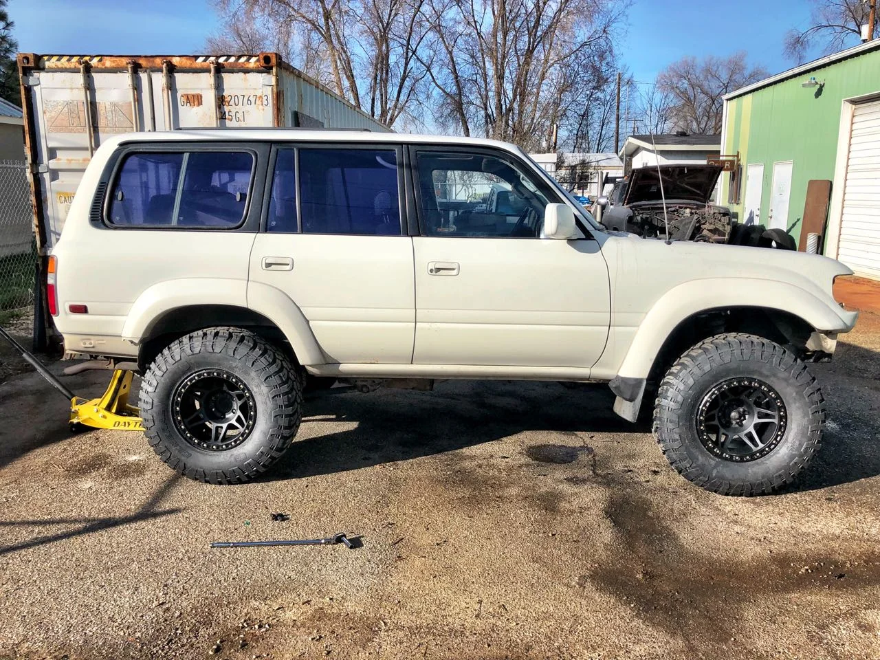

This FJ thing is turning into a problem...the white one is the one about to be transformed

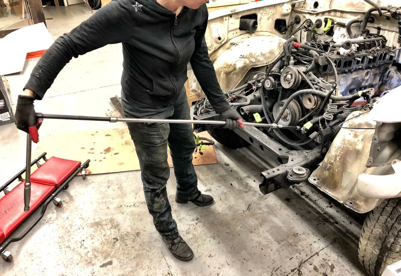

Jen diving into the teardown. She was pretty stoked to put EVERY extension in the shop to use at one time.
Doing a test fit of tires and wheels to make sure they at least MIGHT work.

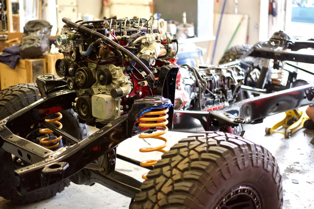

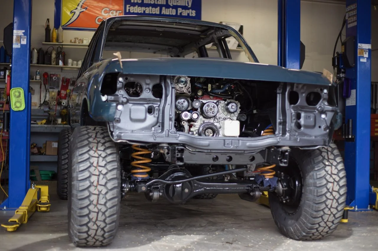

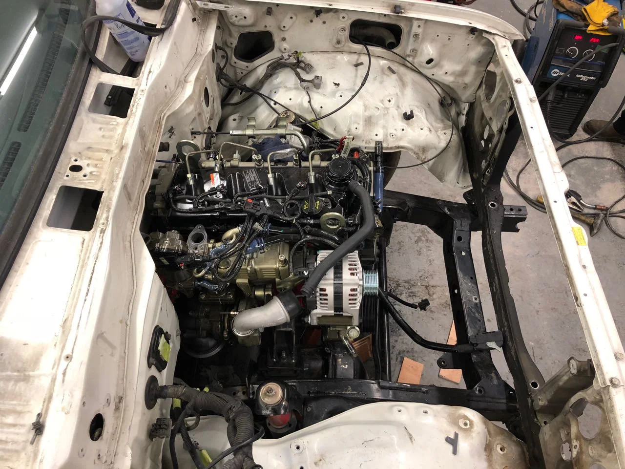

Getting motor mounts figured out before tearing it completely apart.
Once motor mounts are figured out, we can disentangle the body/chassis system.

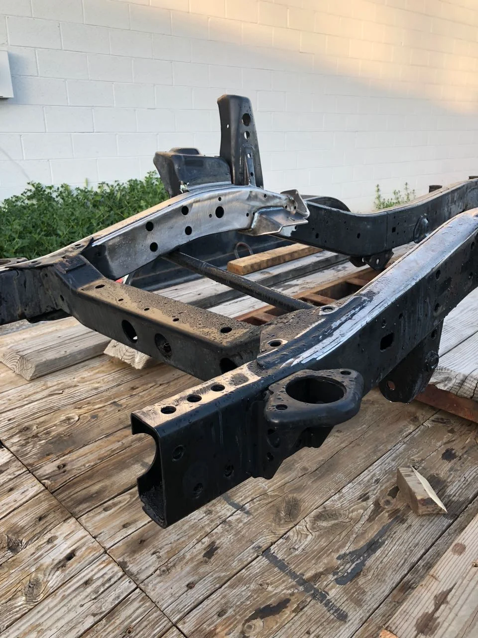

Chassis post extraction, waiting for body to leave the shop for paint so it has room to get torn down.

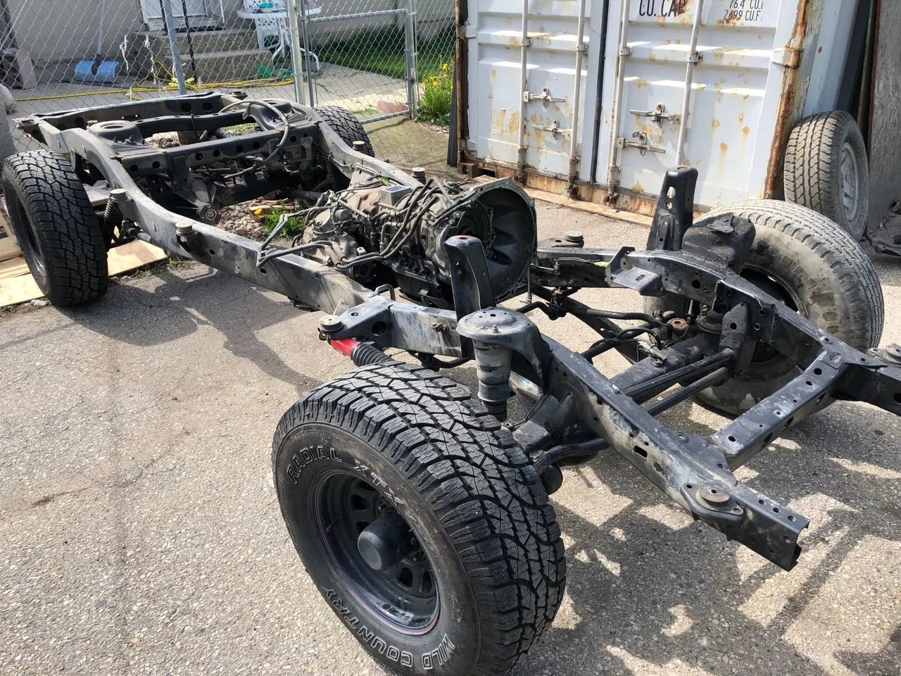

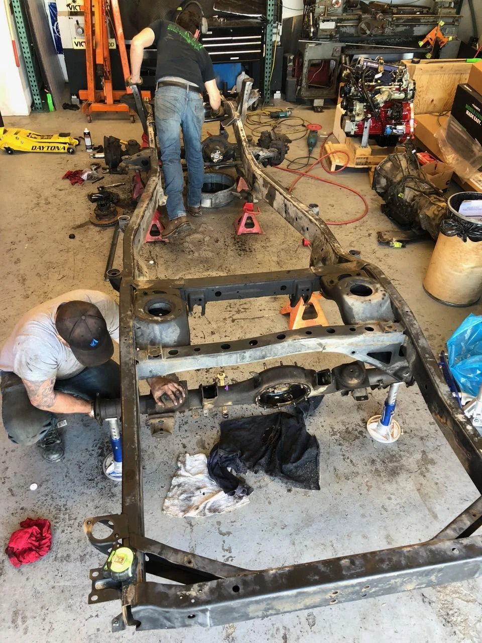

Chassis getting torn down.
Chassis fully torn down, old engine mounts removed, new engine mounts in place, fully cleaned and ready to head to powder coat shop.

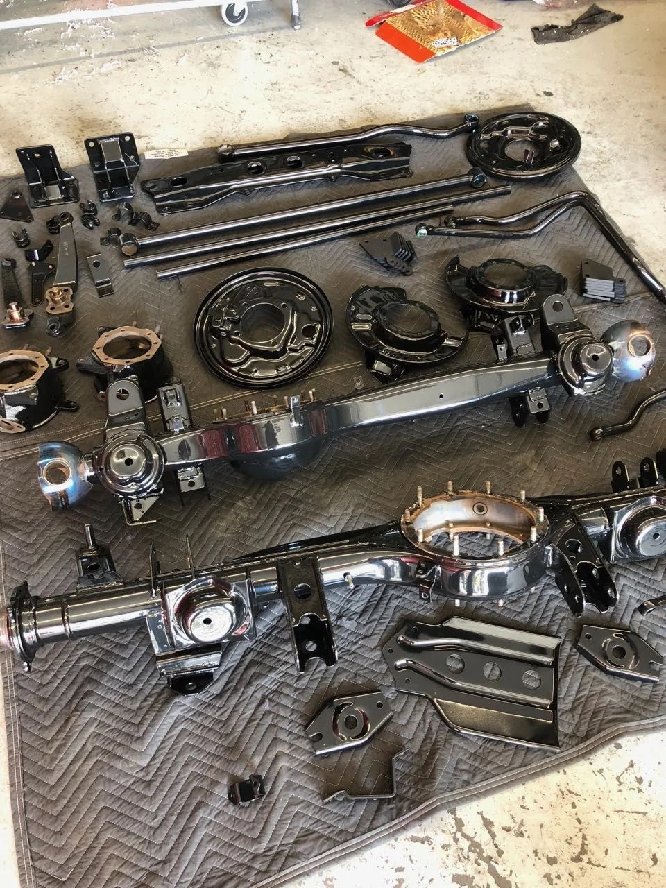

Parts coming back from powder coat in stages, getting stuff turned around as quickly as possible so we can get working one some of the more involved jobs as soon as we can.
SO MANY PARTS...

Chassis back from powdercoat. Used 2-stage coating, costs about 30% more, but is considerably more durable. Same process we use for all of our bumpers and parts that see any kind of abrasion.

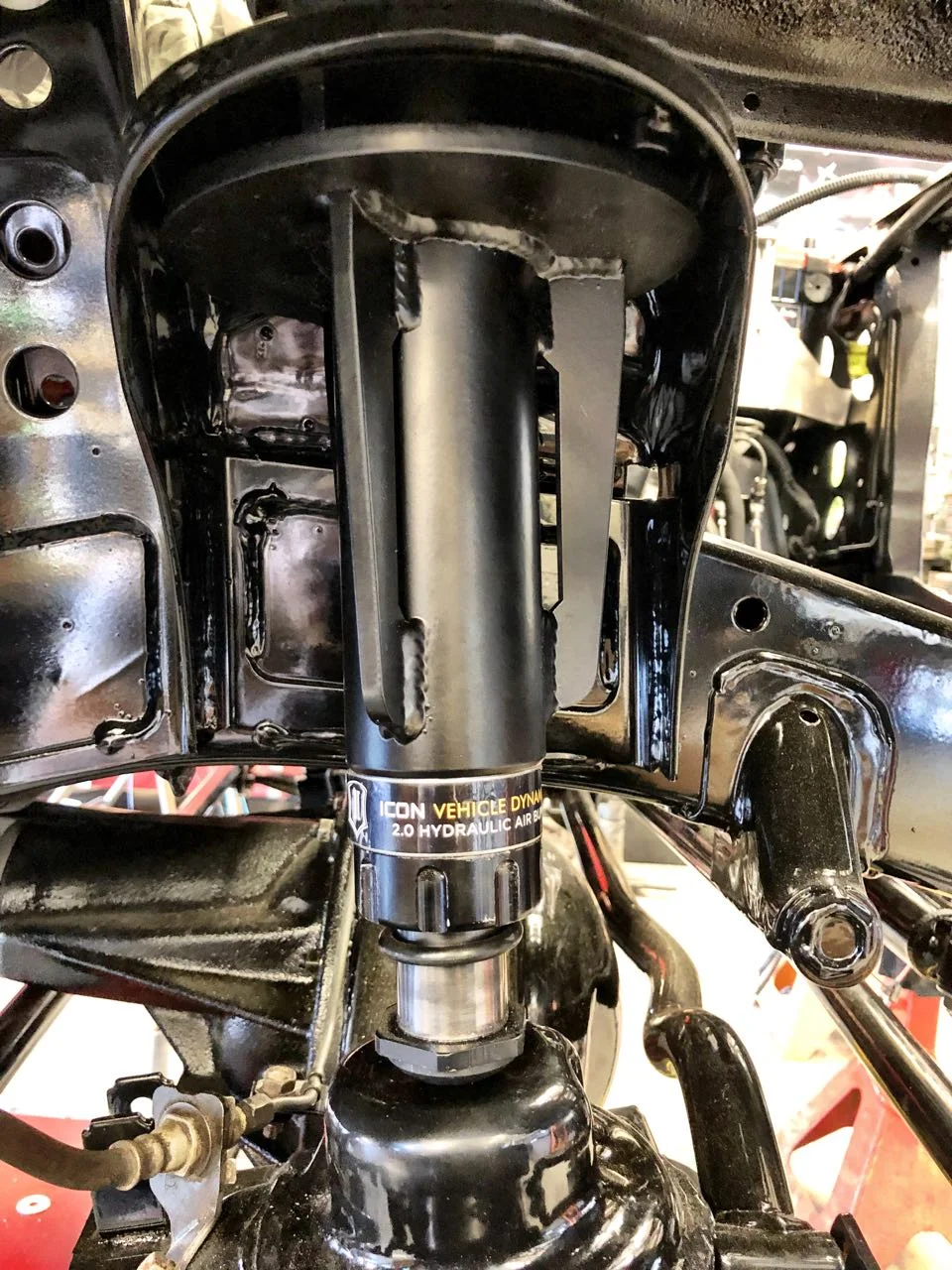

1" spring spacers with integrated ICON bump stop holders

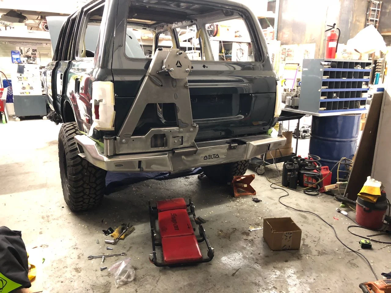

Test fitting of our rear bumper setup before it heads to powder coat.

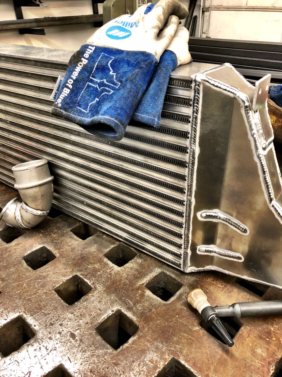

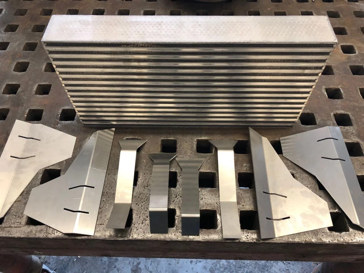

The parts and pieces about to turn into an intercooler capable of handling 950HP. To much is almost enough.

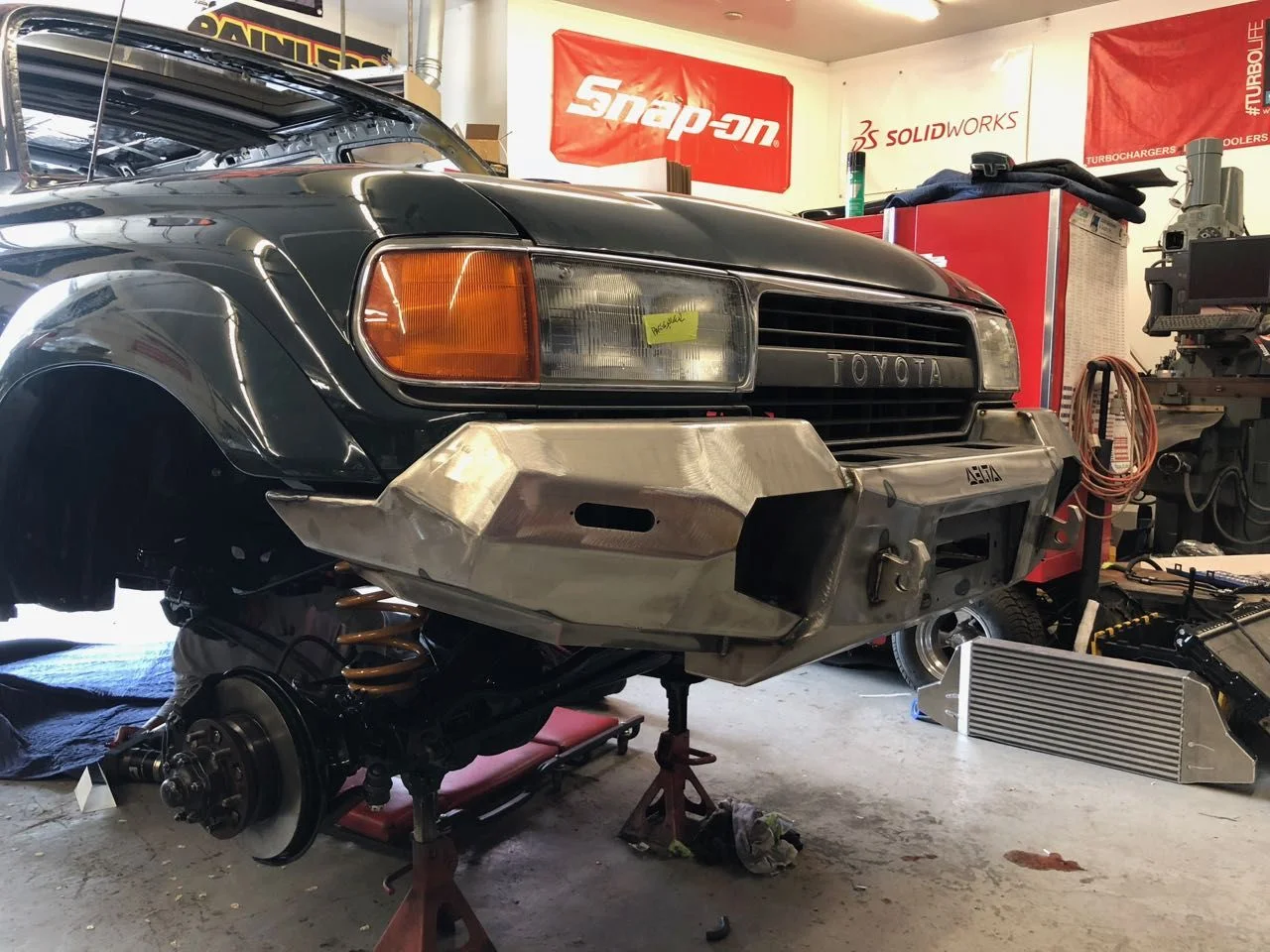

Test fitting of front bumper before it heads to powder coat
Intercooler all welded up and ready to go
The bump can/spacer after powdercoat

Newest ICON dealer in Idaho, nice folks to deal with. Springs came black but to add a little "flair" to the build, we had them custom colored with DVS accent color.

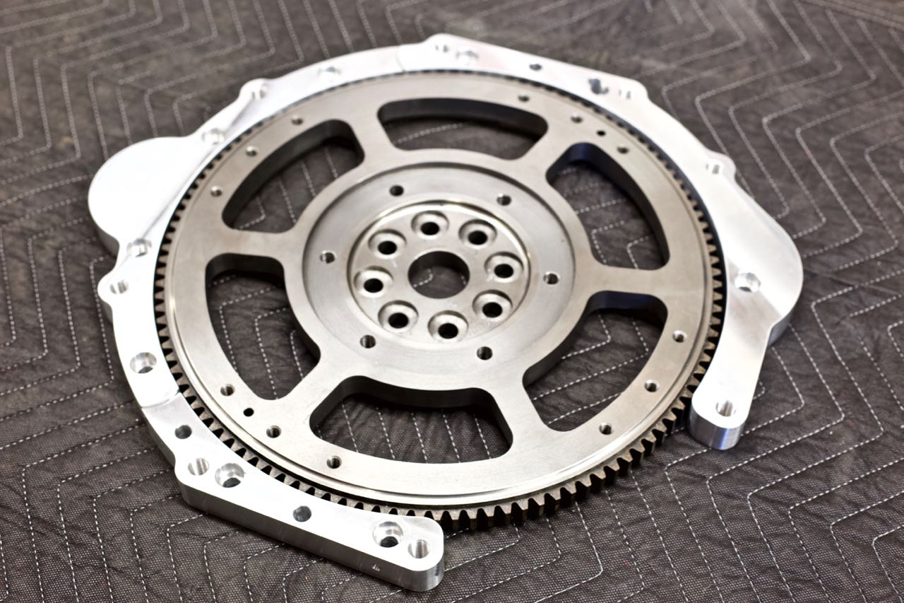

The basic components of the adapter kit. Essentially it turns the back of the Cummins into the back of the 3FE.

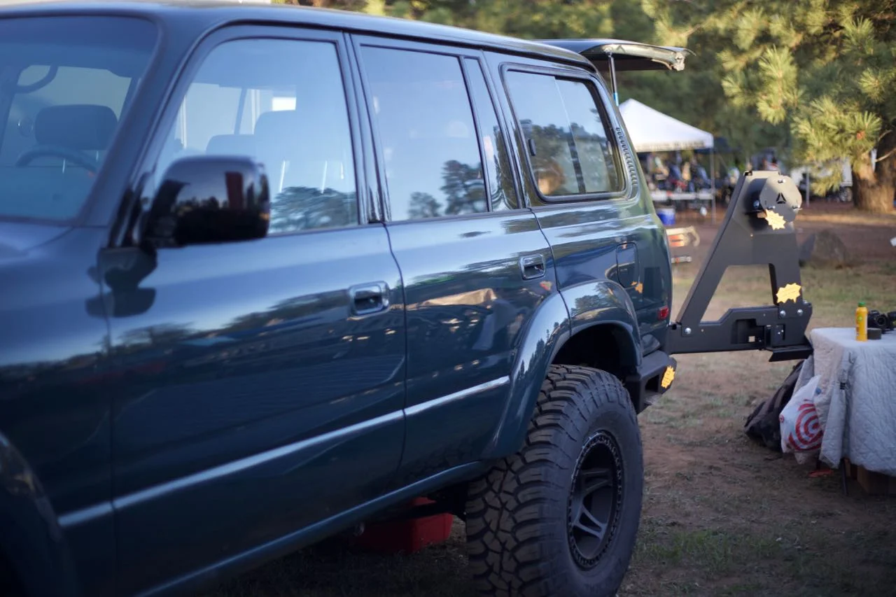

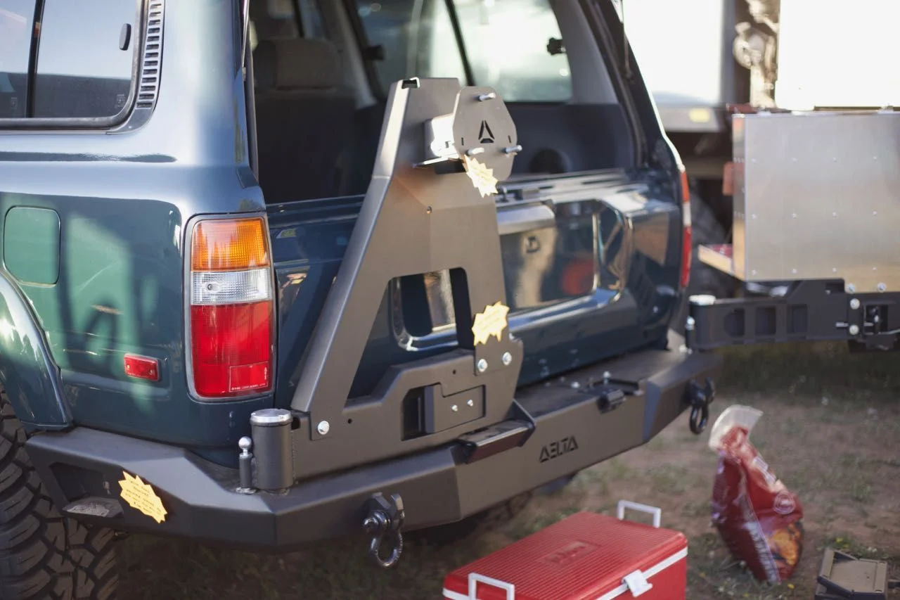

Fully finished rear bumper with spare tire carrier and kitchenette attachments. We like to keep our designs as modular as possible, so all the attachments/options simply bolt to the swing out arms. Once everything is finalized, we will be publishing the mount points. This will allow others to design their own attachments if they don't like ours.

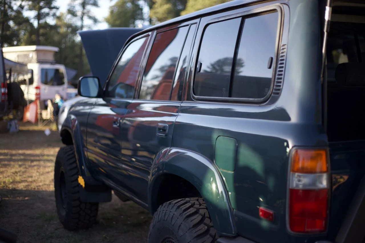

This color was the best mistake ever. It was color checked via pictures on phones, and was supposed to be slightly less green, but we ended up liking it quite a bit. The spring color is a very nice accent as well. Good shot of the front bumper here too. First day of the show, Cummins stopped by our space and dropped off a very nice placard with full build details. They also have us listed on their "Cummins Walk", showing off all the rigs that have been converted with the 2.8 (about 6 here).

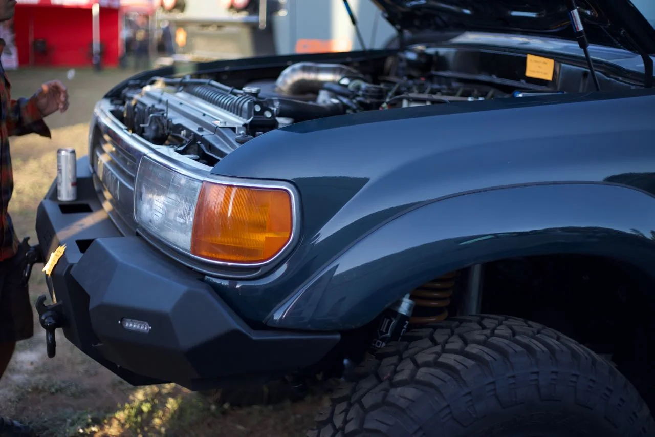

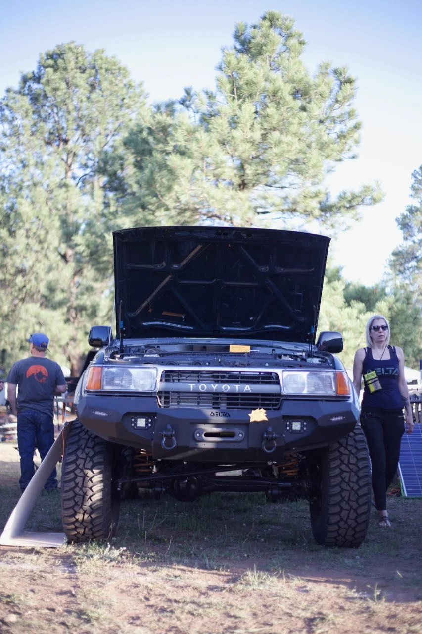

Nice shot of the front bumper. We went back and forth a bunch before deciding to remove the valance piece for bumper install. This allows the bumper to be very beefy and stout, while still allowing for high clearance. There will be options for bull bar across the middle as well.

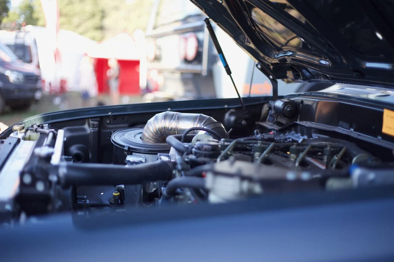

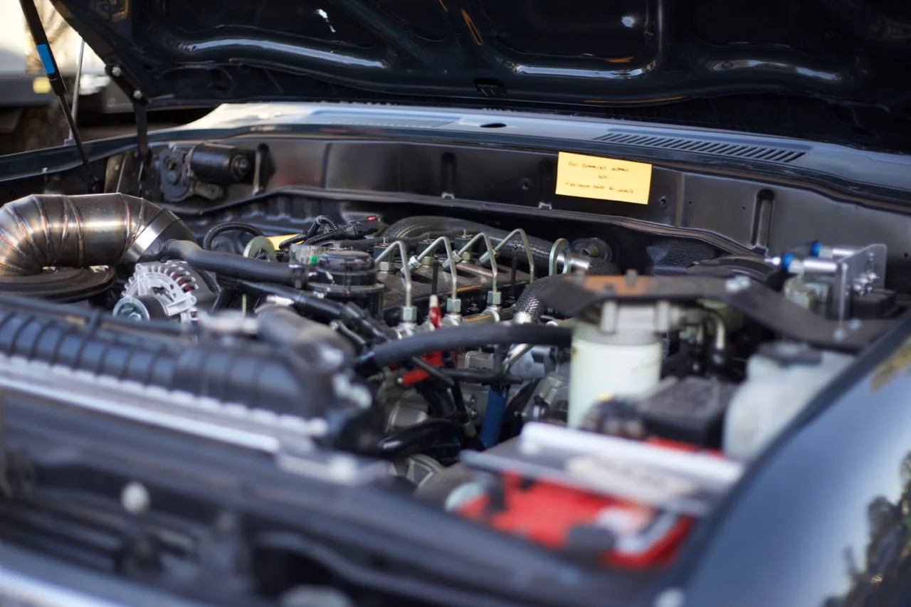

Engine bay. We tried to keep it as clean as possible, integrating as many factory parts as we could. The stock airbox was retained, but we added some bling to the top of it. We are going to be finalizing a much more reproducible piece for the kit.

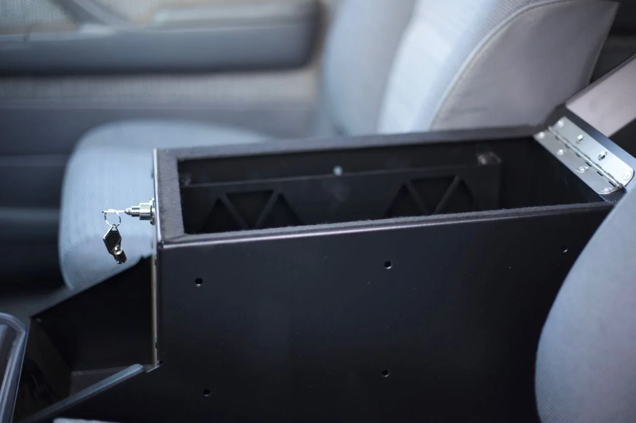

DVS center console with adjustments from last time it was posted. Can't see it in this shot, but the angles on the lid are way shallower and there are now breaks on the sides of the front pocket so you have to try way harder to skin your knuckles when operating the e-brake or digging for lost Cheetos. Not seen in the previous post about this product is the stand-off plate you can just see the top of here. This allows for easy strapping/bolting of whatever you want to the inside. There will also be inserts that fit snuggly into those triangular cutouts with holes for mounting holsters, etc. Seen in this pic is a full width plate, there will also be half width plates available.

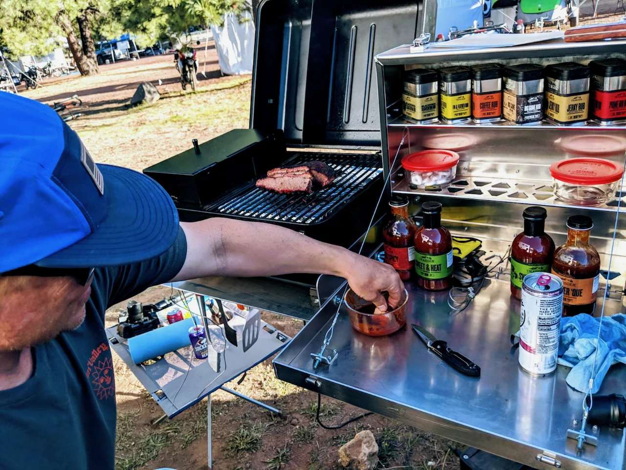

This one was kind of a "one off" deal for the show since we are across the walkway from Traeger. Wanted to get a extra attention from them, we'll see how that goes. BUT, since we've have a lot of interest in it at the show, we are thinking about producing a few of them. It bolts directly to the swing out and is super sleek and trim. This whole thing is certainly some next level glamping.

Who's intercooler core did you use? I don't think I saw any pics of it mounted, did I? The only few pics I see from the front of the truck I still see the transcooler on the driver's side. If you are putting a big front mount in are you making the relocation setup for the front hood latch support? I could see that being a decent seller for guys doing turbo's and turbo diesels.

It has to be air/air there is no path for the water. Appears to be about a 22-24"x12"x3" core. Doesn't quite look like a Bell Core. Kind of looks like a Garrett Core which for air/air is probably the best in the business.
Need more info on that intercooler.
Air/air air/water, pictures...
