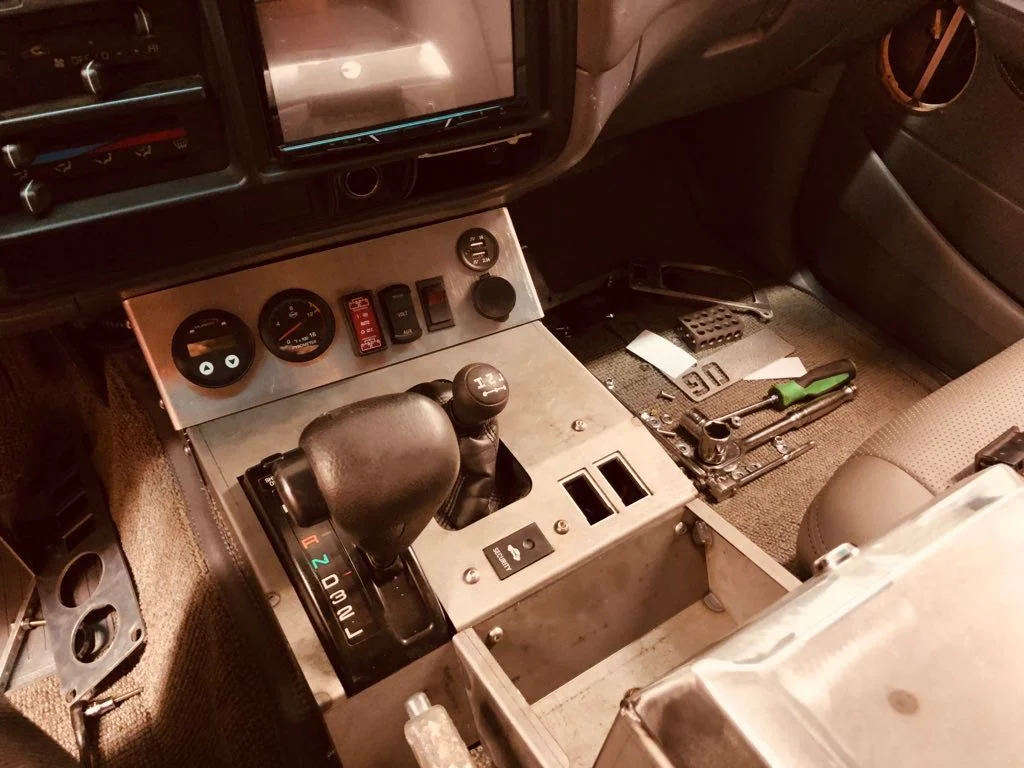

Welp, 3rd PROTOTYPE, UNFINISHED, UNPAINTED, UNPOWDERCOATED setup has been test fit in an early dash model and IT FITS PERFECT. Hopefully after this weekend will be able to test fit in a 95+ dash to verify fitment there. The same pieces are used for both, just assembled slightly differently, so if it fits the 95, it's time to make some incredibly minor adjustments and order some parts!
Fit them up in stages, since they will be available together and separately (center console and shifter console).

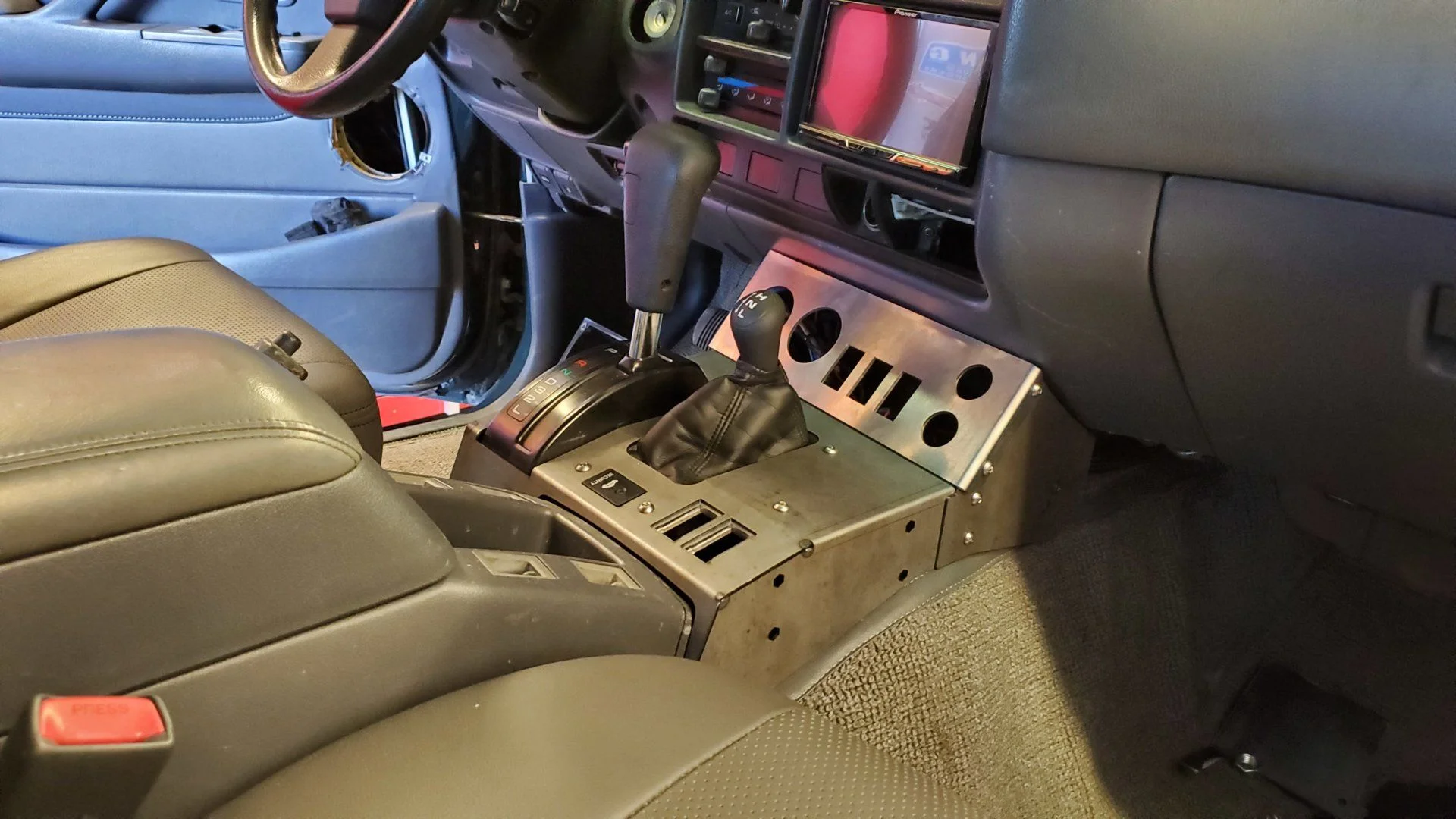

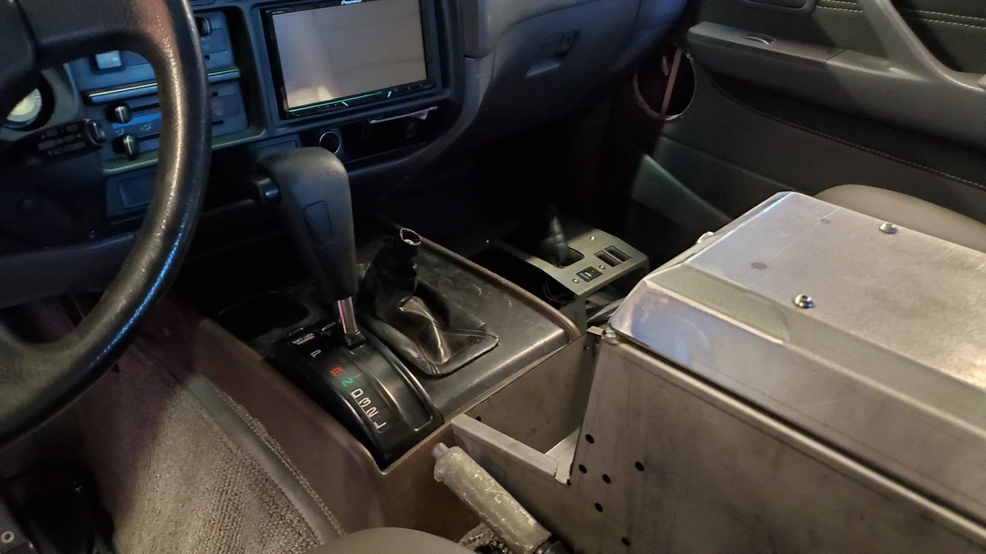

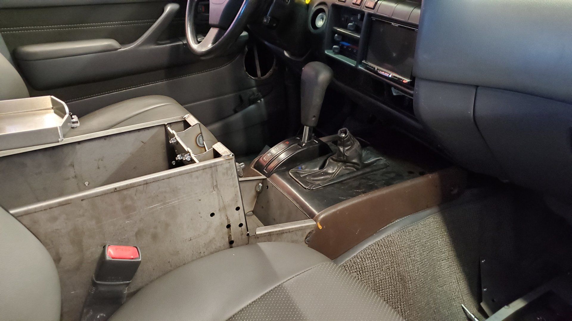

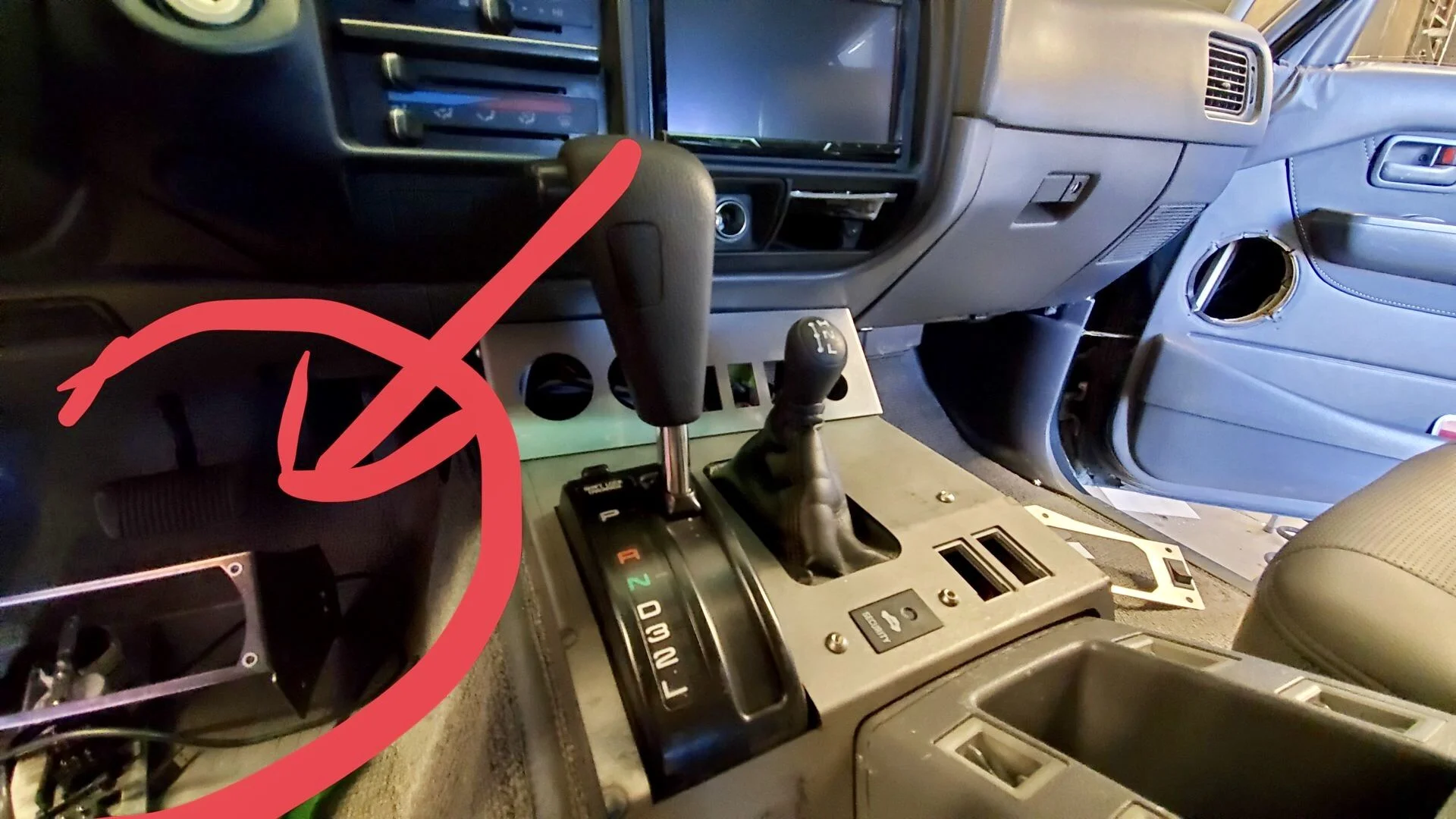

Pics below show:
DVS shifter console w/ OEM center console
OEM shifter console w/ DVS center console
DVS shifter console w/ DVS center console
The shifter console has an interchangeable gauge/switch/plug plate (just in time for that boost gauge!). We will offer a few options and a completely blank one so you can roll your own.
The switch plate and the backing piece that holds the switches to the rear of the t-case shifter are made from aluminum so you can easily file the OEM spec holes to fit Carling style in a matter of minutes.
You can see the four empty holes on the side, those are mirrored on the left side and are for future attachments (RAM thingys, cup holders, etc).
It uses an OEM t-case boot from a different application since the 80 series ones are not easy to find.
Here you can see the center console with the stock shifter console. The holes right behind and above the e-brake handle are for the cupholder and the internal storage stuff (those parts haven't made it back to the shop yet, will follow up when they do).

Wider shot of the center console.
Both fit up together nicely. Next post will have some wide shots showing the whole thing and some of the insides.
You can see all the different kinds of gauges and switches that fit in various places here. The three right next to where the shifter console meets the center console are standard for OEM switches (PWR/2nd, seat heater, etc) but as mentioned above can easily be filed to fit a carling switch. All kinds of room for all kinds of different switches/gauges in the upper plate.
