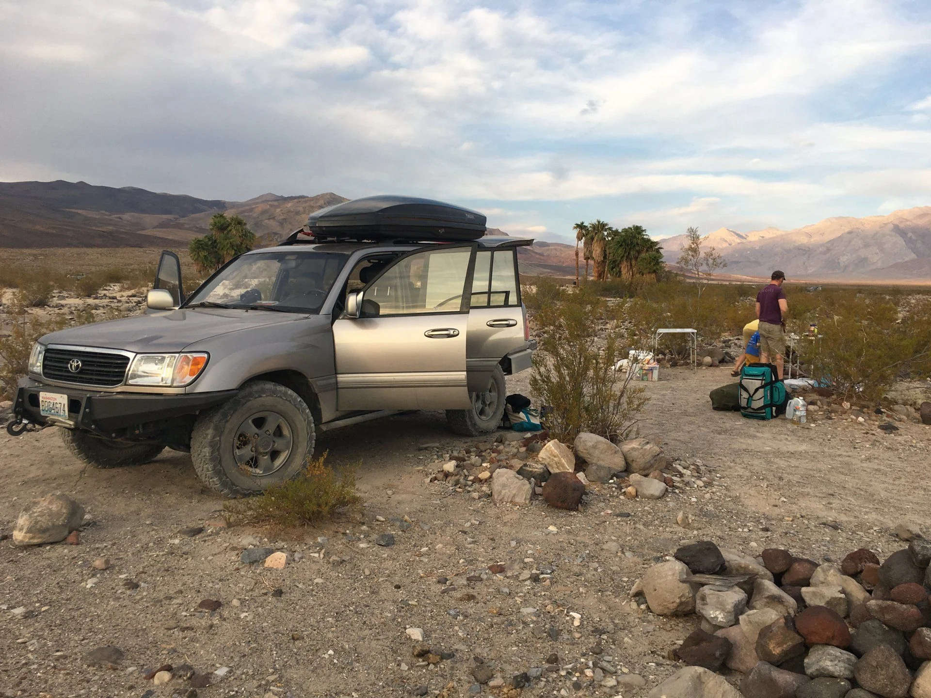

Just wanted to chime in with my experience. Slightly lifted truck with 33" tires, front and rear steel bumper, winch, sliders. The foam core pros are nice on-road, firmer than stock but not harsh. Less rolling in the corners. Supposedly they allow slightly more travel than the stock shocks too, but I can't confirm this. Proved their worth when I went blasting (50 mph) for a couple of hours straight across Death Valley washboard, in a fully loaded (5 people, plus all our stuff) cruiser. When I stopped, the shocks were too hot to touch, but they never stopped damping, and don't seem worse for the wear.
