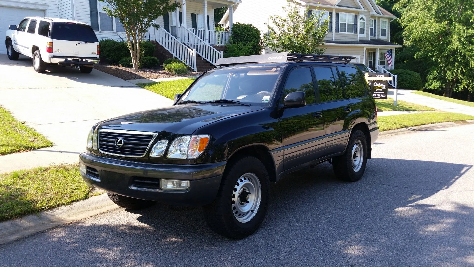

I just had mine installed and got it back last night. 2" Ironman Foam Cell Pro with the "light duty" 13b springs. Only thing I am noticing, and didnt see at the installers shop when picking up due to darkness, is that the driver's side is nearly 3/4" lower than the passenger side, both front and back. Otherwise, I have a nice 1-1.25" rake back to front. Any thoughts on why the driver's side might be lower (measuring hub to fender)?
The ride is nice though. I am coming from a defective AHC system (rode like it had bricks in the suspension) in my '01 LX470, so my reference is skewed...but I like it.
Thanks.
Thanks.
IDK if the rear springs are L/R specific, but some manufacturers are. Maybe they installed the wrong way?
The rear springs are L/R specific.
Hmm, ok, so that could possible be the issue. Do you know how I could easily tell if they are incorrectly installed when they are on the truck? I suppose I could go out and look and see if there is an L and R on them. I also assume that L is driver side and R is passenger side?
Thanks.
FYI Ironman is based out of Australia so all of their products are designed for RHD vehicles. Here in the US you will want to put the spring with the L on the passenger side and R on the driver side.
...Ride quality is very close to stock, I upgraded from KYB.
These comparisons are very subjective. I went from OEM shocks (and tbars/coils) to Ironman Foam Cell Pro shocks (sticking with OEM tbars/coils+spacers) and there is a very noticeable difference between the luxo-ride of the OEM shocks, and the Ironmans. You will feel small bumps in a much more pronounced way. I still love the shocks, just don't expect all the benefits without some of the ride-characteristic drawbacks, especially on a stock-weight truck. IMHO, it's a harsher ride, but "for me", worth the tradeoff.
I was only partially spitballing. The toughdog springs for the US 100 have a slightly higher spring rate on the driver side, for the gas tank.
Installing on the wrong side is a reasonable explanation for that kind of difference in the back. The front is just TB
Well shoot. That could be a problem then. Looks like I may have a garage session soon to swap the springs side to side. I'll have to take a look and see how it is set up. Grrrrr. Seems like that is a relatively easy swap if its just the springs...then readjust the front torsion bars to get the rake/droop correct.
BTW, I also have an email in to MetalTech4x4 to confirm the spring placement. We'll see. Thanks again everyone.

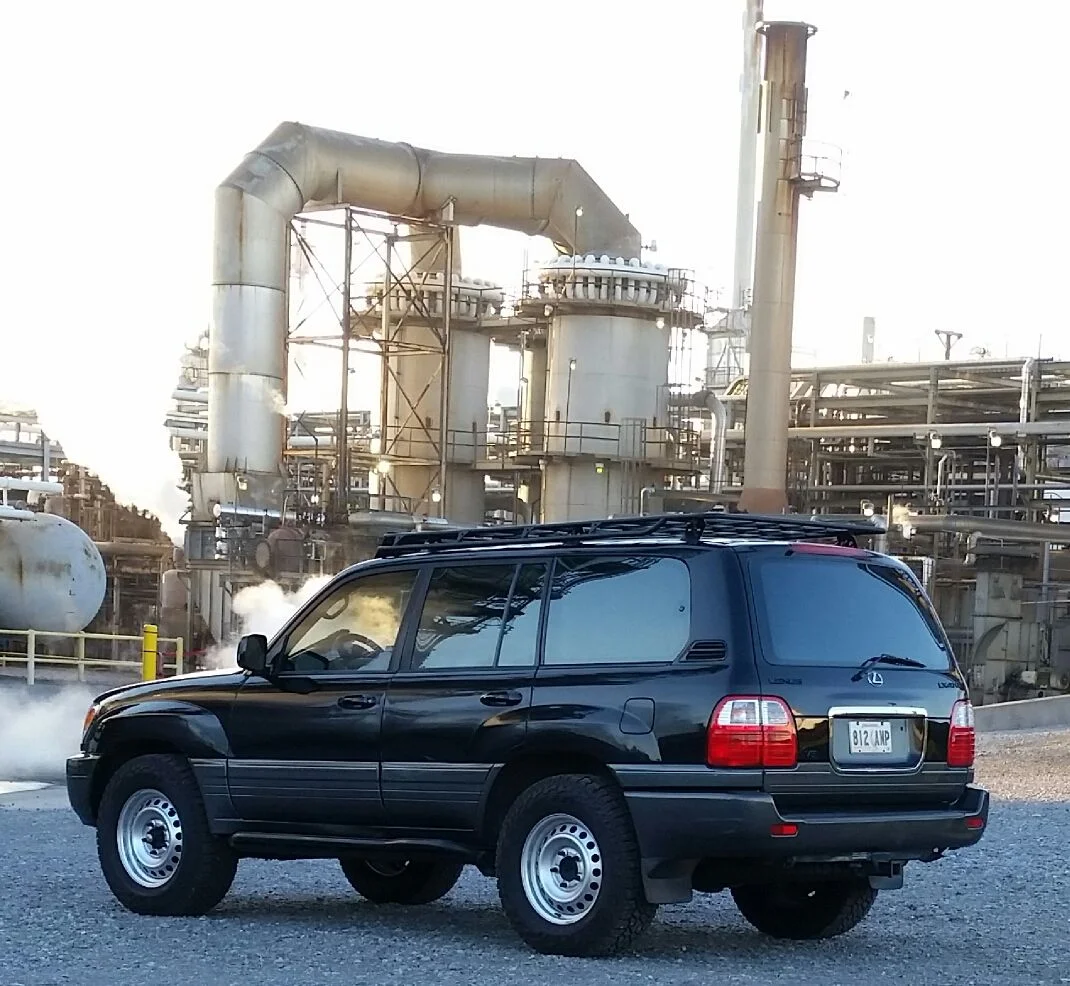

Ironman foam cell 2" lift. Huge improvement over a tired/ailing AHC system.
What tire sizes are people running with this lift?
