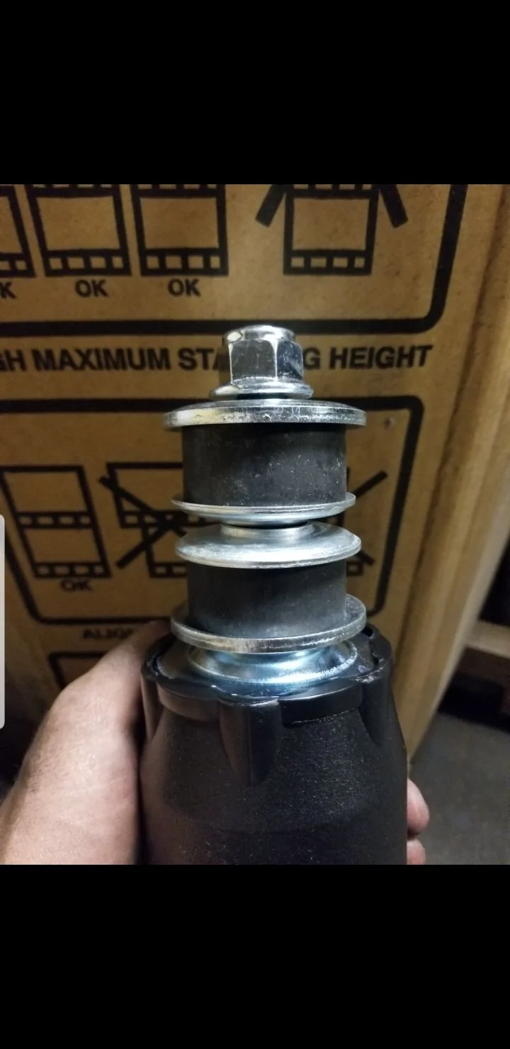

2. I lost one of the washers that go on the front shocks at the point where the shock mounts to the car. (Pic Below) Question is, where do I find another one? Tried Home Depot, Ace, Harbor Freight...no luck. Do I HAVE to get one from Ironman?
Having a fun time with 20-year-old Bolts/Nuts that are seized/breaking.
Any washer will be fine. Nothing special about those.

I may have one of those front washers, my new Toyota shocks included all new ones I think. I’ll check.

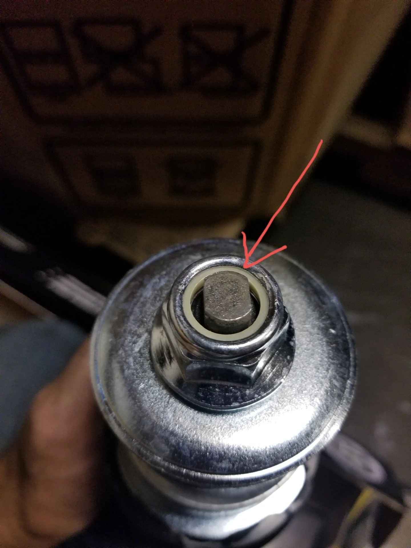

Anybody have tips on installing the rear, specifically keeping them from spinning while you tighten the first few turns? I had to use a 6mm (or maybe it was 8) with my other hand to keep the shaft from spinning. As you can see they're isn't really enough room since it's not sticking out past the nut very far. Hopefully there's an easier way out there.
