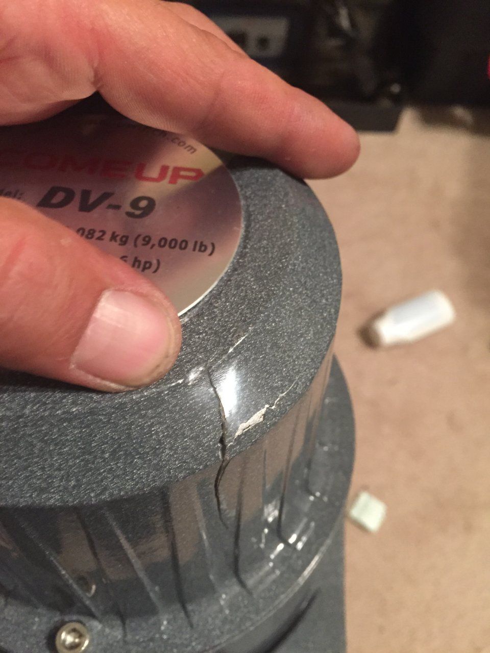

Head is definitely damaged:
Shipping box looked fine to me.
I've contact Trail Tailor to see how we'll deal with the damage.
I've already talked with ComeUp as soon as I heard of the potential issue. The replacement part has already been pulled and will be shipped out.
Sorry for the inconvenience O,
Jason
Thanks to the folks at @COMEUP and @reevesci I received a new brake clutch cover.
Swapping it out was easy: 3 long bolts.

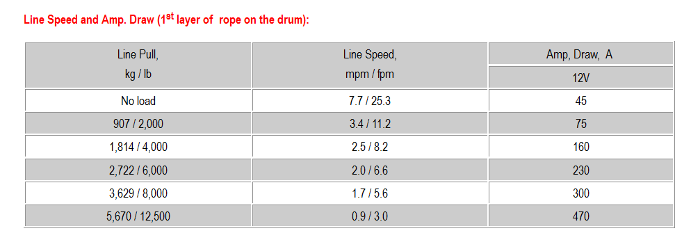

....so..... how would I determine the current draw of my winch then? It is noted on the packaging for the winch? (I will go up in the shop and look), but I would guess that most people would buy the circuit breaker at the same time that they order the winch, so finding that information easily on the website would be helpful. I've checked the various flavors of my winch, and none of them seem to include that information on the "product" page.
Dan
Dan
Thank you for your question. There are tables with all the figures, including Amp draw for each winch on our primary website.
Seal Gen2 9.5rs / 9,500 lb Self-recovery winch with Synthetic rope and wireless remote control
For example, here's the table for the SEAL 9.5rs
That info isn't currently posted on our USA website. We'll look to correct that.
Dan
Dan here is the chart for your 12.5rs
Jason

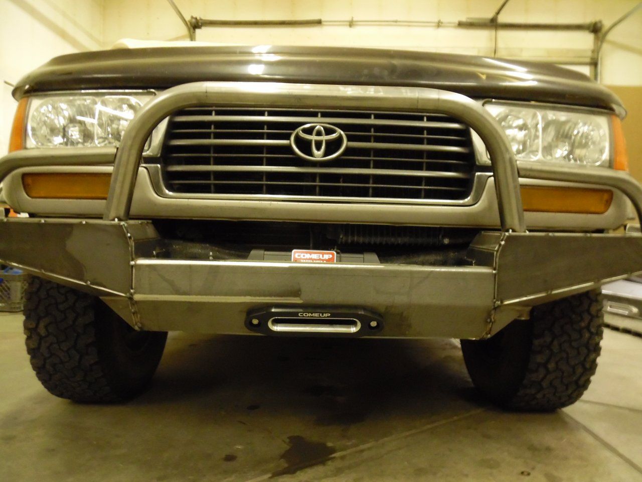

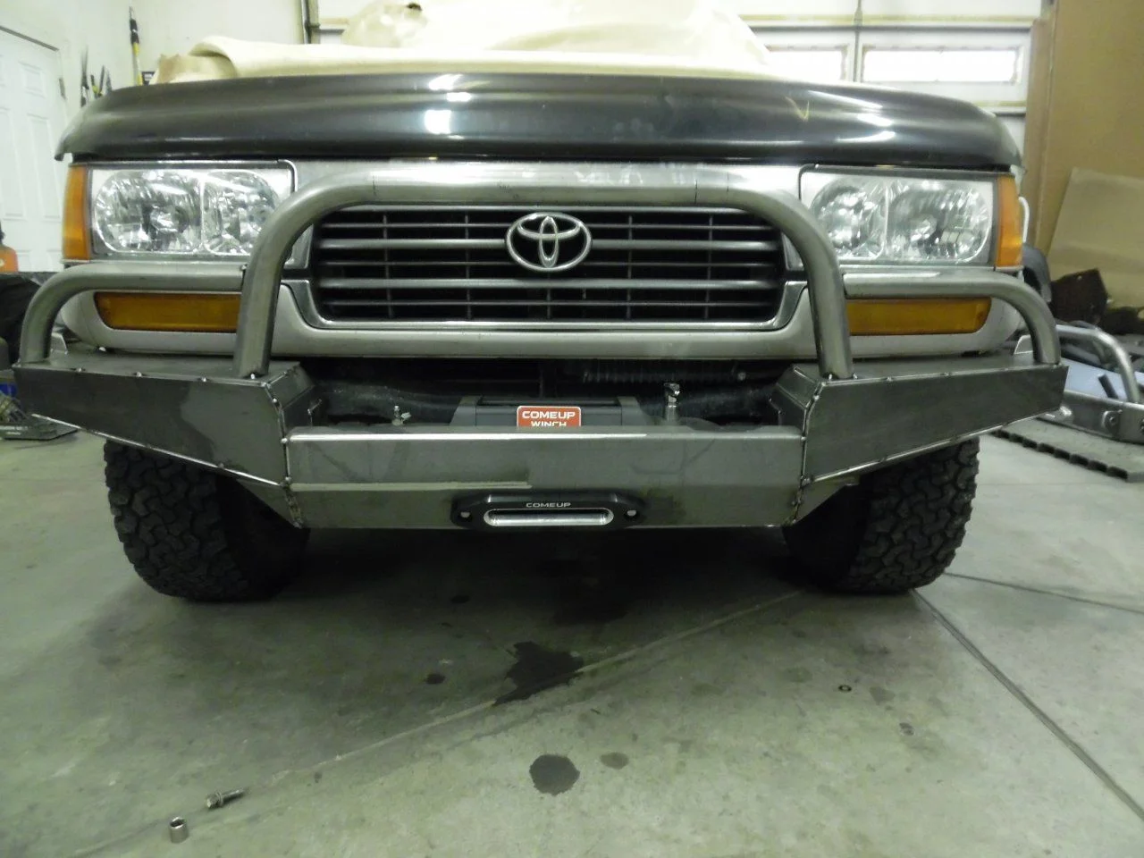

ComeUp 9.5 and 12.5 in my new 80 front.
Out of the box the 12.5 needs the clutch handle rotated from the forward to the top or rear position. Otherwise plenty of room. If the 80 frame was just 5/8" wider... the Seal GEN2 16.5 would fit my unit...
J
9.5.....
12.5.....
