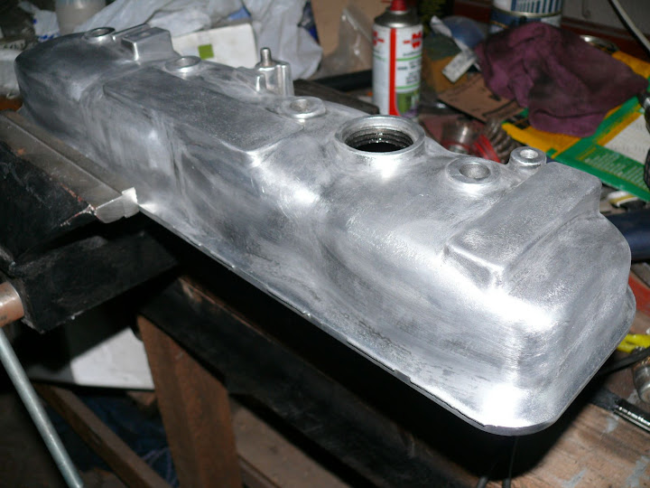

Next up the Rocker cover
After 2 hrs of sanding ..
About 5 hrs ..

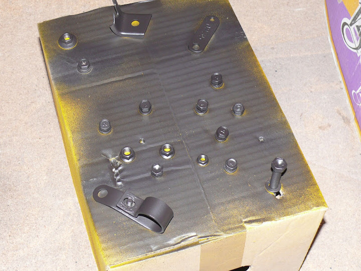

Inbetween the sanding and painting odd bits and pieces ..

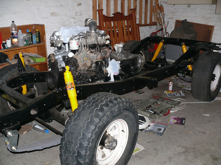

.. I got a few other issues resolved this weekend. My old shocks were totally shot but I couldn't go buy new untill I had decided on and physically received my new leafs.So I needed a temprory fix.Luckily help came in the form of a friend who gave me a good set of 2nd hand shockies off his 79 ser. Although the shockies could compress and extend further than my old ones, the front shockies needed some modification ...

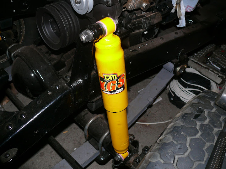

I cut the eyes from the old shocks
and welded them to the "new" ones. Welding to the shaft-side of the shockies was fine but on the tube-side we had to be very slow & carefull not to get the seals damaged from the heat.
All done and painted...

Not too bad for a temporary fix untill my new leafs arrive from the US ? :hillbilly:
The questions remains, Theo - do pink bushes give a softer ride? :lol::lol:

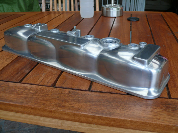

In spite of the heatwave of the last two days I got a bit done ...
After sanding with 800 grit
.... 1000
..... 1200
.. and finally 1500.
Fitted the crankcase vent cover after all of the last bits were painted
Oil pressure and low pressure cut-out sensors

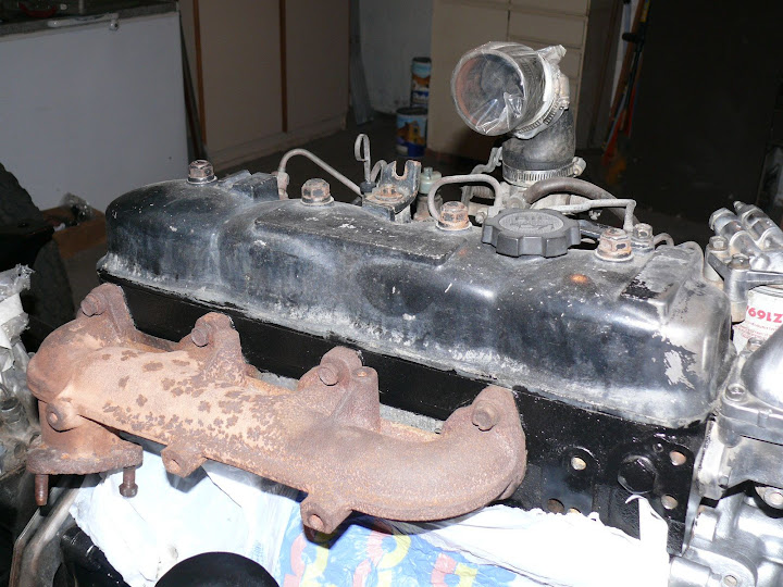

The result sofar ...
:cheers:
Theo ~ you should have that fugly exhaust manifold ceramic coated - then it'll really look cool.
Gr8 work ~ keep it up
Thanks Oom Keith. I was thinking about it but I only have 1 spare exhaust gasket and will rather use it on that elusive 13BT manifold that I have been searching for ... :crybaby:

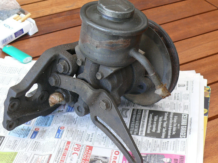

Also got around to fitting the rebuilt clutch release cylinder & starter
Next up, a real nightmare
:cheers:

P/S cooler lines etc
And the result
