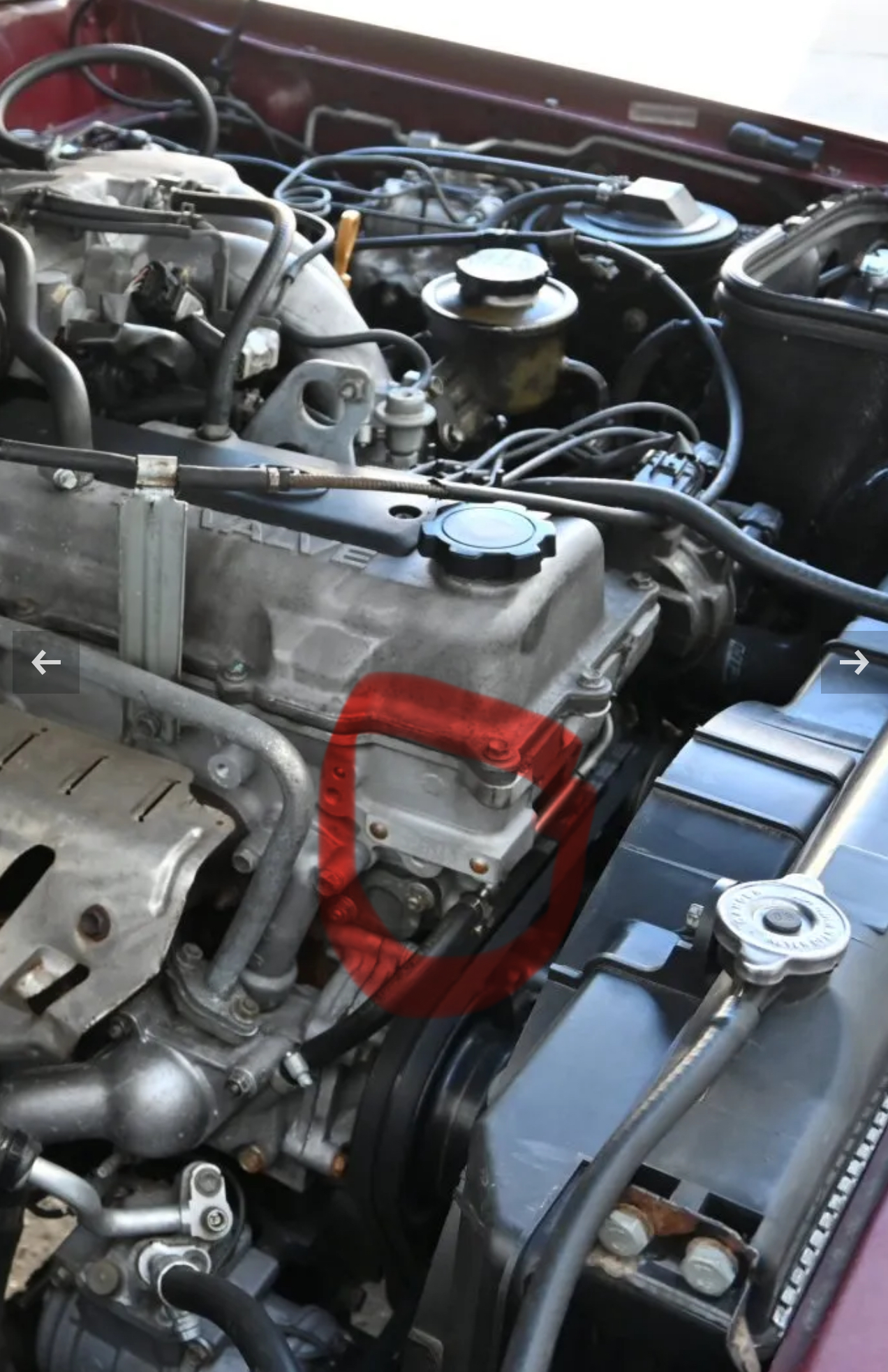

The M/C and the booster have been replaced and doesn't appear to be Toyota/Aisin and the vacuum line from the booster to the engine should be a Toyota molded piece (it is available), not generic. Good news, the Aisin M/C is fairly cheap on RockAuto. A legit Booster is pricey though...
Looks like they redid this area with new and cheap parts...plus the firewall in this area looks like it has bondo? Maybe that side impact was hard....
Most of the hoses on the engine appear to be replaced with generic hoses.
The bolts are weird...like most are ok, then you see generic bolts randomly about...
2nd row seats has an odd bolt as well. I would get authentic Toyota bolts to replace these as they are safety related.
Agree with lots of the folks looking at the pictures here. Many things are out of place and random nuts and bolts raise some serious concerns. The engine bay is interesting and would look at the vin plates as my gut tells me this truck has more miles than advertised. My shifter is not as worn and I have 260K miles.

Should have a vin on the body at the driver. Should match the vin on the engine head which is on the pass front area of the head , gets pop riveted on. Vin on frame is pass side wheel well in front. Should have vin stickers on all the doors as well
What years did they start putting the vin on the cylinder head? I see more pics of engine bays without the vin than with the vin.
Sorry to hear about all the issues..
My ‘97 has the vin here on the engine, not sure if they did that on ‘96 as well. Also there are usually 2 holes on the firewall in front of the driver, those are missing.
