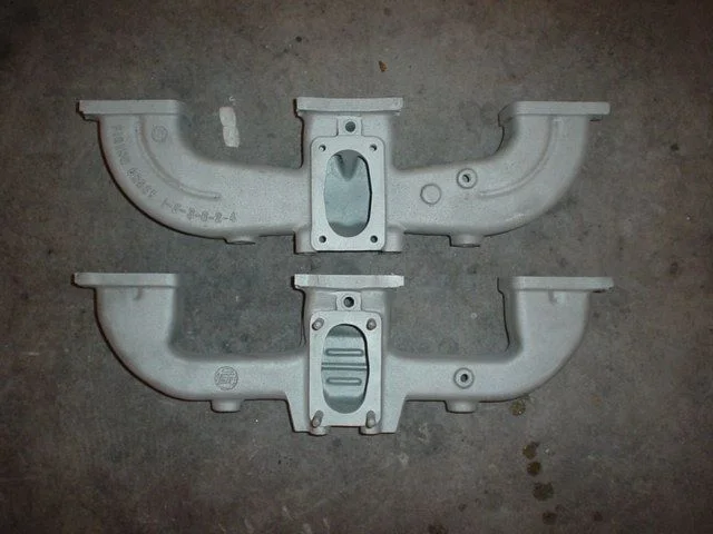

Old thread, I know but a related question: if you look at the pictures
above of the two intake manifolds, you'll see the four holes for
the carb mount - plus a fifth hole. What is supposed to go into
that fifth hole? Should it be plugged?

The “fifth hole” is used to secure the intake manifold to the exhaust manifold. It is a through-hole, does not, and should not be in the plenum of the intake manifold, and there is no reason to plug it when using this manifold with a header configuration.
