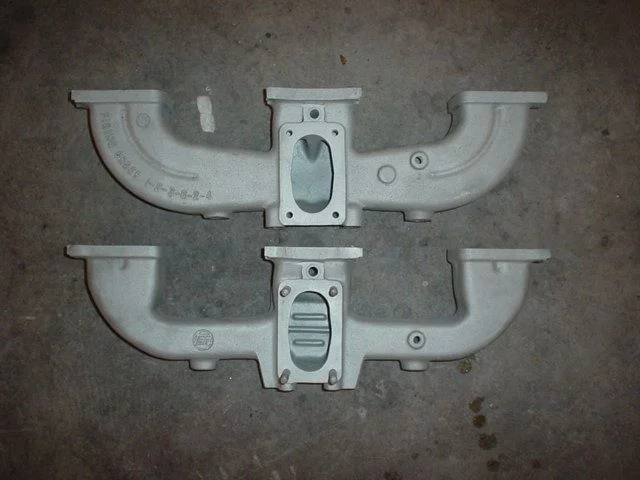

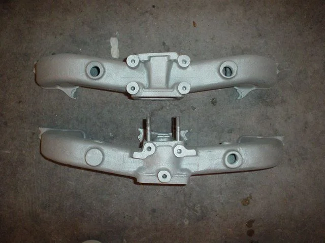

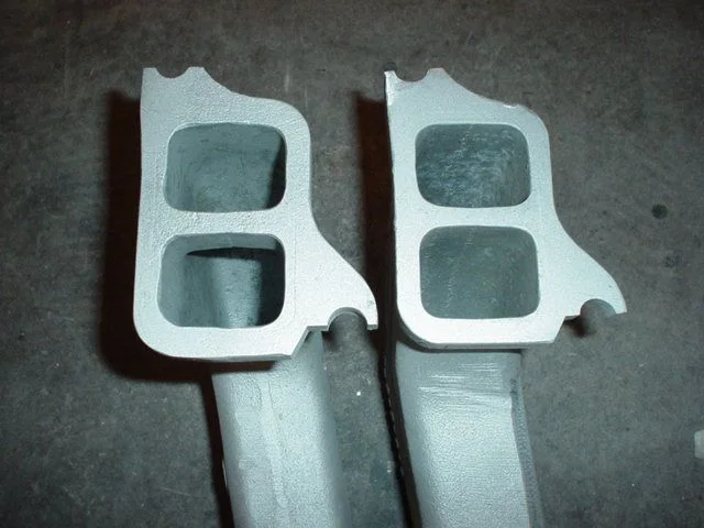

Thought I'd add a couple of pics. The top one is a 9/66-9/69 wide runner intake and the bottom one is, uh later, I guess? EDIT: I meant the wide runner is on the RIGHT!
Ed
That's cool that the wide runner has the firing order stamped into it.
In the first pic you can see how deep the sparation of the runners actually is. The side view shows the relative thickness of the two.
