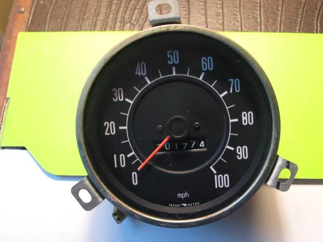

Here's the speedo, the only thing is this may be for a later year. Before I decided to do the Ram Jet and H55 I was going to put in a 4 speed trans. Does the 4speed or H55 required a different speedo? I bring this up because we ordered the H55 from Seth PVCruisers, there's a part number and his name on this speedo. If this will work let me know and I'll ship it out tomorrow.

I am not sure, can anyone speak to this? Does this speedo look like it will work with a '74 Pig cable?
Lou, if you ordered it for a '74, I would think it would work for mine, unless you told him you were going to swap to a different speedo cable...

that speedo will have a screw in cable, your 74 will likely be a clip on. also, that gauge cluster with the amp gauge is pre 7/'70 style before the ammeter went away until 9/'75

The threaded speedo cable/speedometer fitting was used on the earlier rigs to my knowledge(up to 9/72?) The speedometer housing that Lou has is obviously a clip fit which will coincide with your 74 pig's cable. Why not pull your instrument cluster or reach up behind to determine what type of connection is used?;)
Here's a comparison for you - two early threaded verses the clip attachment
