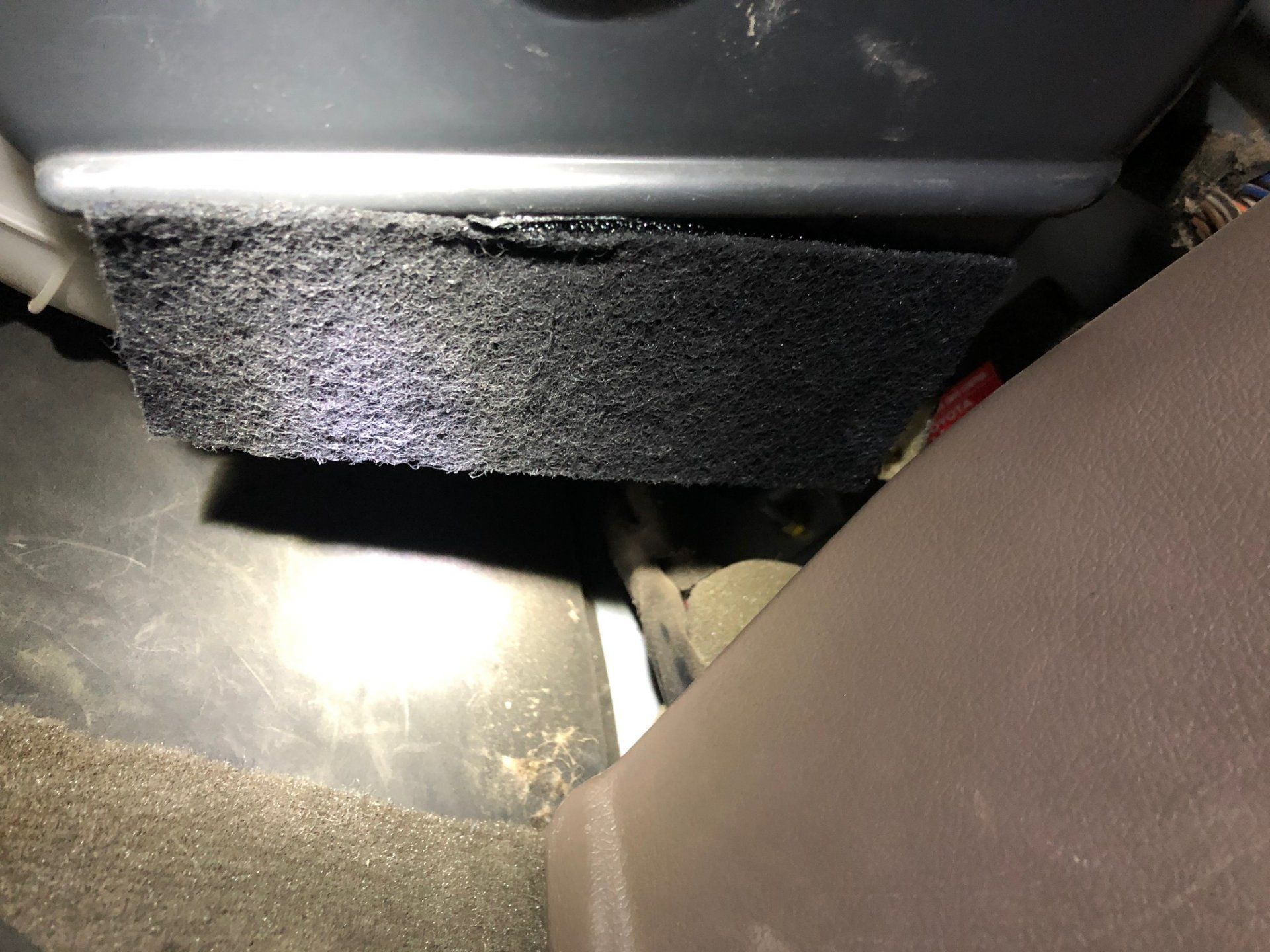

So....Here's what I did to Forge my idea from my RedNeck book of how too's:
- I located the A/C-cabin recycle inlet port under the Interior Dash Passenger, bottom-side.
- I bought an Auto Carbon Filter Pad "you cut to fit" from amazon.
- Measured a 5"L x 2.5"W piece to fit.
- Cut a few slivers of the Rough Side of 3M stick Velcro to outer border-frame the graded inlet-box side.
- Pressed firmly and set to cover it 100%
As basic as it is... It's holding very well and... It's what you'd call (reusable/replaceable) for the most part.☺

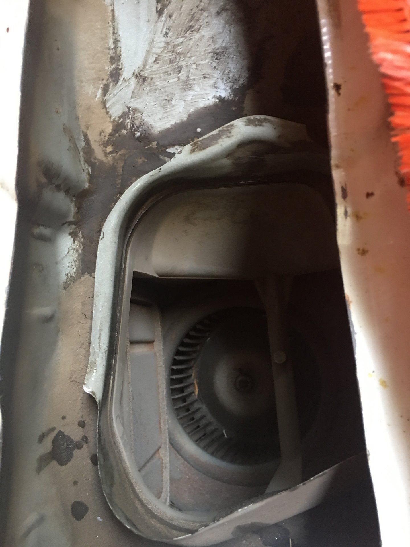

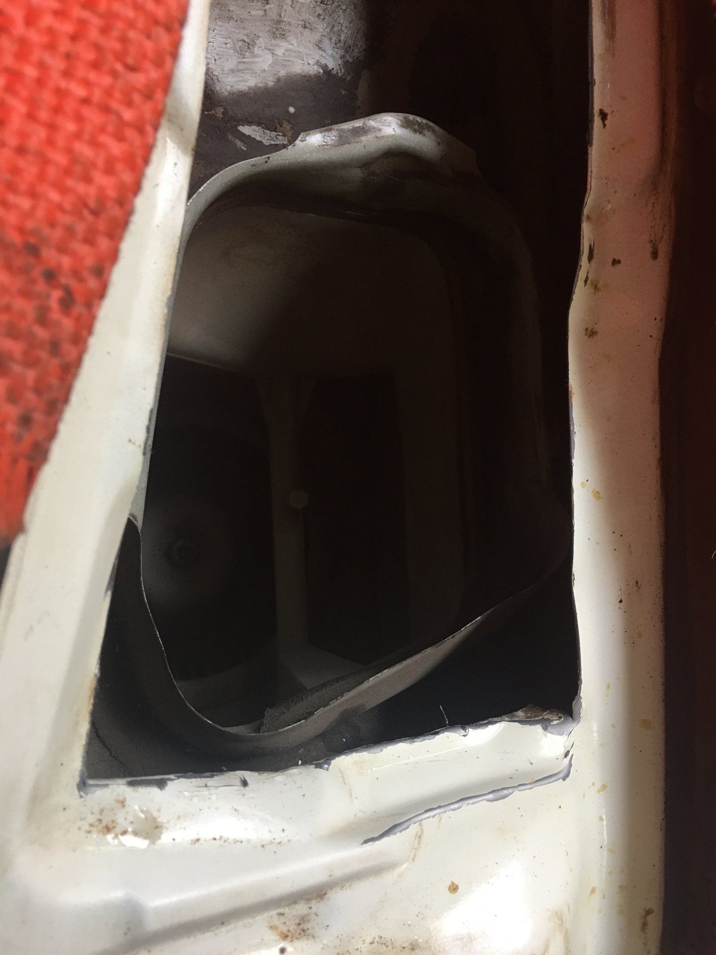

So, I cut a bit too much out of that panel to find the intake duct. The intake ducking is raised above the horizontal sheet metal and has a bit of a lip to let water flow around it. I used a cutting wheel on a due grinder to trim it about 3/8” above the horizontal panel so the filter would fit.
I then used a piece of cardboard, tapped against the lip of the intake duct with a rubber hammer to get the outline shape into the cardboard. I cut out a bit of the cardboard to line it up. then dropped the filter on top of the cardboard While in place over the duct and traced it (to get the outer boundary).
I left a flange around the outside edge of the plate (about 3/8”) to seal it to the case around the filter.
the second piece is a box around the filter with a flange bent outside around the perimeter.
The lower piece was siliconed on, (heavy dose of silicone) and then the upper on top of it, I had to do two piece separately in order to fit it in.
I let the silicone cure for about 6 hours, and then ran a bead over any other spots where air could flow.
the filter drops in snug, I should have a ring to retain it but I don’t think it’s needed.
then a top plate to cap it off.
the filter was about $8 from the local parts place.
