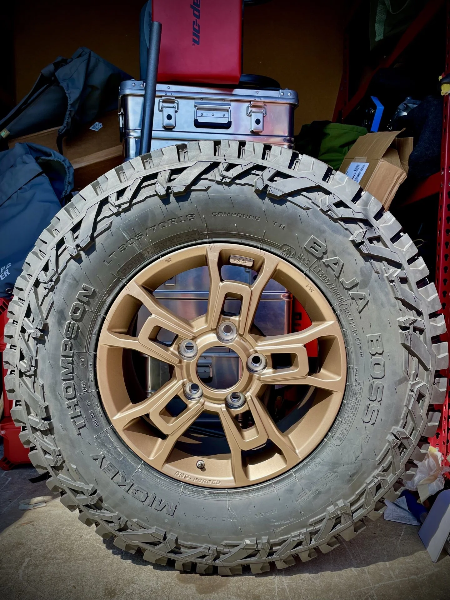

Well, I now have 6 x Mickey Thompson Baja Boss A/T in 305/70r18 on Heritage wheels in a storage unit but no truck to put them on as the 200 is at Valley Hybrids for some preventative maintenance. These tires are pretty large... off-vehicle they measure 35.5 in diameter based on measuring the circumference. Hope they fit, lol.
I'm pairing them with 1-inch Bora spacers, lots of fender liner trimming, some nasty hacking of the pinch weld, and a body mount chop. I also finished fabricating a modified KDSS spacer that should keep the end links perpendicular; that said, I'm not sure I'm up for messing around with the swaybar again just yet.

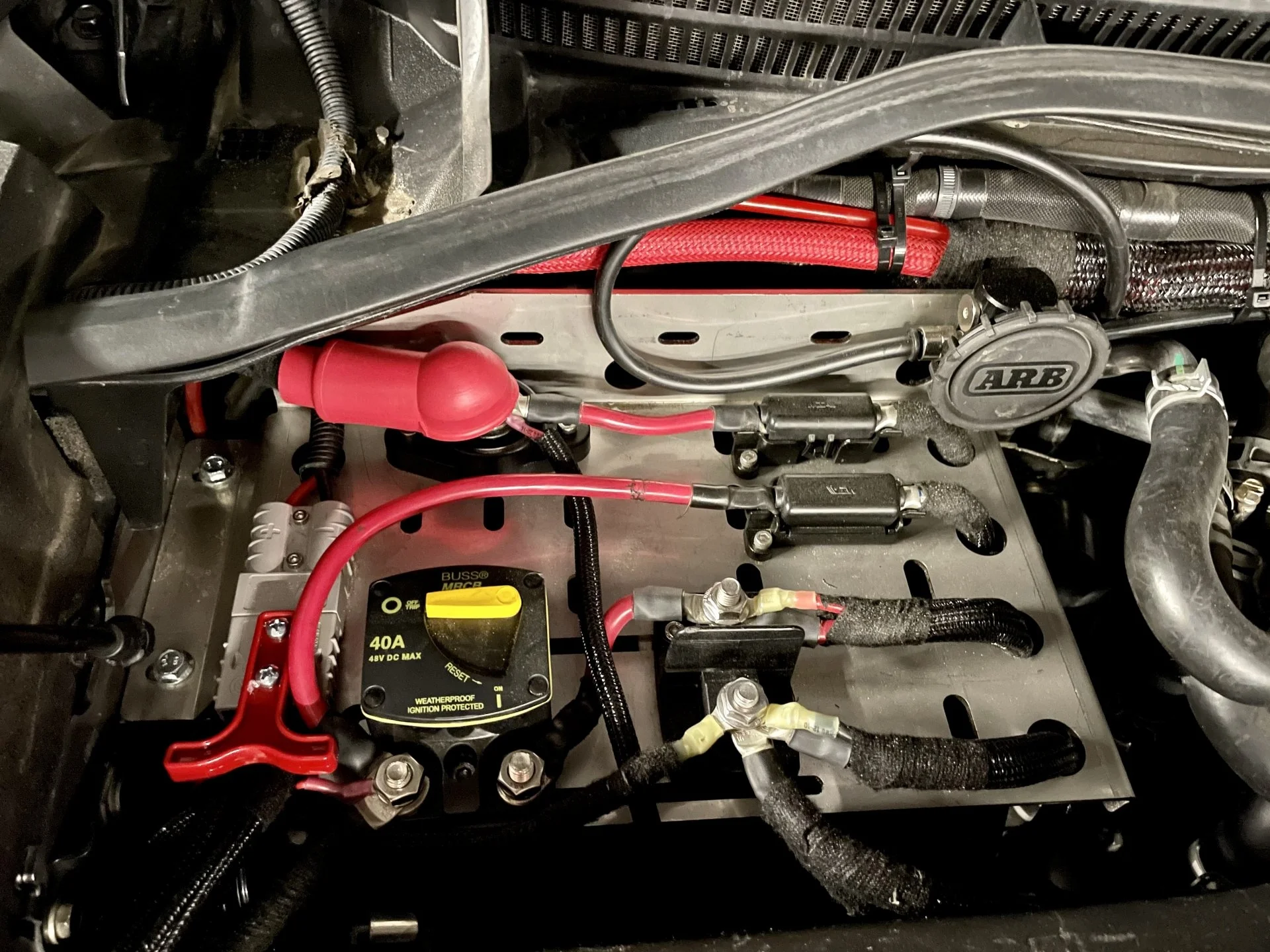

  • Electrical: I cleaned up my aux wiring using some of Slee's new fancy bracketry. This should make maintenance and testing a little easier. (photo below)

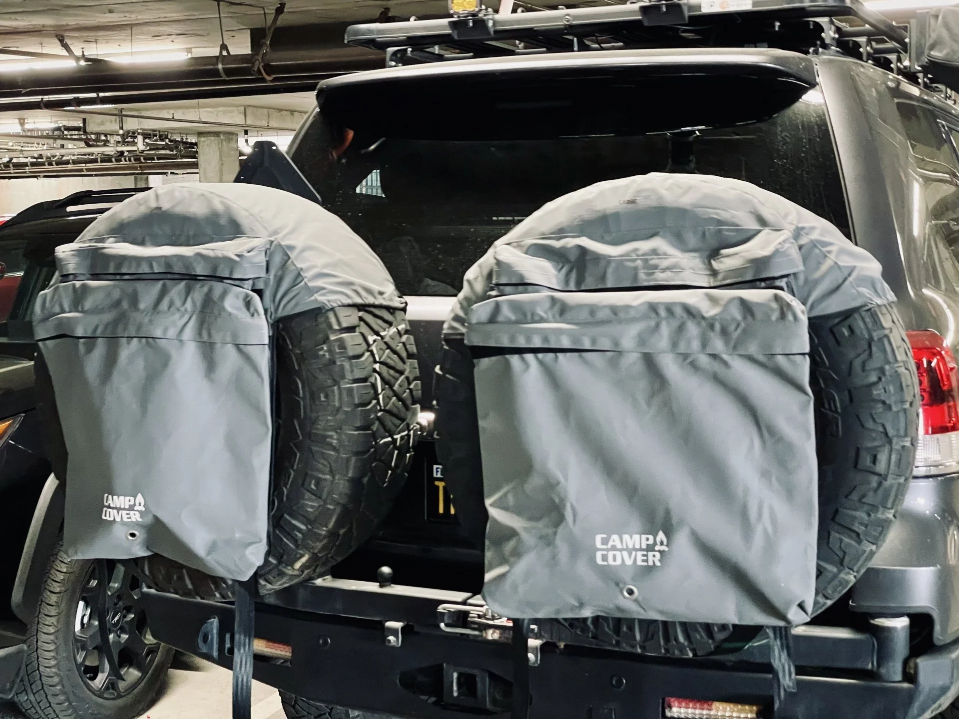

  • Spare Tire Storage: A friend came back from J-burg with some gear from Camp Cover for me. I've been wanting to try these for a while... tire storage bags with a bit of protection on top of the tire. The bags are pretty amazing. My complete Snow Peak fire pit setup fits in the back-most pocket in one bag and I keep a utility mat in the second bag. The main storage area on each bag is completely empty and will be used for trash, dirty recovery gear, etc. on the trail. (photo below)

  • 6 x Heritage bronze wheels are incoming

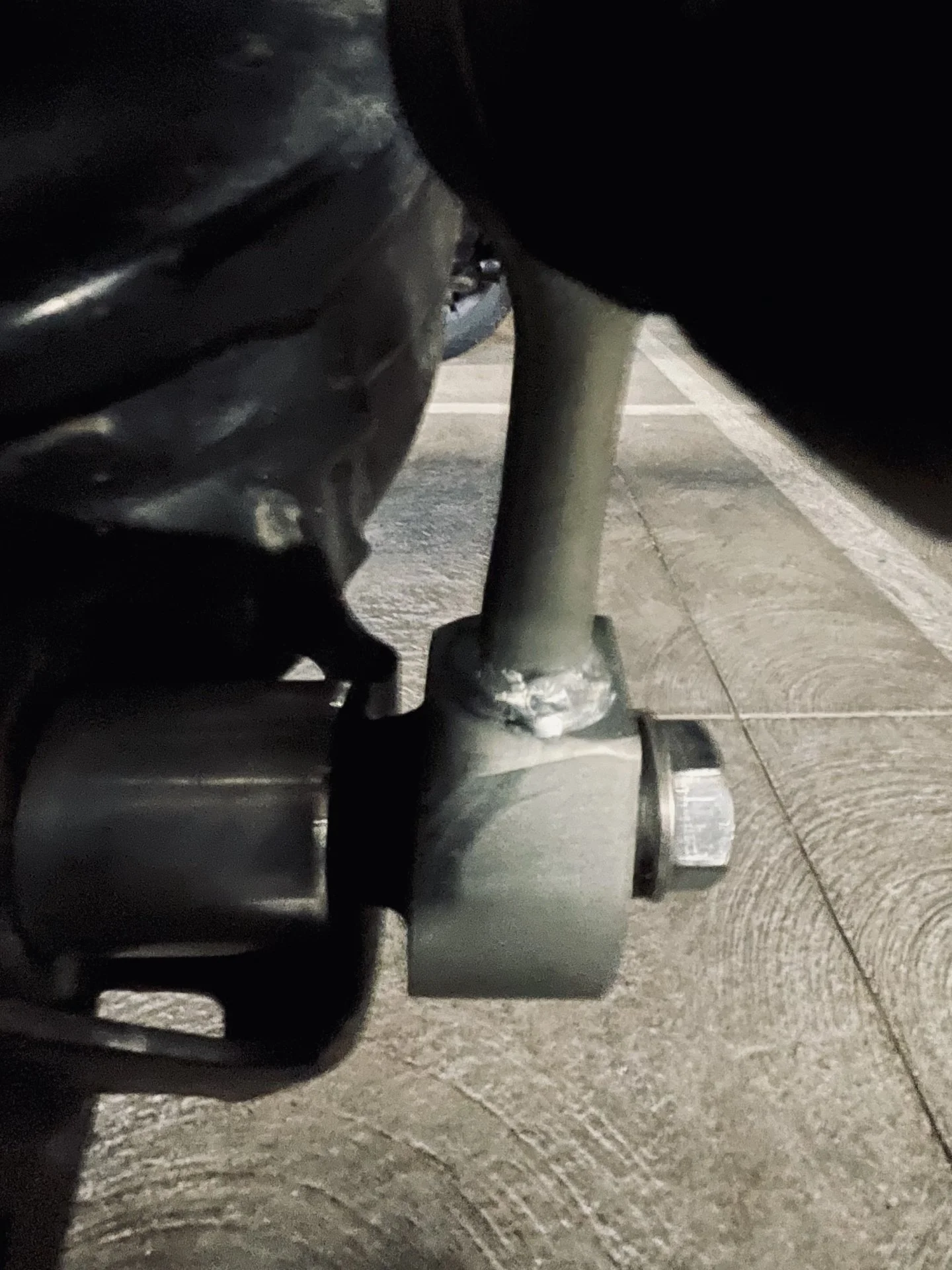

  • KDSS component replacements/fixes - the swaybar bushings aren't doing well so I'm going to replace those, do the KDSS relocation, replace the endlinks and attach on the outside of the arm thanks to the work from @Willy beamin, @Atwalz, @linuxgod

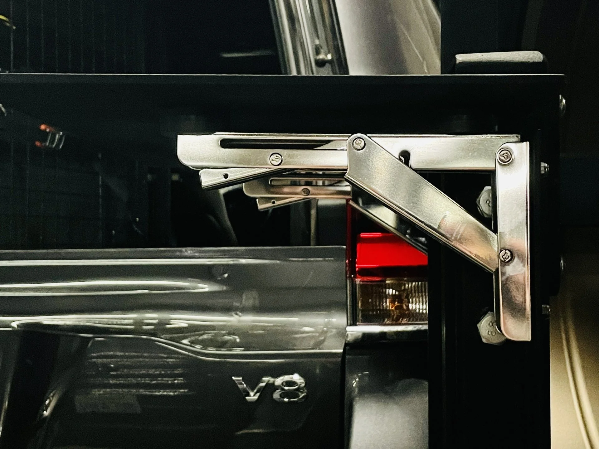

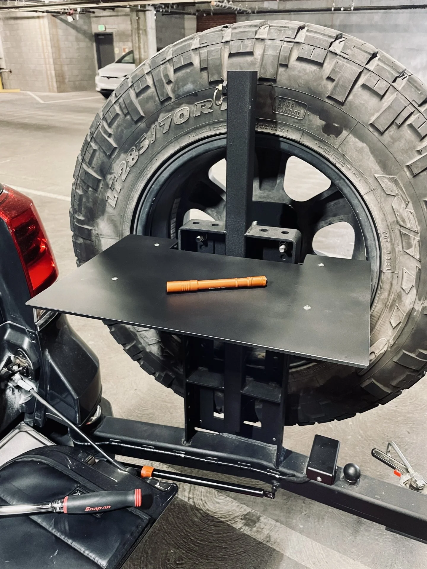

  1. I made a couple flip-up tables for the rear bumper. I had intended for them to simply be prototypes for a to-be-machined-later version but am actually pretty happy with them as-is. The primary challenge is that there's less than 1 inch between the bumper and the tailgate... even less if you factor in deflection from bumper hits. The fancy hinges enable locking when deployed and stowed.

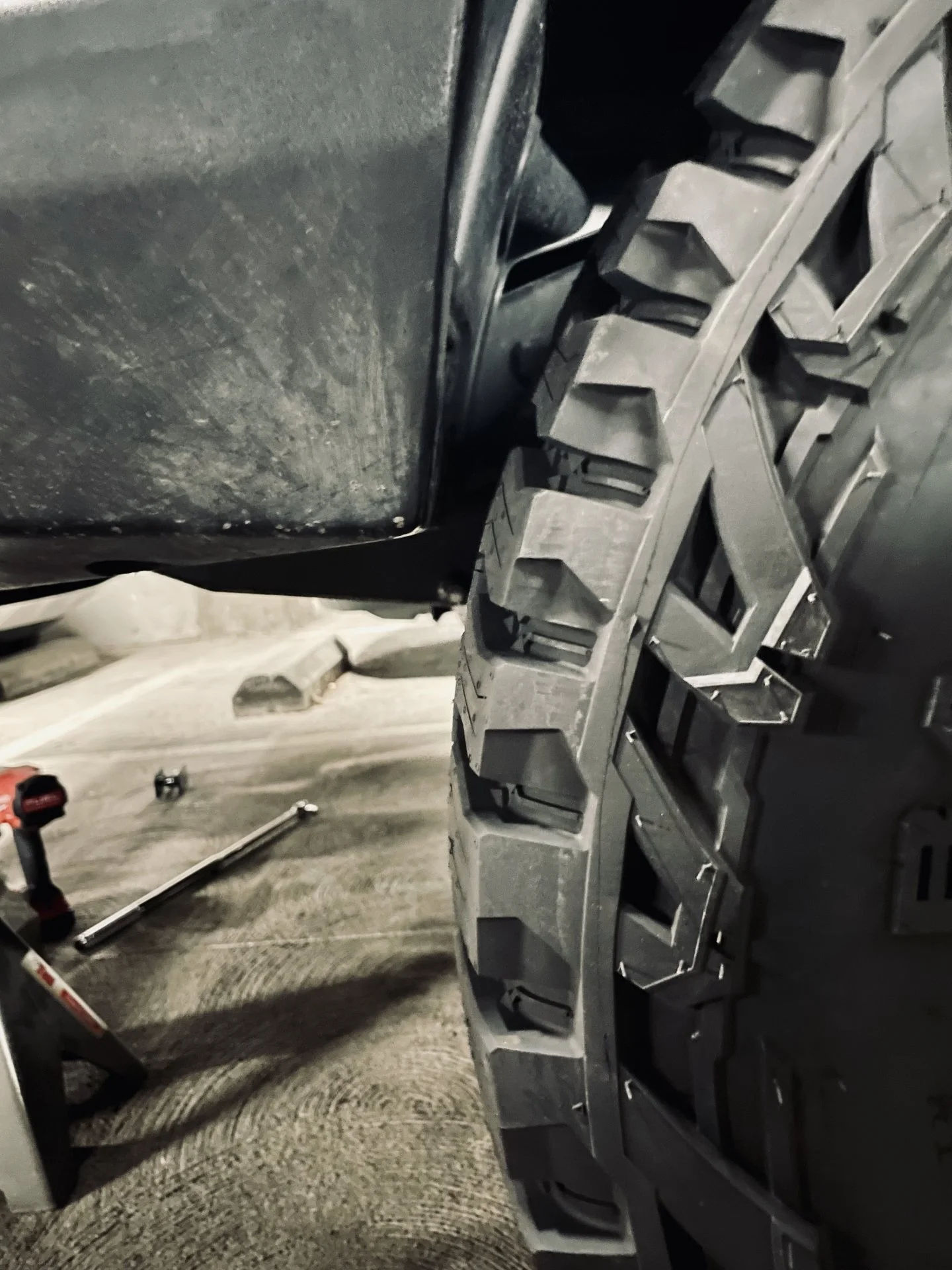

  2. Tires are on! The BBS bronze wheels look great wrapped in some pretty aggressive tires. I have a bit of fine tuning to do in the fender well, but the bigger surprise issue is that the 1-inch spacers are clearly not enough to miss the UCA. I knew it'd be close. I'm considering larger spacers, removing some material from the UCA, or trying some other UCAs. The good news is that the KDSS is a non-issue with the custom spacer. I need to do some wheeling to see if I've removed enough of the body mount material. I'm also very close to rubbing the rear bumper on the passenger side and suspect the thrust angle is too extreme. Guess I'll adjust the panhard.

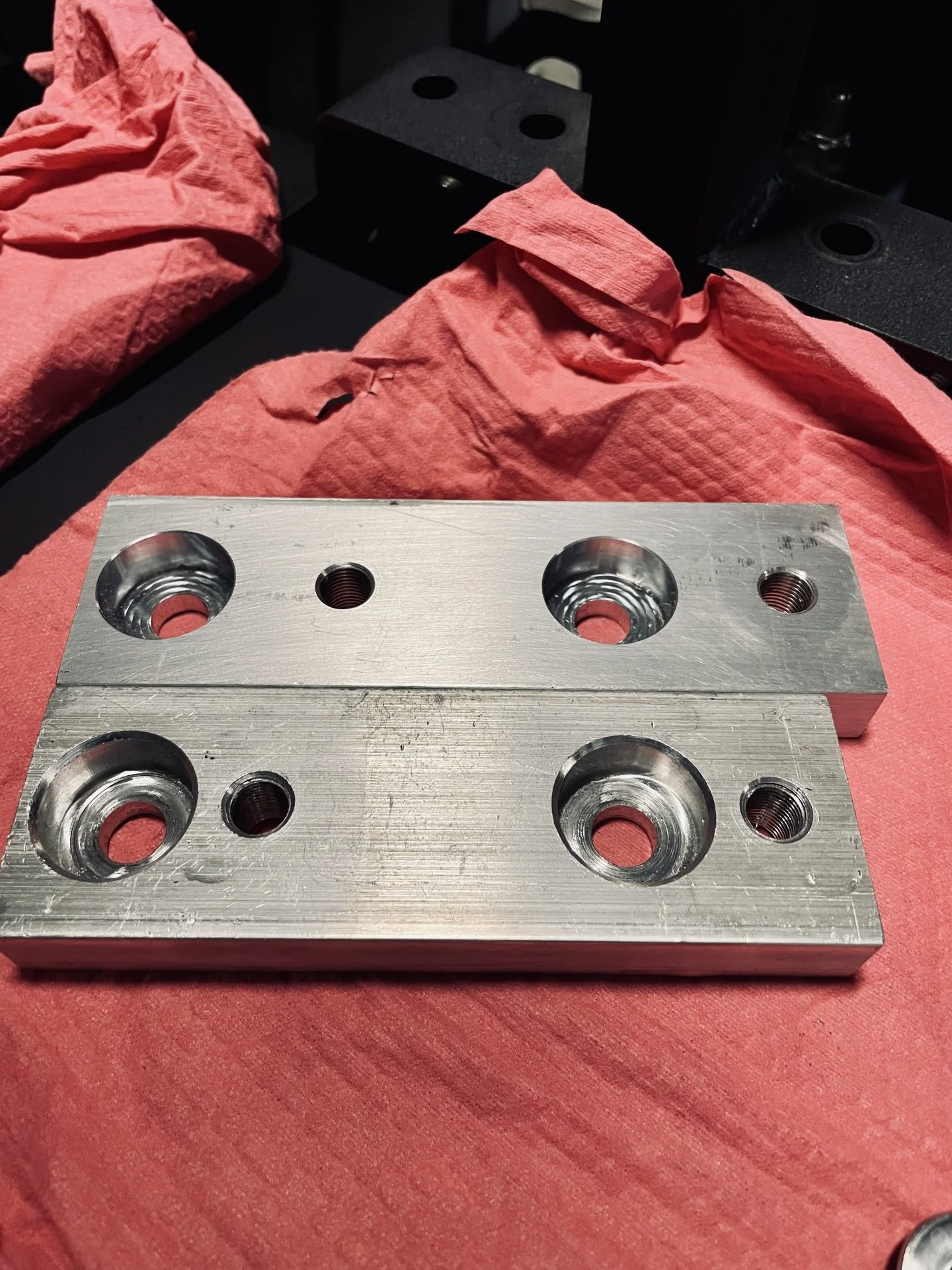

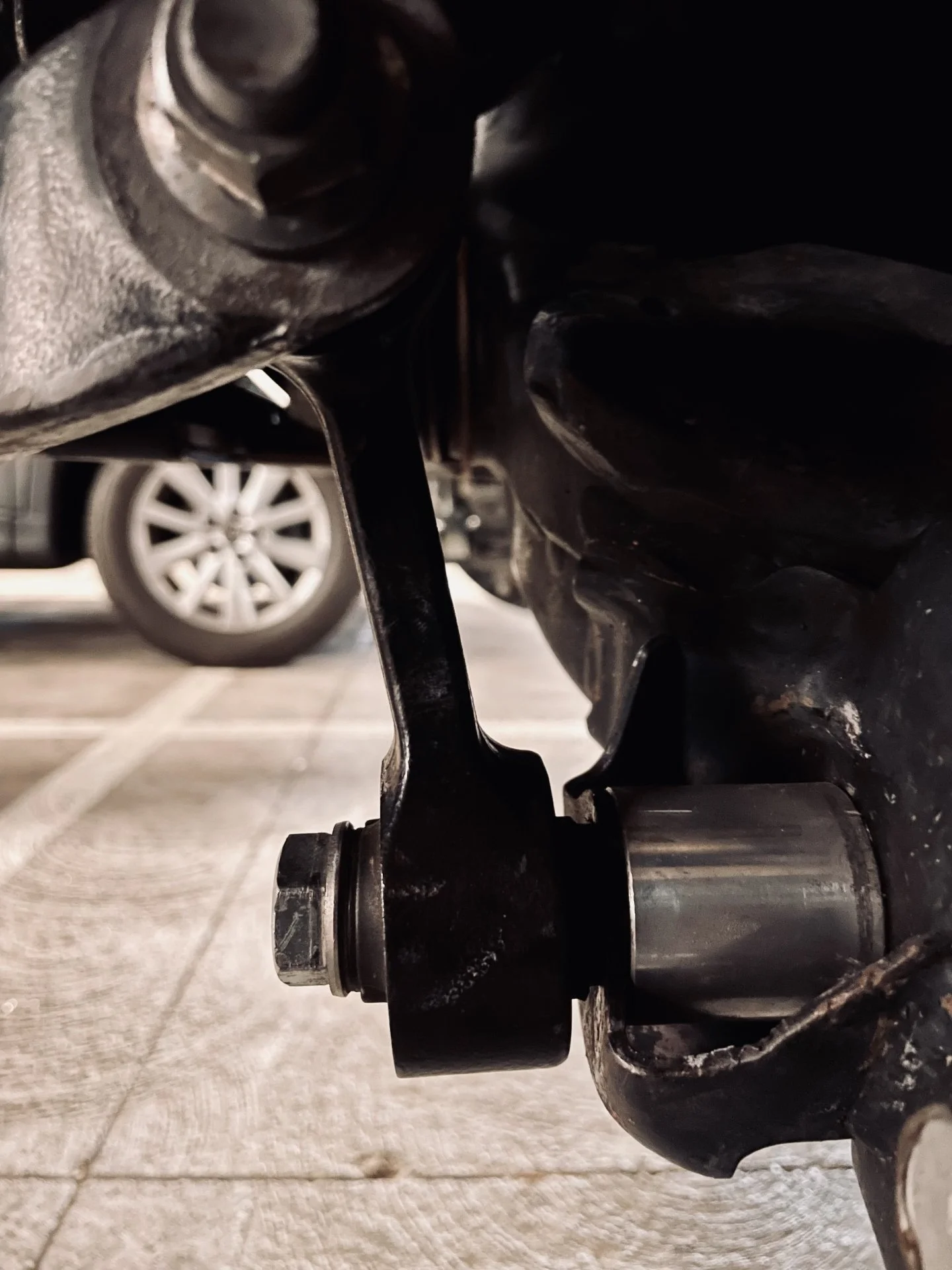

  3. My slightly-tweaked KDSS spacers turned out really well! These push the sway bar another half inch forward (about as far as you can get it) and reduce the stress on the end links if you've already moved the links out of the housing.
  2. Tires are on! The BBS bronze wheels look great wrapped in some pretty aggressive tires. I have a bit of fine tuning to do in the fender well, but the bigger surprise issues is that the 1-inch spacers are clearly not enough to miss the UCA. I knew it'd be close. I'm considering larger spacers, removing some material from the UCA, or trying some other UCAs. The good news is that the KDSS is a non-issue with the custom spacer. I need to do some wheeling to see if I've removed enough of the body mount material. I'm also very close to rubbing the rear bumper on the passenger side and suspect the thrust angle is too extreme. Guess I'll adjust the panhard.
  3. My slightly-tweaked KDSS spacers turned out really well! These push the sway bar another half inch forward (about as far as you can get it) and reduces the stress on the end links if you've already moved the links out of the housing.

Yeah, it started out with just swapping wheels with the existing tires. To be honest, I didn't internalize how dramatic the difference in offset is between OEM wheels and the 20mm Fuel wheels on my old tires. I didn't realize that I'd need spacers even with the 34s to correct the scrub radius and reduce rubbing. At that point, why not look into larger tires? Also, if I'm doing spacers, I may as well go ahead and do a complete brake job, too, right?

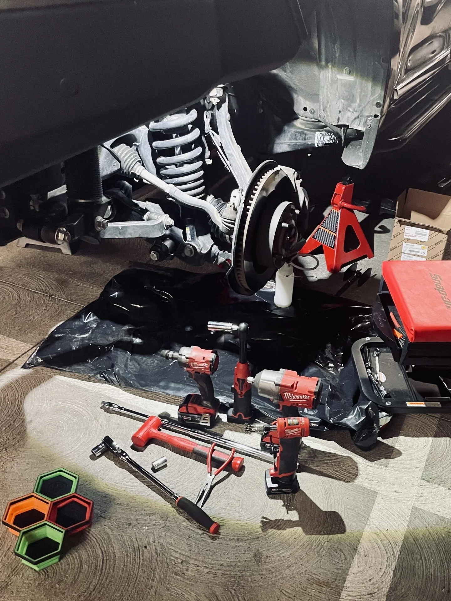

On that note, a few fun facts about doing the brakes for 2016+ models :
  • The repair manual that's passed around these parts is based on the 2013 model year which means the process and torque specs for the hardware don't apply to the 2016.
  • Most critically, the caliper bolts need to be torqued to 133 ft-lb front / 114 ft-lb rear. That's a big difference from the earlier models which were around 75 ft-lb.
  • It looked like the new OEM bolts had some kind of light coating that I presume is a threadlocker? The repair manual didn't mention anything about adding additional threadlocker so I didn't. I'll update this post if I discover any new information. I'm thinking about going back in and adding a bit of blue.

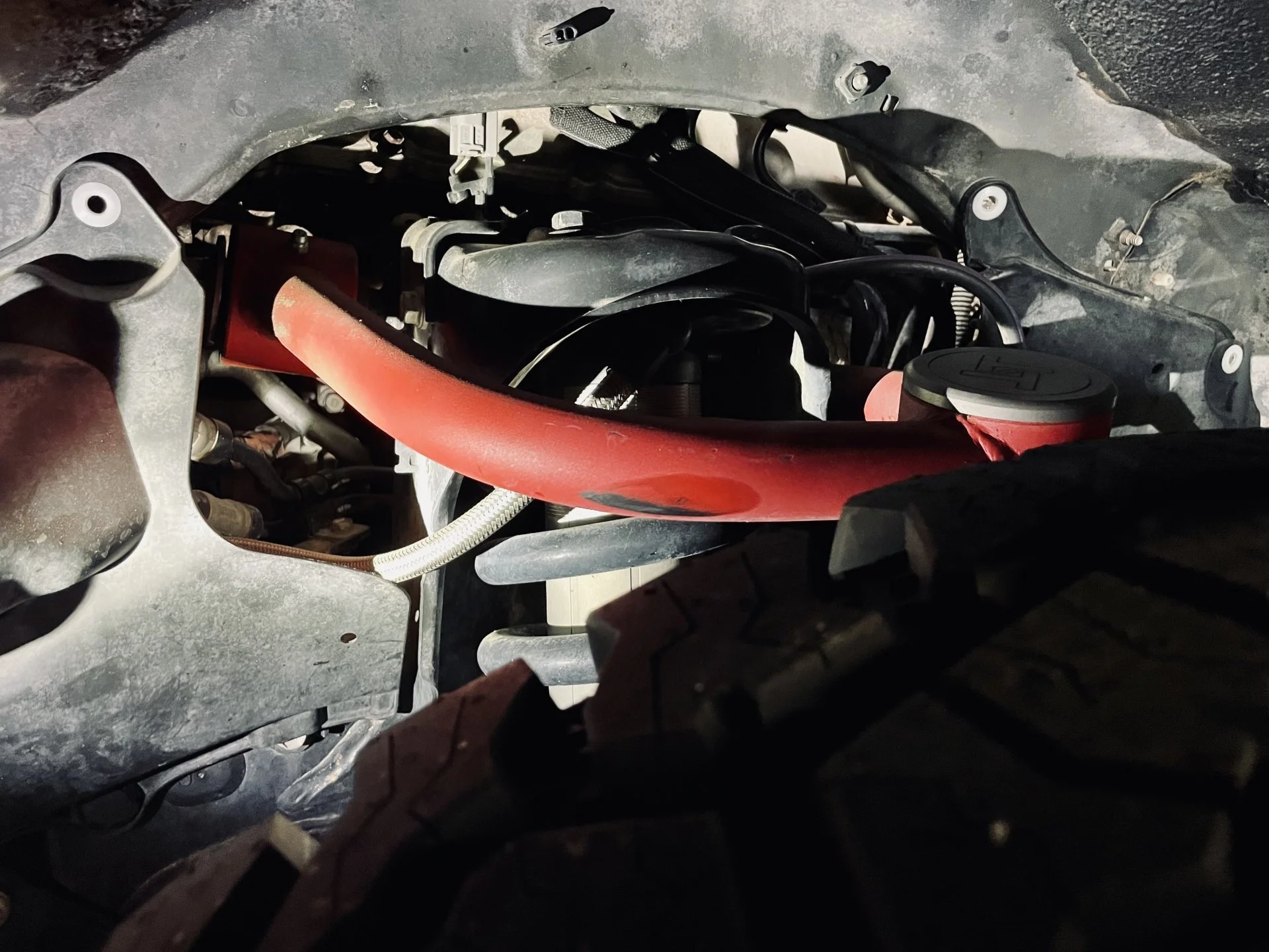

Re: tire fitment... so far no issues during city driving aside from the UCA rub which I do need to sort out. I'm running 1 inch spacers. 1.25 may be enough to eliminate the UCA rubbing. I also have some additional fender liner molding to do but had already done quite a bit in advance. I also have a likely clearance issue with the rear bumper.
mind showing the fancy hinges?
