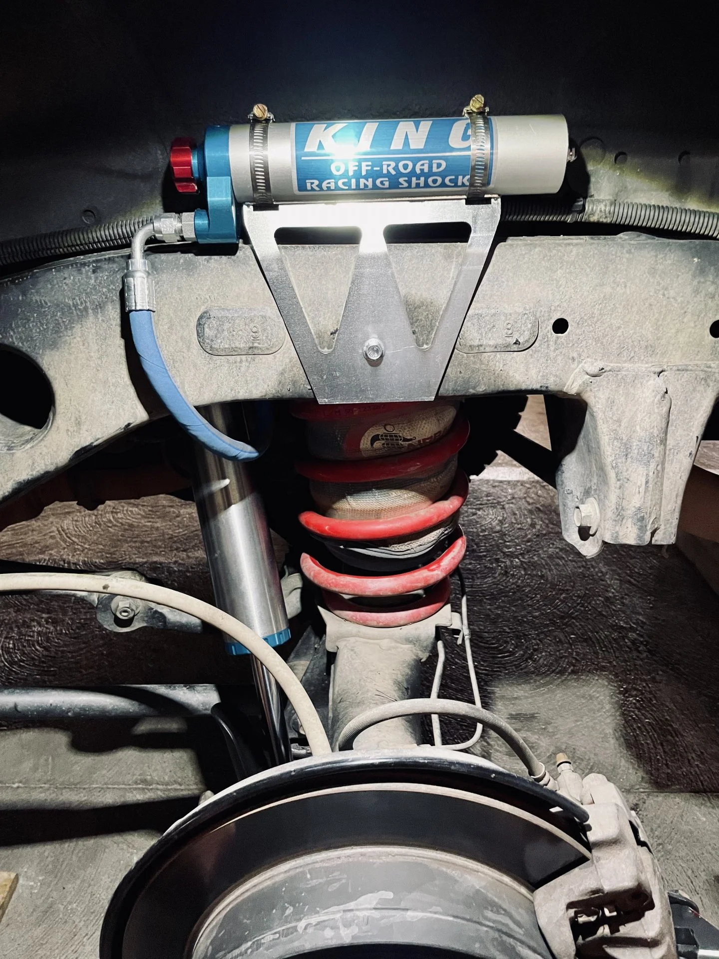

New Suspension!

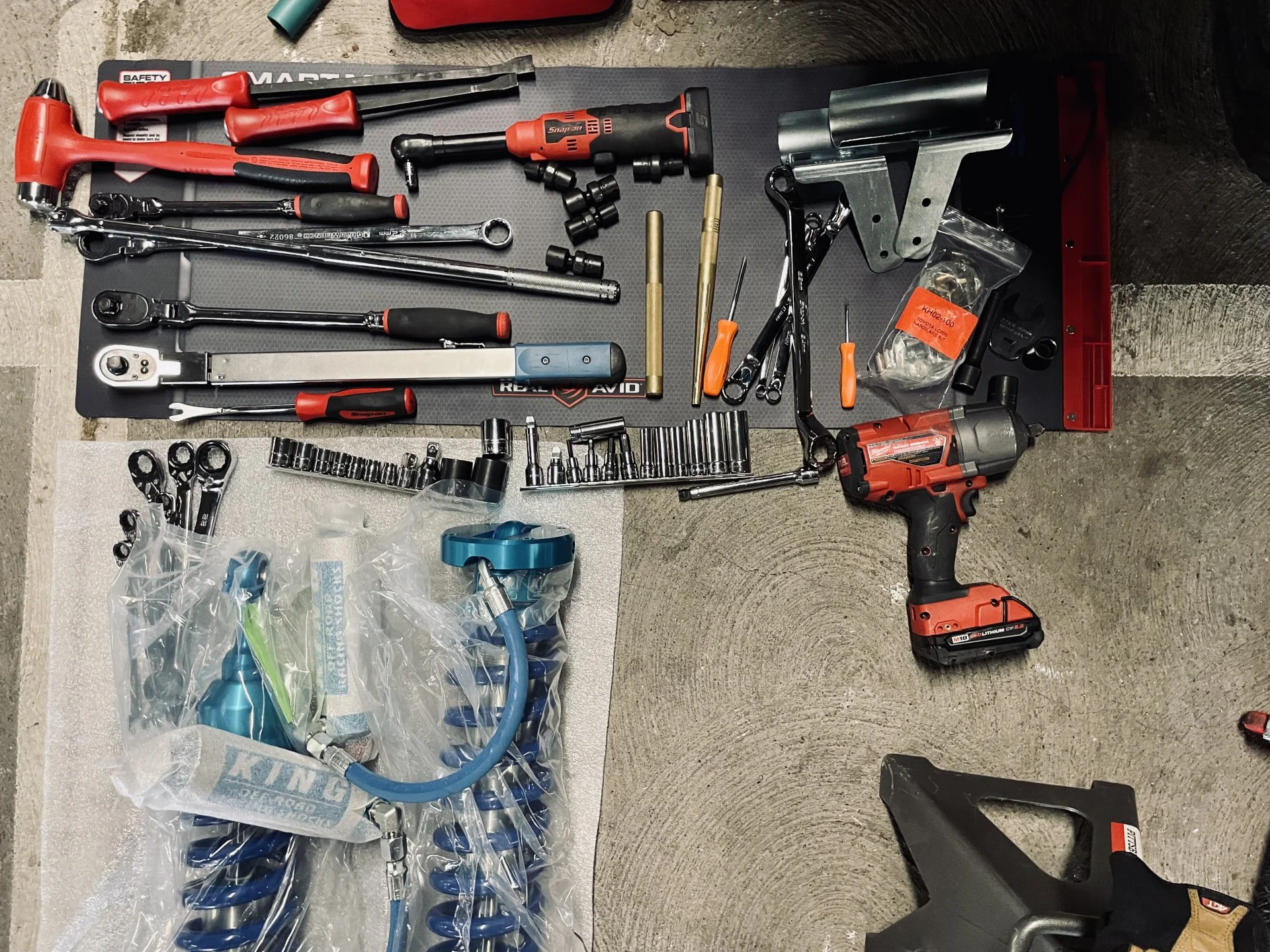

I had a couple boxes from Filthy Motorsports waiting when I returned home. I'd hoped to get these installed professionally but as many of you know shops are very, very busy and are generally short-staffed. I took this as an invitation to do it myself. In a parking garage parking space using only the tools I carry in my truck plus a jack stand. What could go wrong? Installing suspension components is a new adventure for me. I do a lot of DIY stuff on the truck but am really only comfortable with electrical.
Ultimately, I spent around 4 hours on the front on Saturday and 2 hours on the rear today. I only swapped the struts/shocks and kept my UCAs (but greased them) and rear spring + airbag setup. For the front, I followed @crikeymike's instructions to let the LCA drop by disconnecting it from the hub. Aside from the strut, the only other component I needed to remove was the sway bar. It worked out pretty well... I even had relatively good luck putting the sway bar back on as the last step. Naturally, my alignment is in pretty rough shape now but I only need to travel about a mile to the alignment shop.
I'll chime in with some thoughts on the new setup compared to BP51s once I get an alignment and some wheel time.

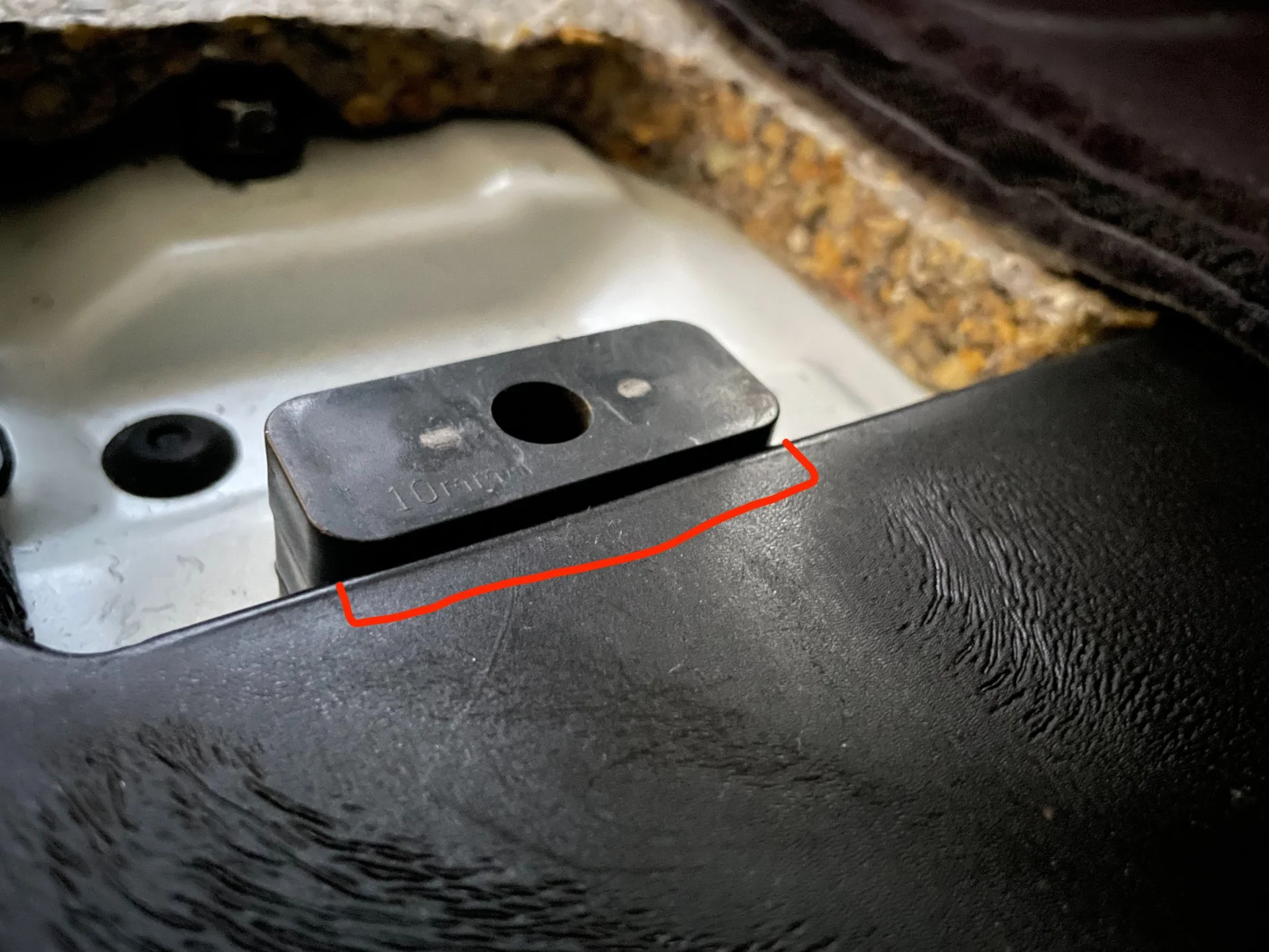

@indycole It's been a while, but maybe you remember. Is there enough material to safely Dremel off the ducting to fit the spacer like so?
Yeah, just pay attention to what’s underneath. If I recall it’s just a bit of a lip so there was little risk of penetrating the duct. Good luck!

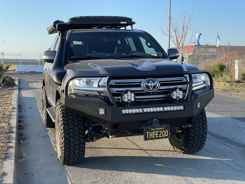

It's been a while since a meaningful build update. We were fortunate to enjoy some long weekend trips in this fall and early winter — a few visits to Tahoe, the North Coast, Los Padres, and Joshua Tree. Most of the trips were soft-roading, but we did hit some legit trails on occasion (cheers to @TLC2013, @1world1love, and @psnyman).

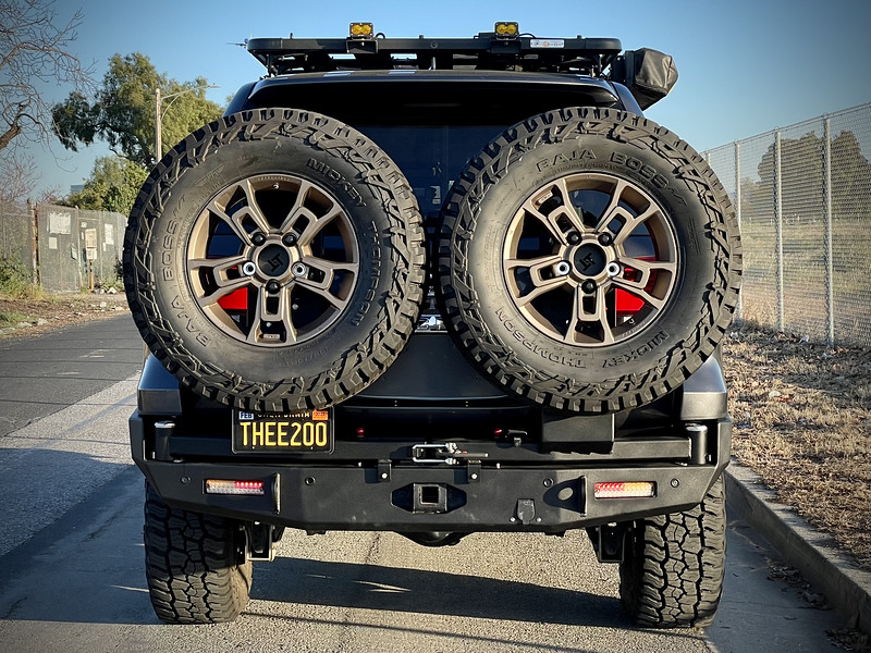

I dropped the truck off at Jason's (@TRAIL TAILOR) in November for some modifications to the rear bumper to help my tires and to re-powder coat both the front and the rear. Ultimately, we decided to simply refresh the front with new powder coat, a small connector skid between the bumper and the Budbuilt skids, and a larger 12k winch (moved up from the 9.5k.
However, for the rear, we elected to do a complete rebuild. The oversized tires were rubbing pretty badly on the old bumper and the geometry needed to change enough that it made sense to start from scratch. Here are a few of the changes:
  • More clearance between the rear bumper wings and the rear tires
  • Slightly taller wings with modified geometry to improve clearance
  • Corner parking sensors relocated inward to reduce the chance of damage
  • Bottom lip curved upward a bit to improve departure when scraping over rocks
  • Eliminated full underside plating on the wings to reduce weight and increase access
  • Dual locking pins per swing arm instead of one pin and a locking strut
  • Trailer connector integrated into the bumper
  • Swing-arm mounts offset a bit so they could be taller to move the tires up so there's more room for the license plate and a view angle for the rear camera
I'm incredibly pleased with the changes and working with Jason was a pleasure as always. I picked the truck up a couple weeks ago and can't wait to break the new armor in on the trail. He also upgraded my rear LCA skids with a new, beefier version. (Minor note on the timing: I dropped the truck off earlier than the work was scheduled due to vacation and made it clear that I didn't need it back until February due to other travel commitments)

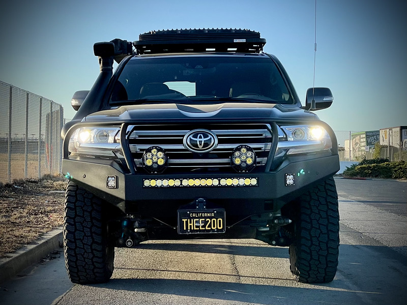

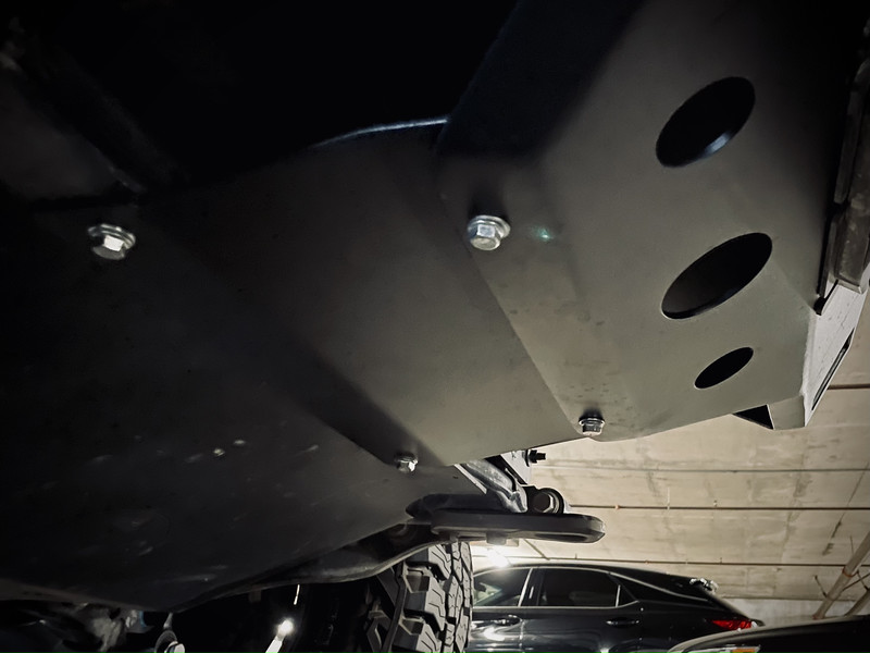

Connector skid between front bumper and Budbuilt engine skid
Front bumper
Another shot of the front bumper showing the results from replacing the 1.25-inch Spidertrax spacers with 1.5-inch Bora spacers to help reduce UCA rubbing
No more rear tire rubbing on the bumper
New corner geometry
Offset swing-arm mounts
Rear bumper

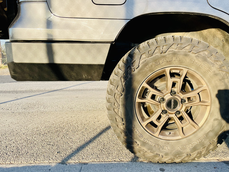

Moving from 1.25 to 1.5-inch spacers definitely improved most of the remaining rubbing from the tires in the front. There's just the slightest bit of rubbing on the UCA. I expect I'll be able to live with it but need to gather some more data.

how are you liking the Baja Boss ATs? I need to replace 2 of my 305/70/18 KO2s, however they are "backordered" everywhere. My options are to jump over to your Bajas or downgrade to a 295/70/18 🤷‍♂️
They're great though I'm not sure I'd jump into this size again. I didn't expect to have such a hard time fitting them.
Everyone says the KO2s run small... any idea how the Boss measures out when loaded on the rig?
Also, I saw that you had Ridge Grapplers - did you have issues with them? they don't make them in 305s, so I'd have to get them in 295/70
What UCAs are you running @indycole ? I've had to clearance my stock UCAs for wide 35x12.5s, but always though aftermarket UCA would provide more clearance. Surprised you're still getting contact with larger spacers?
Rigs looking as finer than ever.
I haven't measured the tires since they were unmounted. I'll do that. Visually, they look comparable to other 35s. I had no issues with the RGs though they did seem to lose more chunks of tread than other tires I've used over the years.
Thanks! I'm using Jason's Trail Tailor UCAs with built-in 3 degrees of positive caster (I think that's right) but with no other adjustability. They're beefy, easy to maintain, and have performed well; however, I may swap in the SPCs I have in storage for comparison.
Practically speaking, though, the amount of rubbing is quite minimal after moving to the 1.5 inch spacers. It's more than tolerable. It's just that among the trimming, BMC, moving around the swaybar/end inks, larger bump stops, a redesigned rear bumper, and trying out 3 types of spacers I'd like to resolve 100% of the contact. Then, I'll be in a good position to consider a larger tire and repeat the process, lol. (joking)

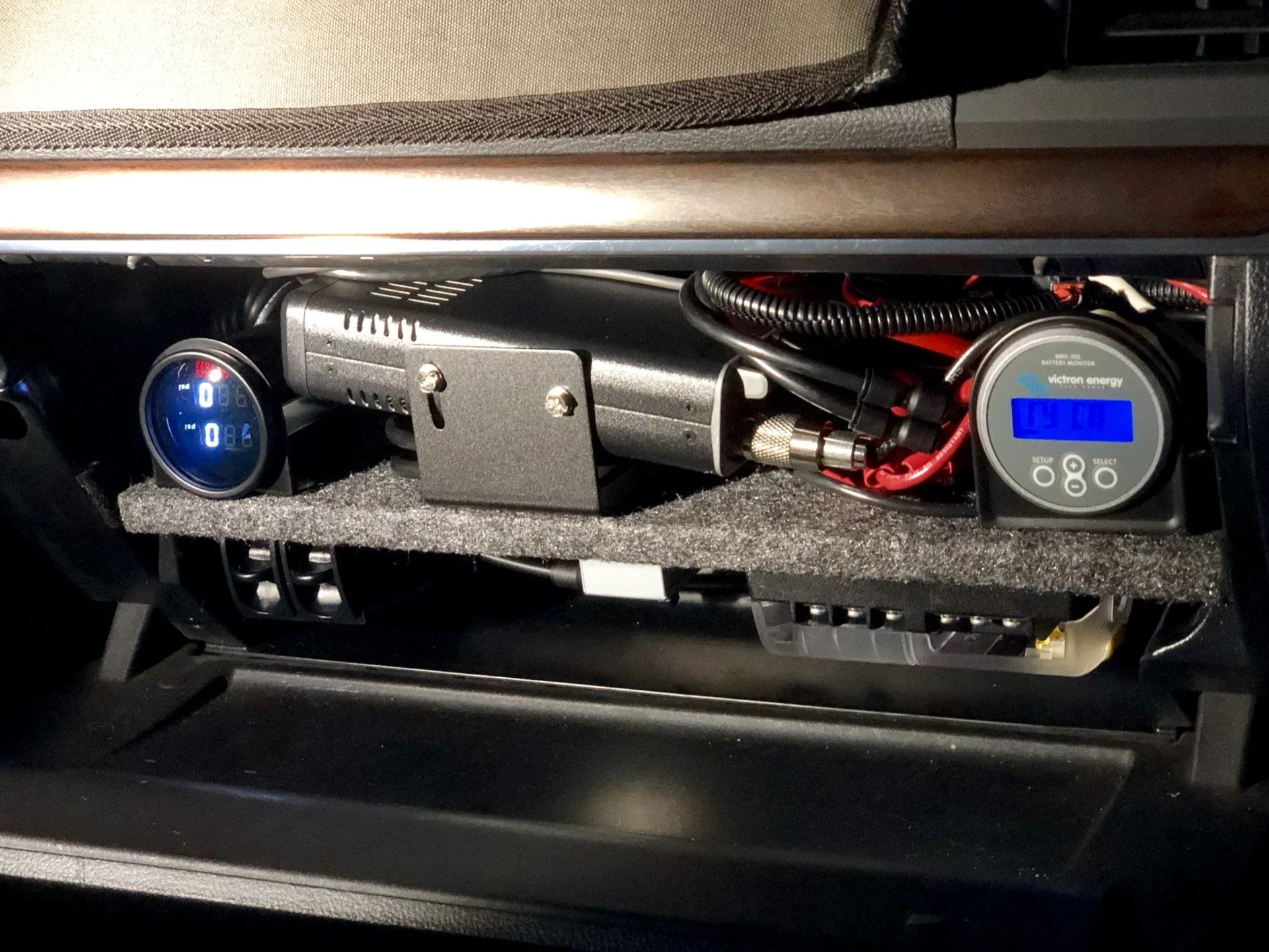

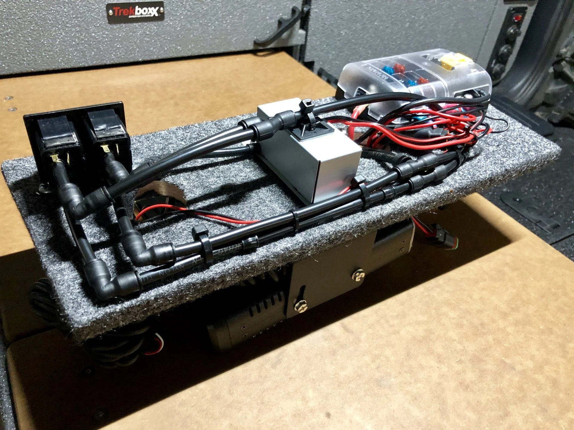

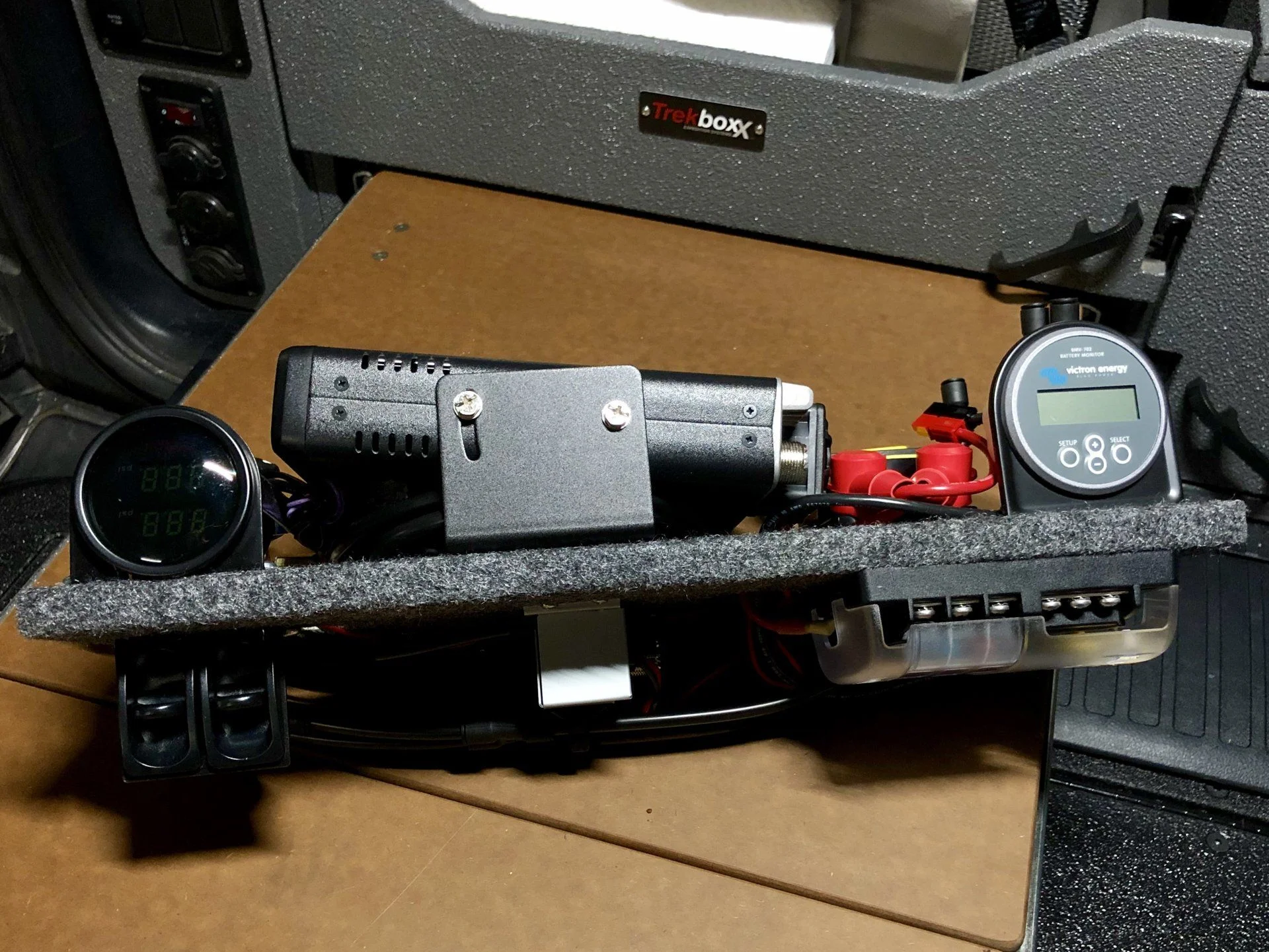

In today's episode of "one thing leads to another" I replaced the plastic glovebox shelf with some baltic birch plywood wrapped in boot liner. I followed the same contour as the plastic shelf and lined the inside of the glovebox shelf ledge with felt tape on the walls and velcro on the ledge itself to keep the shelf in place.
Why? Well, I'm working on installing rear coil helper airbags and went with the full control system to set each bag pressure independently from the cab. I'm hoping to use the airbags for a bit of leveling help for the RTT (though I'm skeptical that I'll get that much height differential). The control setup requires placement of a couple paddle switches (left and right airbags) and a 52mm gauge. A while back I stopped storing stuff in the glovebox and began using it as a compartment for mounting electronics — radio head units, battery monitoring, sat phone, etc.
In order to make room for the airbag control kit, I needed a more flexible mounting surface than the plastic shelf. I also wanted something that was serviceable and easy to disconnect. I also upgraded from bus bars to a fuse block + circuit breaker and replace my two National Luna battery monitors with a Victron BMV-702 that monitors the capacity, amp draw, and instantaneous power consumption of my aux battery (as well as the voltage of my starting battery).
The glove compartment now has 3 air lines running into it, 12v power from the aux battery, dual USB charge circuit, the ham radio, the CB radio (had to reinstall it for Cruise Moab), power for the rear view camera, the airbag control gauge and switches, the battery monitor, and I left some space for a Redarc trailer brake controller. The wires and air lines may look a bit messy when installed in the glove compartment but it's par for the course as they're service loops so I can pull it in and out without stressing the cables.
