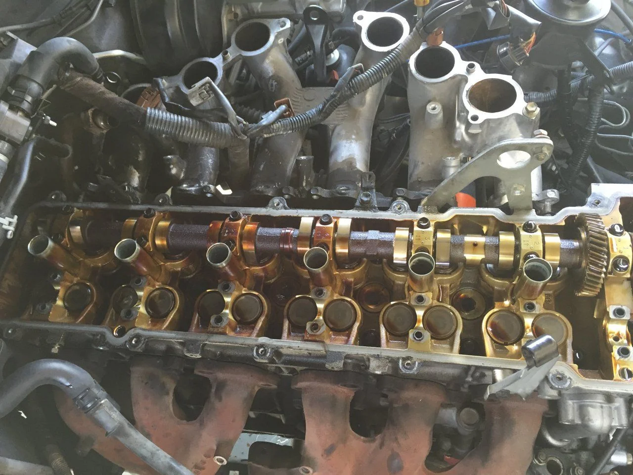

Exhaust cam out. I have never done this before personally, but it was actually a lot easier than I thought it would be. FSM is an absolute must though!

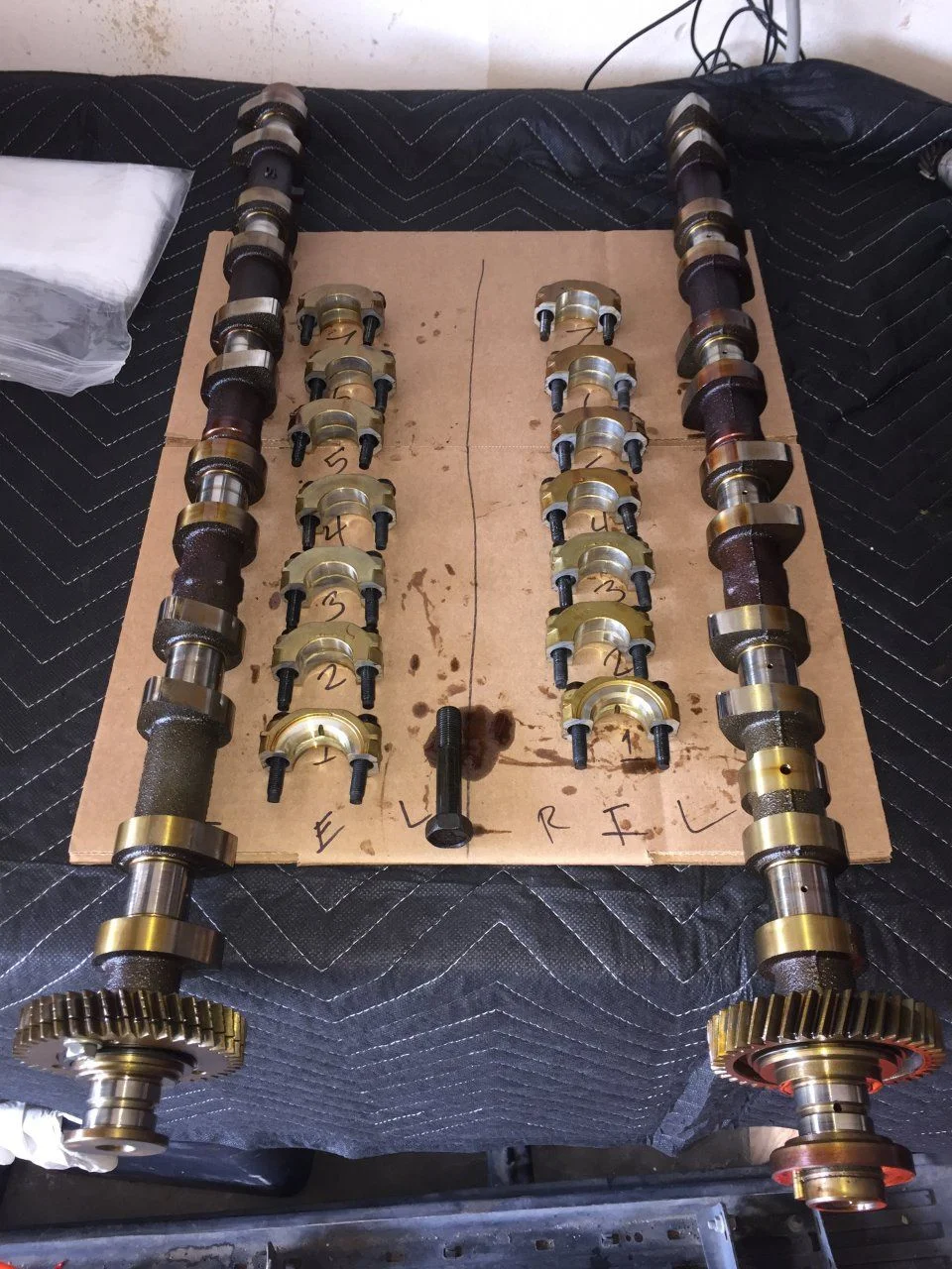

Both cams out, I was surprised at how good everything looked!
Cam caps are numbered anyways, but better to photo and label everything just to be safe
