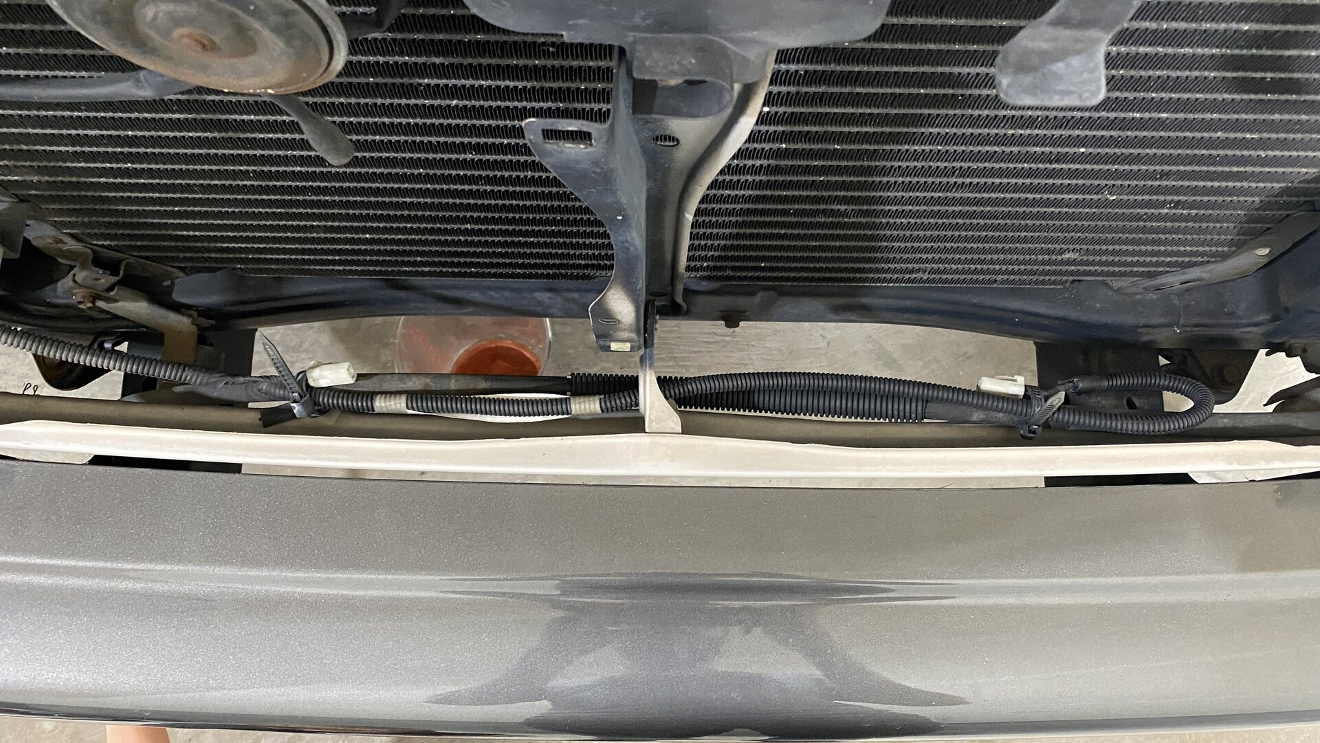

Started to prep for the intercooler install by dismantling the front end. Cleaned up the bugs and rocks on the AC condenser and straightened out bent fins.

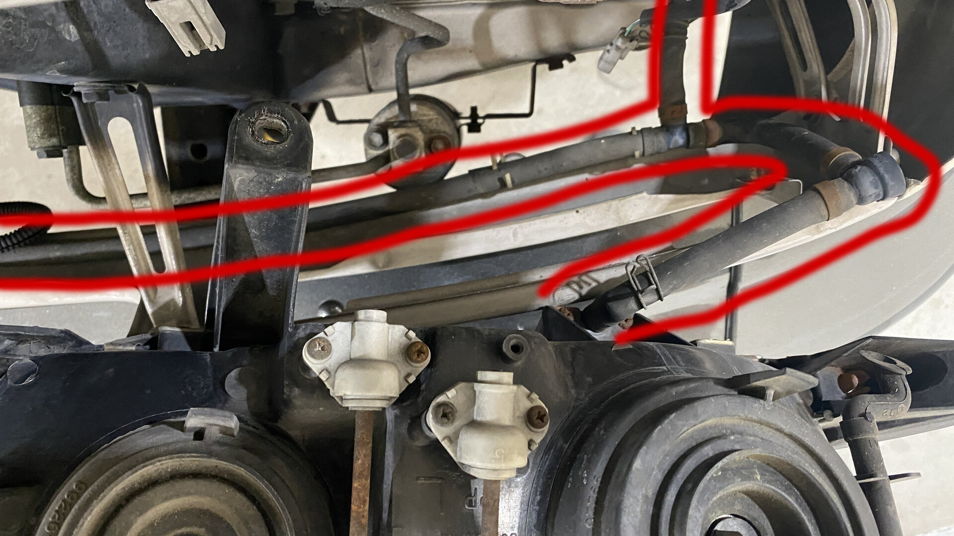

I'm also considering deleting the JDM headlight washers since I never use them. I'd leave the nozzles on the front since they're a part of the housing, but remove all the hose behind the grill. Just trying to simplify things.
This is standing in front of the bumper looking down. The hose is outlined in red and connects to the bottom of the headlight housing.

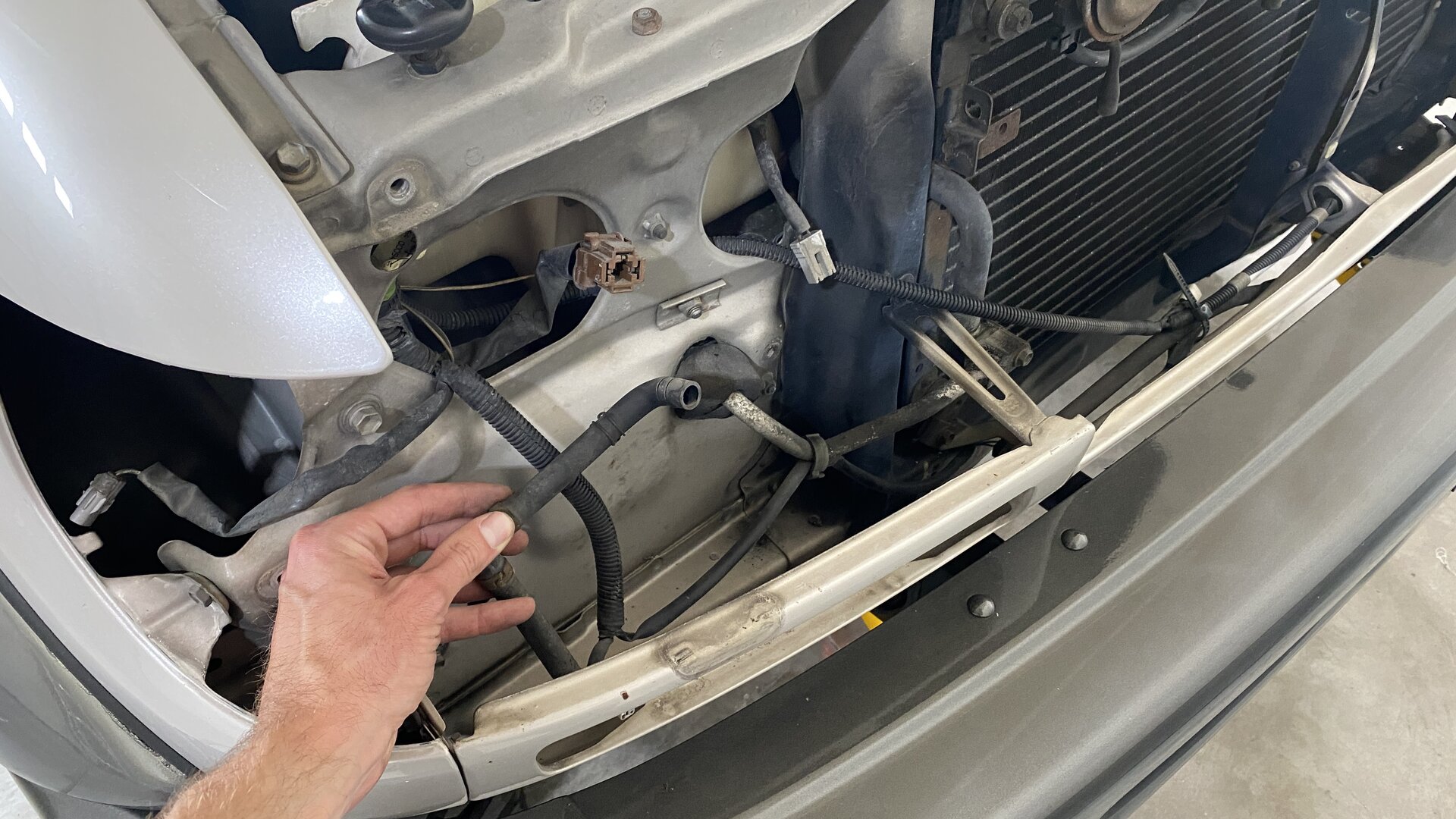

Additionally, I need to do some digging in the EWD and figure out what this wiring harness is tucked behind the grille. It has two unused white plugs and runs back up to a connection underneath the airbox + a ground. I've removed it for now but will hang on to it.
I'm thinking fog lights? I don't have fog lights in the bumper but I do have integrated fog lights in the headlight housing.

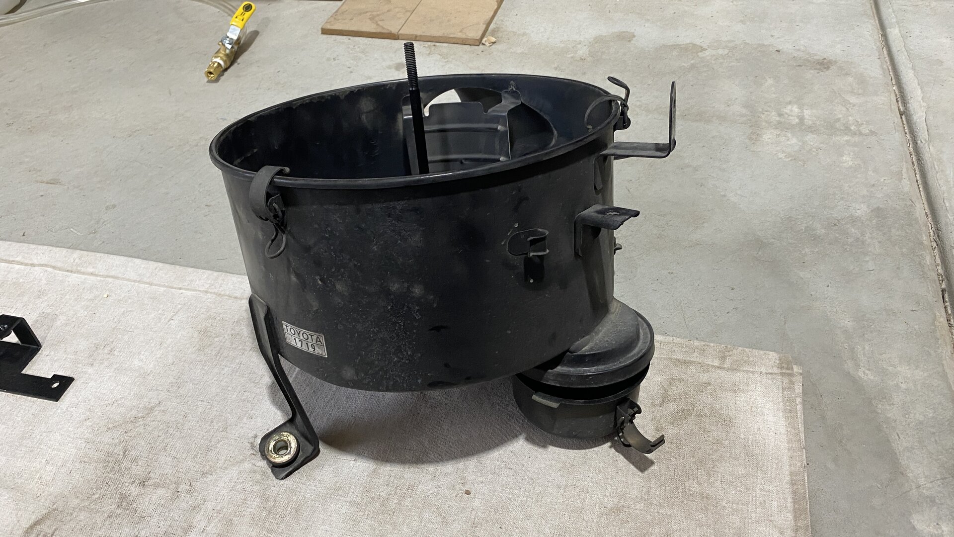

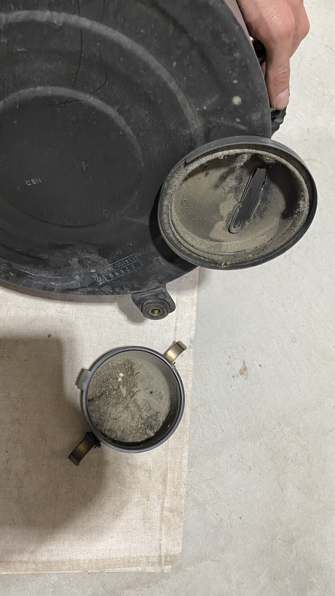

Disassembly continues - I hadn't removed the airbox before and was interested to find this little dirt/dust/debris catch can at the bottom. Seems effective. How often are people cleaning these out?

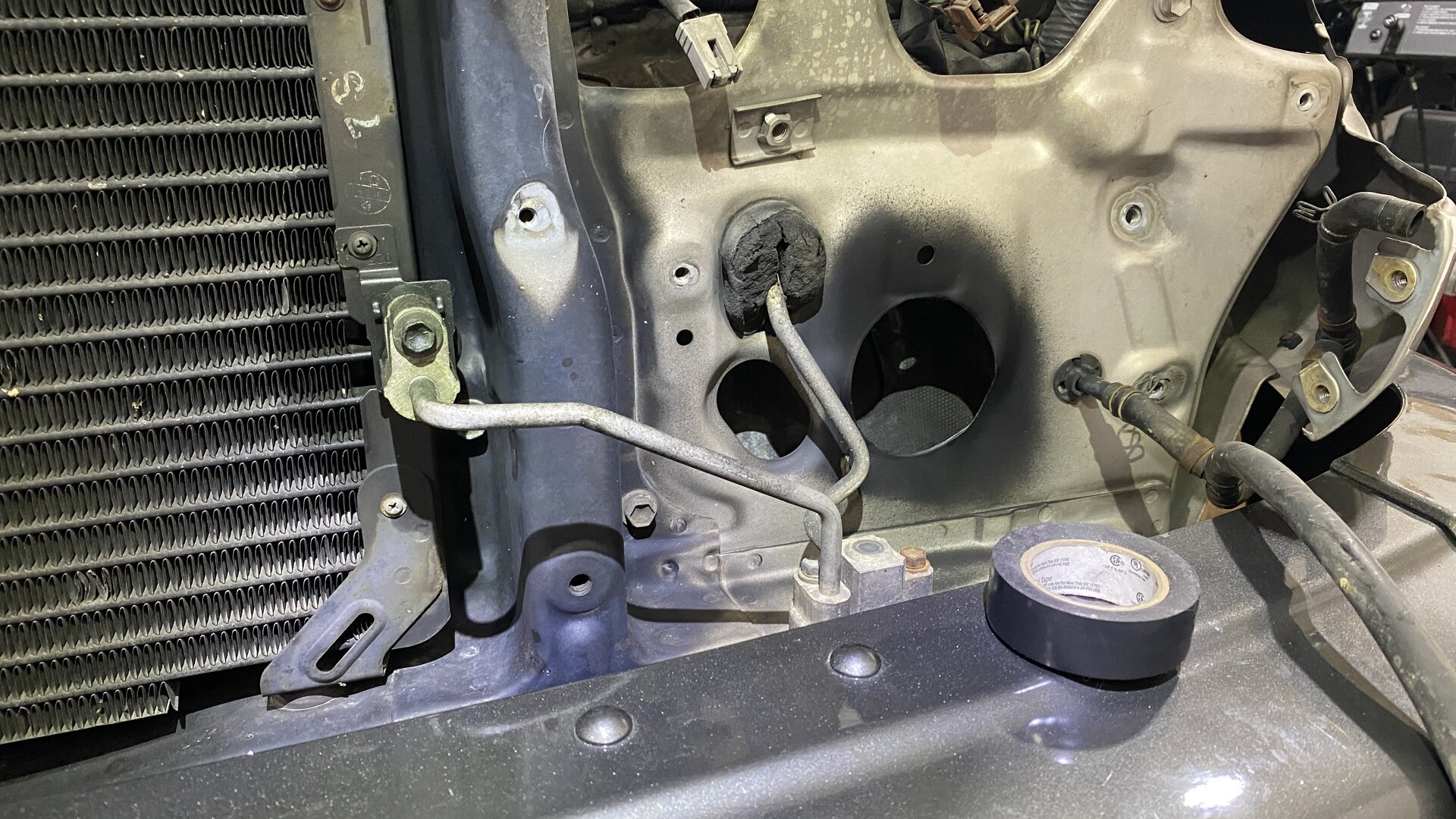

Ran into my first snag. The glow heater relay assembly is positioned exactly where the driver's side intercooler pipe is supposed to go.
This is standing in front of the bumper on the driver's side looking down.
The relay is right behind the circled panel. PDI instructions are to cut a 3" hole in that panel to run the piping through.
I'll post in the diesel section as well but curious to hear what people think. Move the relay? Delete the glow heater system altogether?
When I installed my DVS bumper I didn't realize they had one specifically for the JDM rigs and deleted all my headlight washer setup except for the button inside
Nice. How did you plug up the system? At the windshield fluid reservoir?
Ya. I'll grab a picture in the am. Pretty sure I just put a rubber cap on it. I kept all the parts in case I wanted to restore it. But I'm moving soon and foresee them in the trash.

That's the tuna can.
Empty each time you change your oil so it doesn't get forgotten

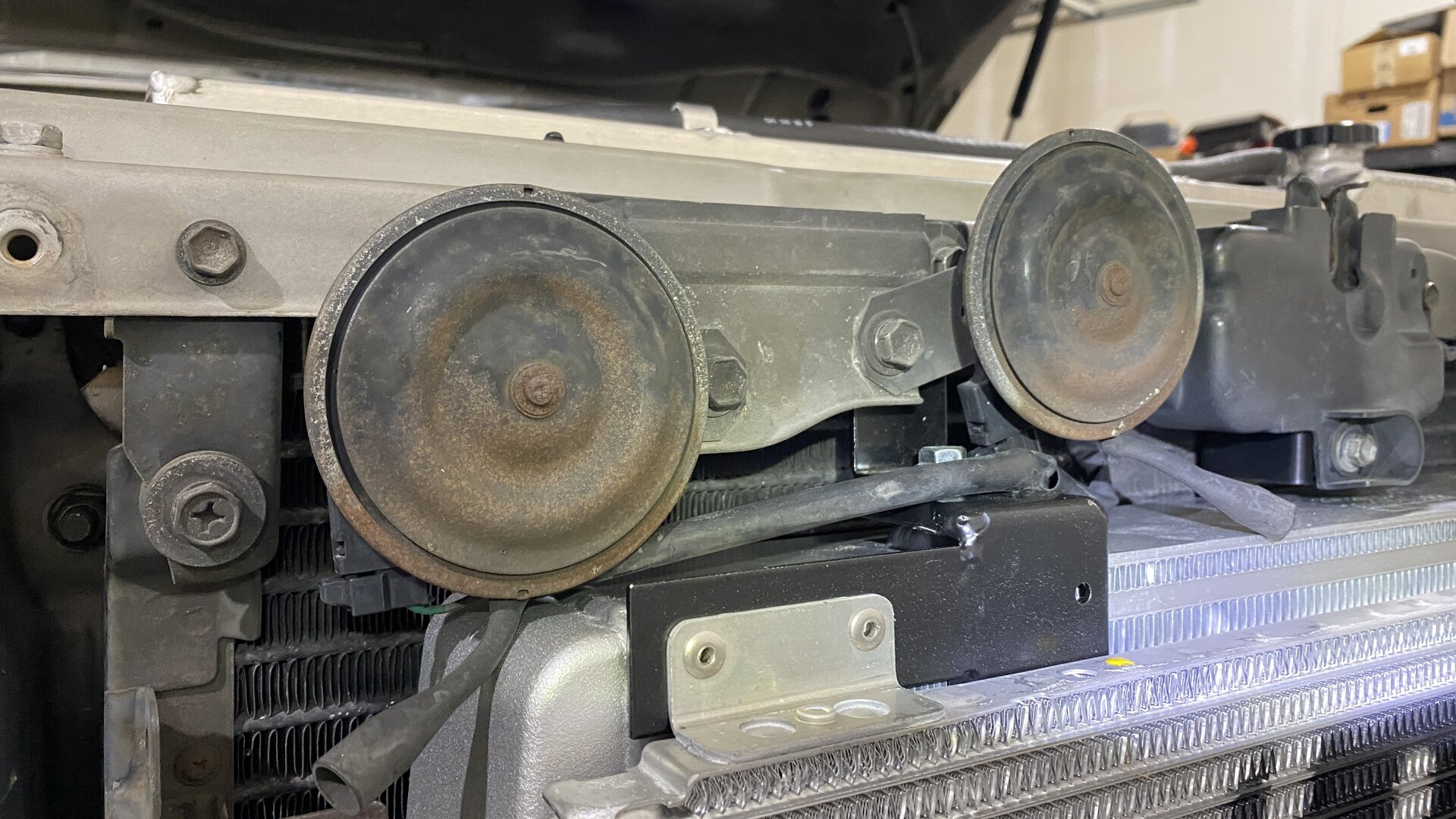

Once that was ready to go, it was as simple as bolting up the hood latch, dropping in the intercooler, then bolting up the hood release and horn brackets.

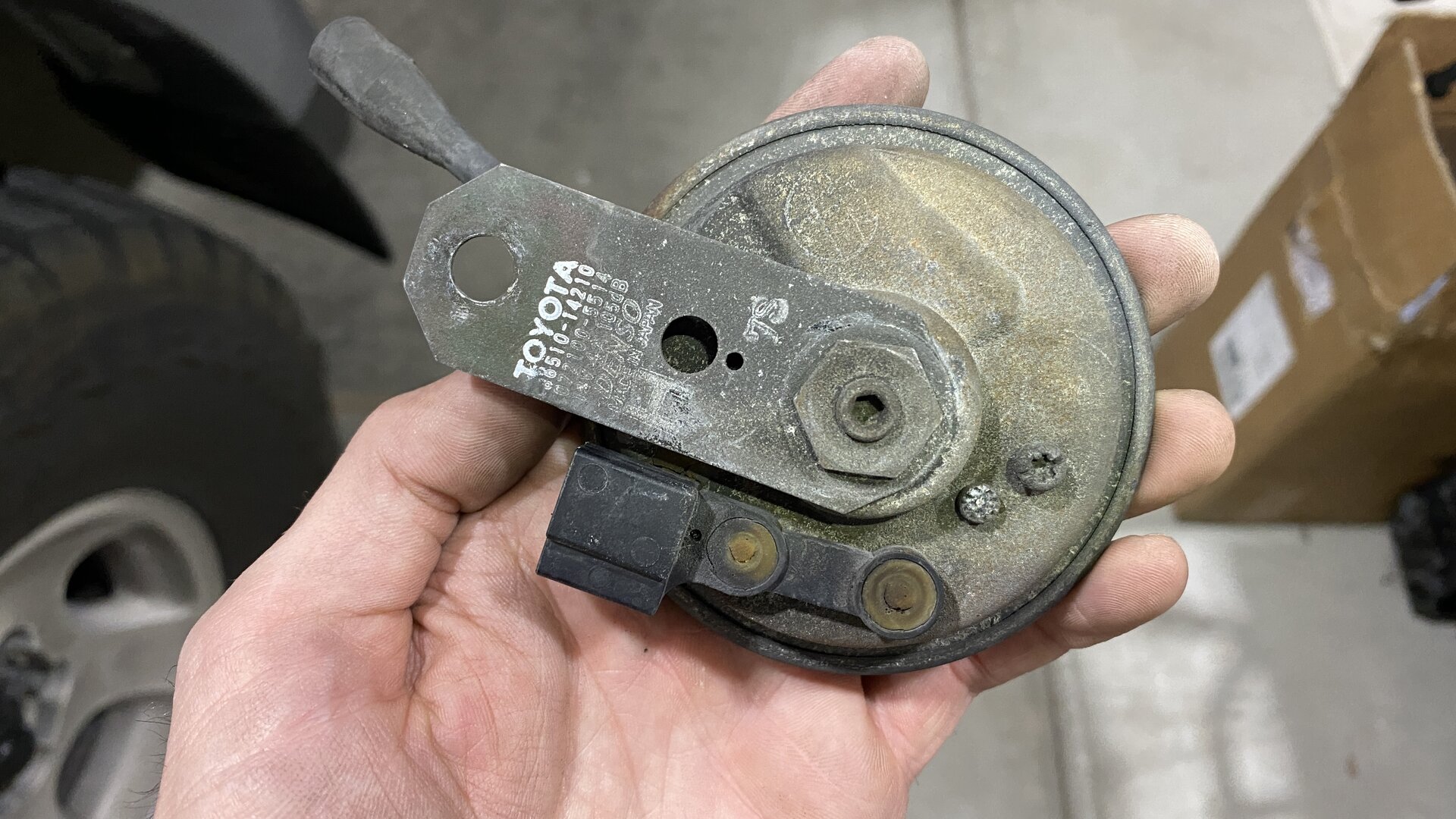

Small note on the horns. The right horn had to be moved up a little to clear the intercooler bracket, but that put it up too high and the hood couldn't close.
On the back of the horn, there's a 17mm nut holding the arm. I loosened that and rotated the horn to fit under the hood.
And wrapped up the night with some trim (provided by PDI) around the intercooler pipe holes.
