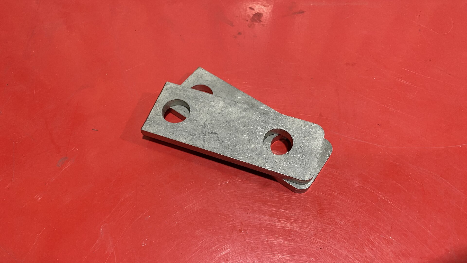

- Got the Trail Tailor 3/16" spacers. I think I've figured out the rear recovery points. Just needed to chop 6mm off to fit.

The bolts supplied are M12x1.25 40mm. I almost have enough engagement but not quite. Going to order 4x 50mm bolts to be safe

I'm wondering if it messes up my departure angle too much. But I guess a tow hitch would be similar?
I'll probably paint them black and run it for a while til I get it hung up on a ledge and/or buy a steel bumper. I've already had to use the front points to pull another 80 out of some snow and it would be much better to be able to use the rear. It looks large but realistically it's going to drag about the same time the exhaust hits something.

My tow hitch hangs down way worse. I think you're fine.
Yeah I think I was spoiled with how "high clearance" this is stock with no spare tire and no tow hitch.

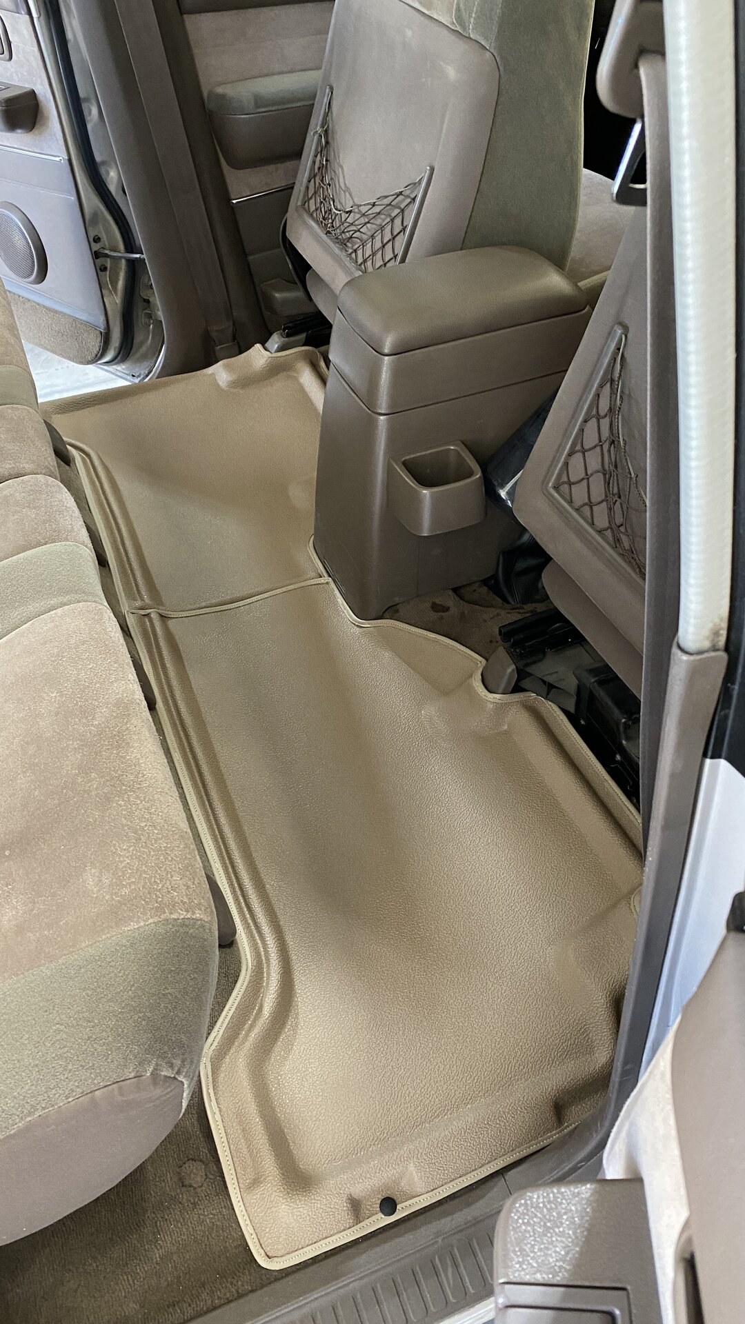

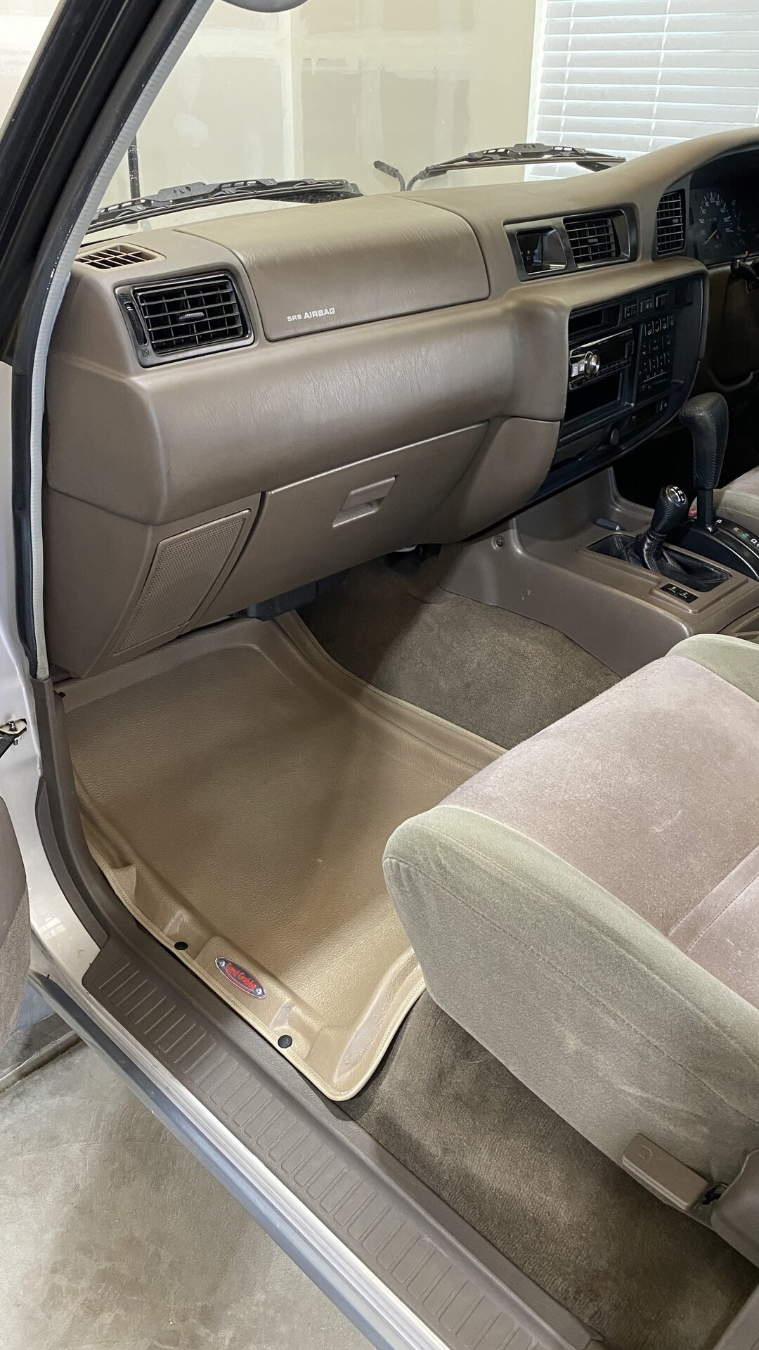

Big improvement to the interior today - Sandgrabba mats showed up. The quality and fit are great. Similar material feel to a Weathertech floor mat, but maybe a little harder to the touch.

The mats have these tabs underneath that can rotate around - I assume they're for sliding underneath the door trim to hold them in place but I don't know if I'll use them. They seem to stay in place just fine.

I ended up finding these through No Bull Accessories in AU. They didn't have international shipping on their site so I worked things out with Brad: brad@nobullaccessories.com.au
I paid on April 3 and received them on May 31. Very happy overall.

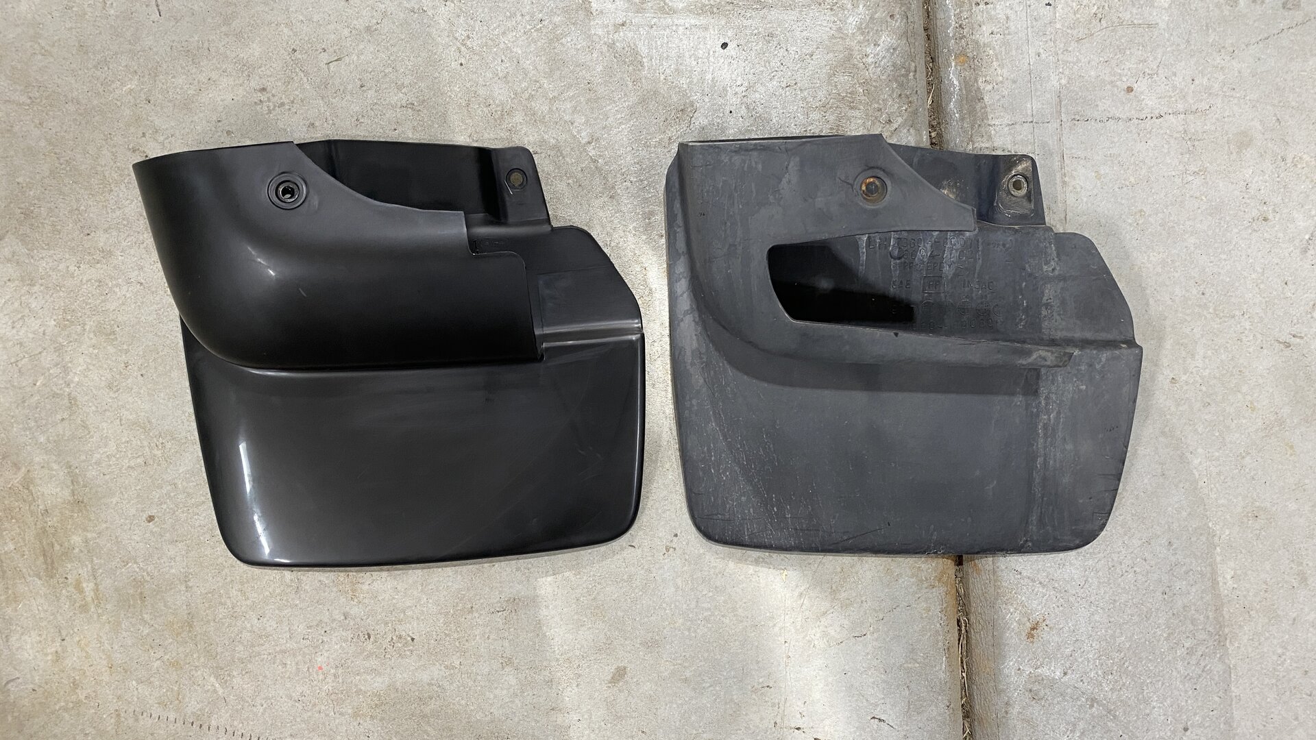

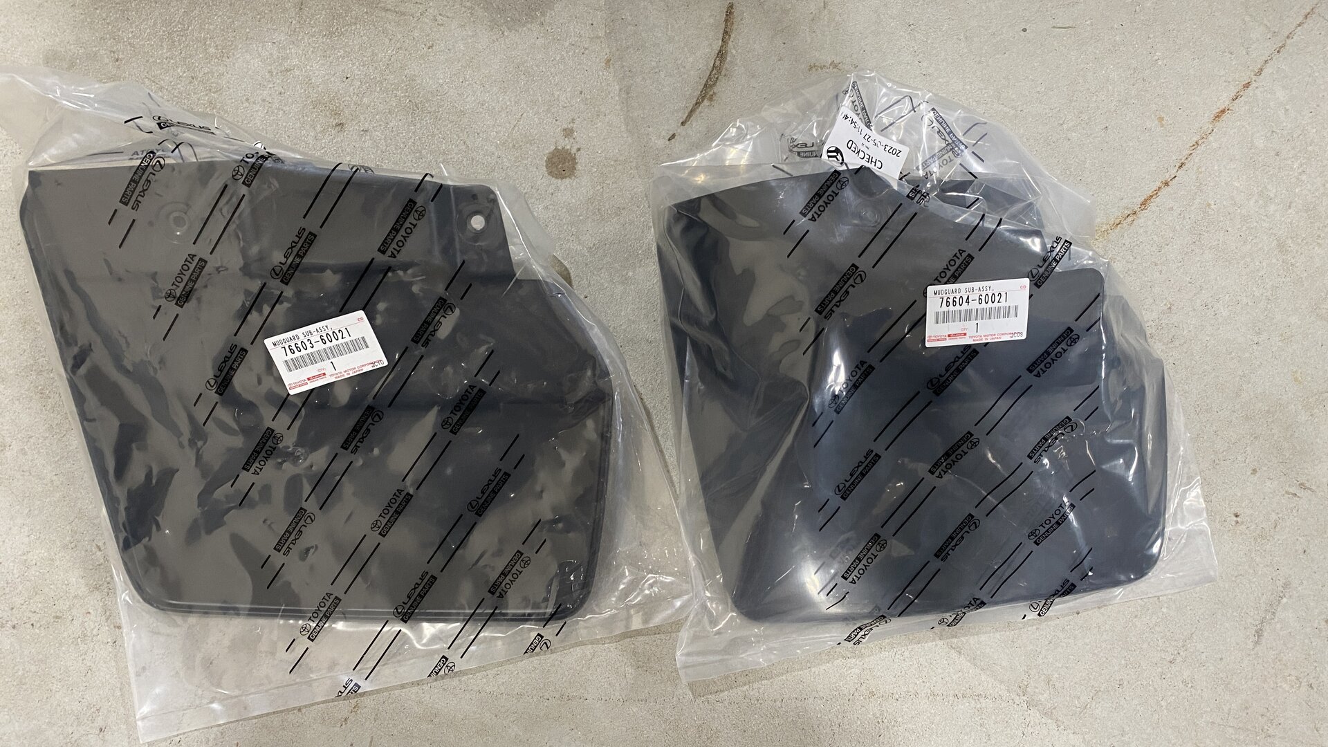

New front mudflaps, replacing the mudflaps with the cutout for the JDM step rails.

Now they look a little too new.. should have replaced the rears at the same time.
Do you have a link? Thanks. “Wallet shrugs and then sighs”.
Partsouq or a US distributor -
Well, when I go to the link and check to see if it will fit my vehicle, it says no bueno. I can’t imagine that 7 years would make that much difference. Go for it or run run away?
What year is yours? I believe the early model flares were slightly different but don’t quote me on that
