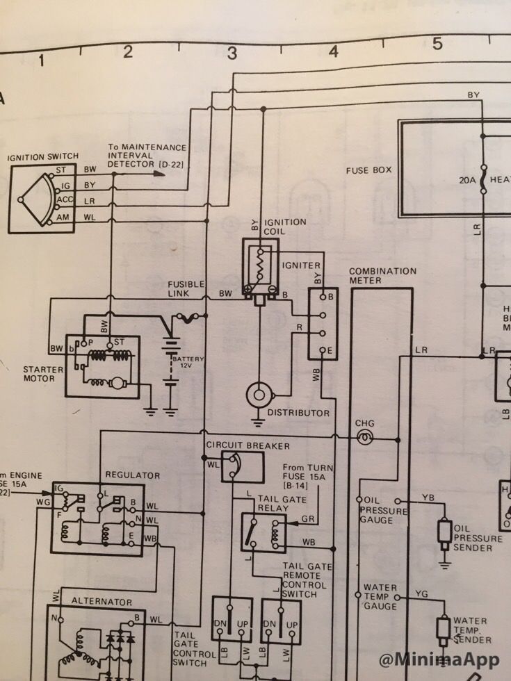

The generic diagram that shows the electronic ignition shows the following:
BY is switched ignition voltage. BY should go to the ignitor to power it, and to one end of the bypass resistor. The other end of the resistor is connected to the coil positive (where the condensor is also connected). BW is the bypass voltage that comes from the starter when it is cranking and that goes to the coil positive. B goes from the coil negative to the B terminal on the ignitor.
Are you missing the bypass resistor?
.... B goes from the coil negative to the B terminal on the ignitor.

Does your ignitor have power, ground, a wire to the distributor and a wire to the coil negative?
Does your coil or coil/resistor combo have power, a wire from - to the ignitor, and a wire to the starter?
If so, you should have everything.
I think so, yeah. Seems to have all that. The idea of a loose wire just irks me, however. But I think I need to get over that for my build or I'll never make it through (I suspect I'll face that a lot).
Installing a FJ60 Dizzy Scroll down to the NEW Distributor section
The FJ60 igniter only needs two connections (well three... make sure the igniter assembly is grounded through the mounting brackets.)
Connect the BY from your harness +12V to the MALE single pin connector.
Connect the two terminal connector from the igniter to the dizzy.
If you have a tach then you will connect the tach lead from the harness to the FEMALE single pin connector.
The igniter does not require a ballast resistor so the BW wire will not be used.
