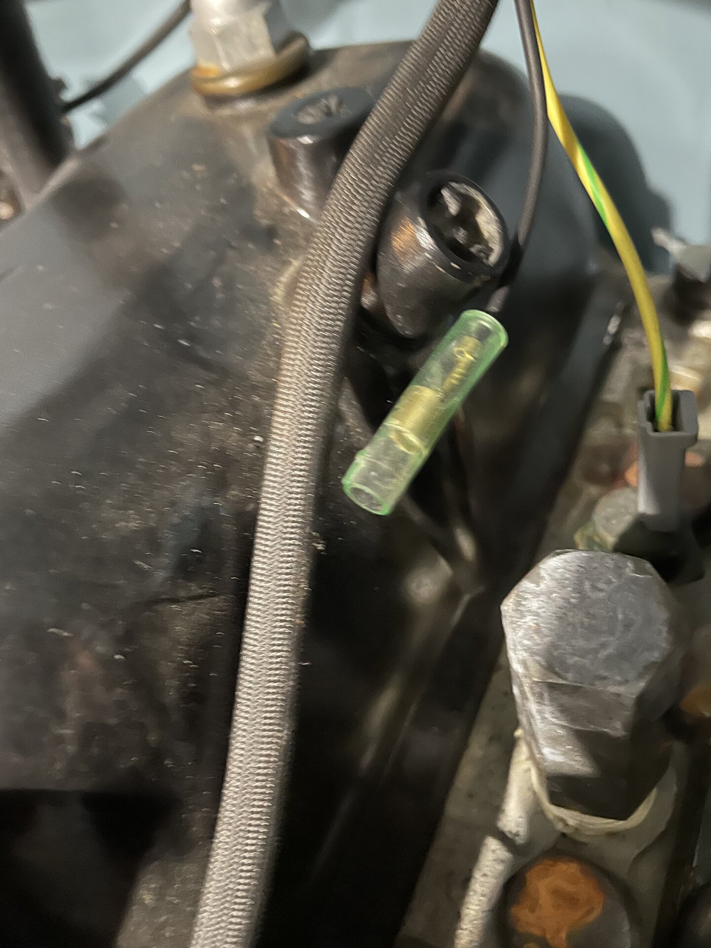

Idle Cut Solenoid
Sep 6, 2011
257
3,114
Woodstock,GA
I currently have a 74 FJ40 with a 2f engine and 75 carb. Can I use the original setup on the 74 which consists of the wire on the harness side coming through the firewall (attached picture) or do I have to use the 1975 setup? Any help would be greatly appreciated. Thanks
the later parts supersession 2F era 2 wire ICS , part # 21062-61060 can and did travel through the fire wall before its circuit was relocated to the drivers side fender apron ...
