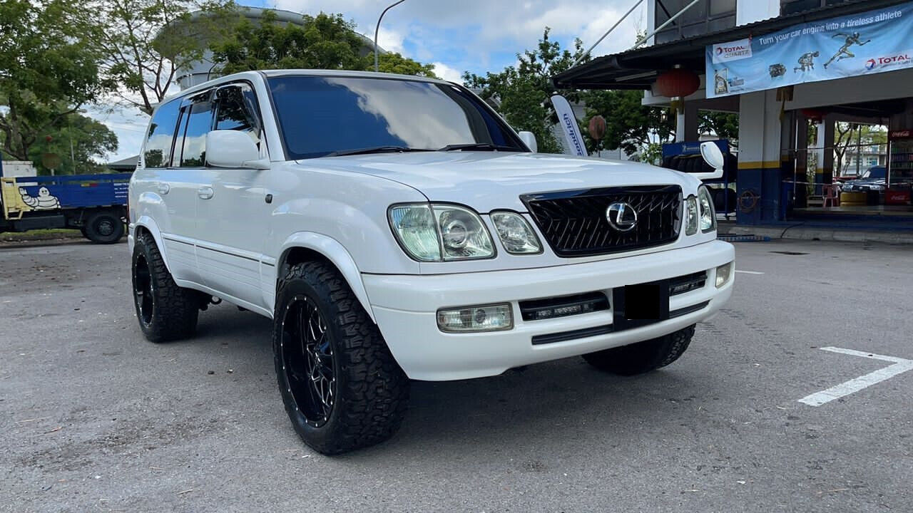

What look are you going for? This but a little higher and in steel? To me, most fender flares I see for the 100 give it a double-flare look... which I'm not fond of. you could go to a large flare... like over the size of the original "flare" and that would be more like the Arctic truck look.
for JDM Land cruiser Lexus LX470 arch fender flares 100 series ...
going to factory body lines, but just pulling out and up on the front fenders, as the rear tucks just fine
