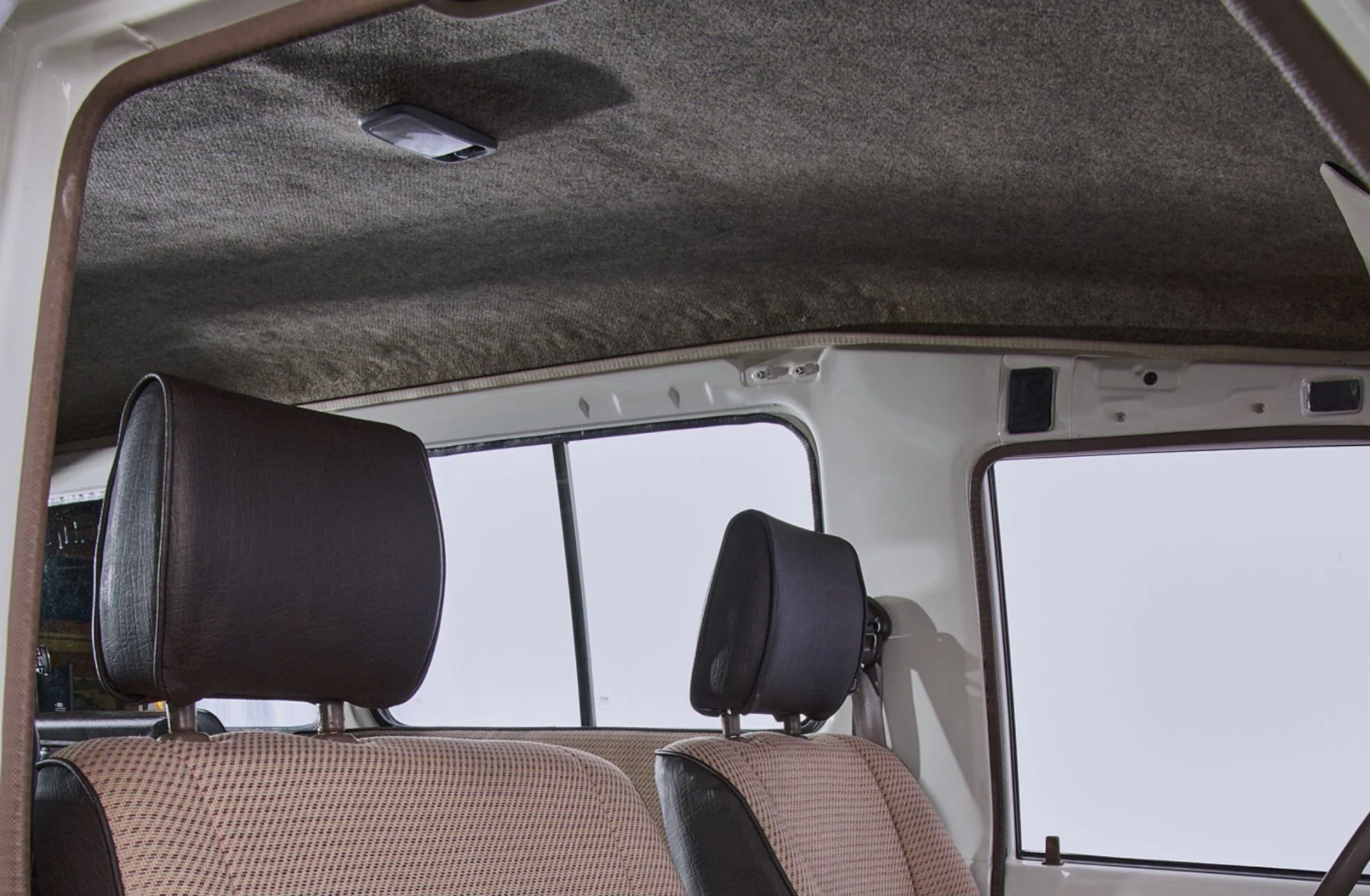

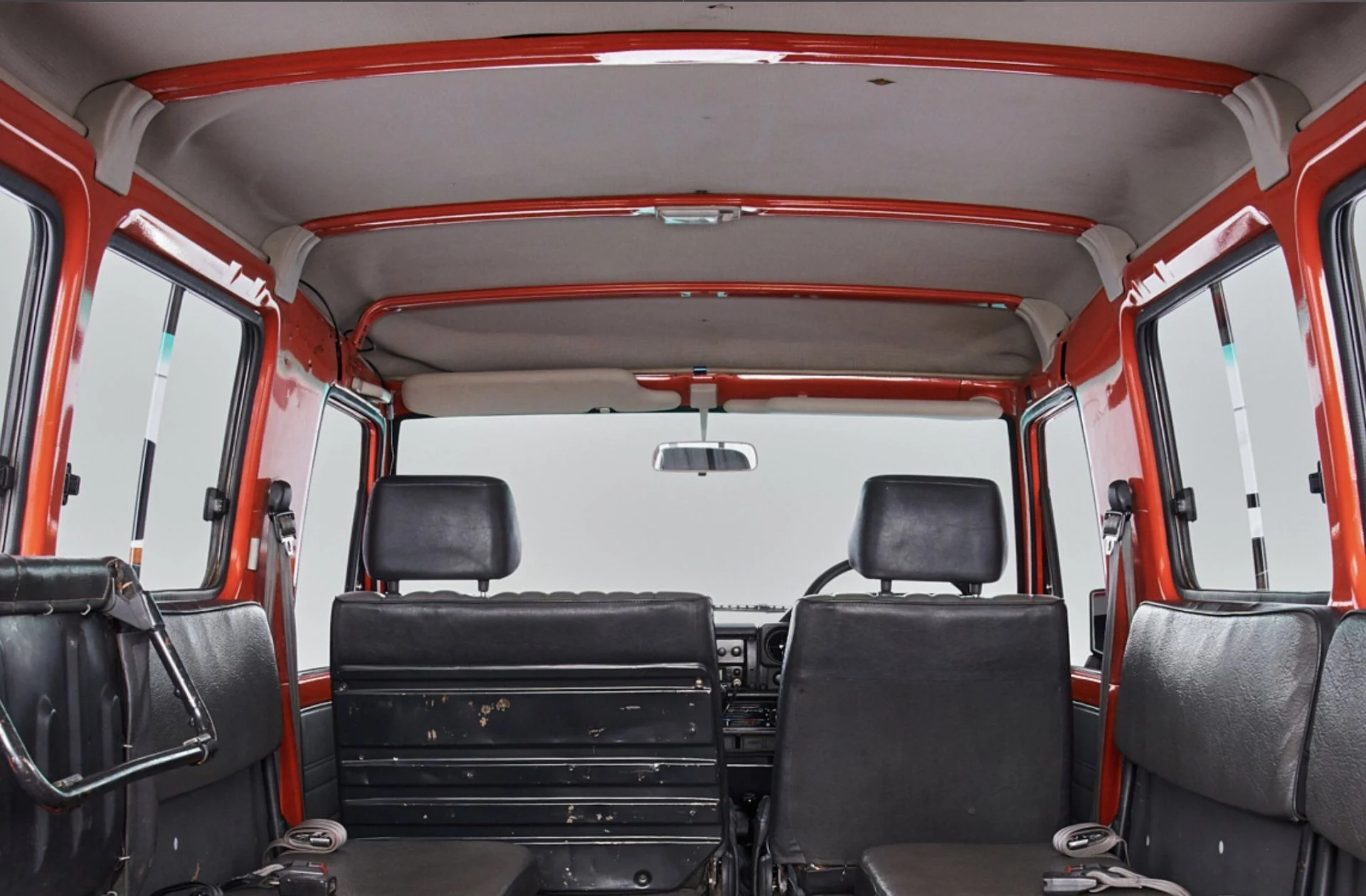

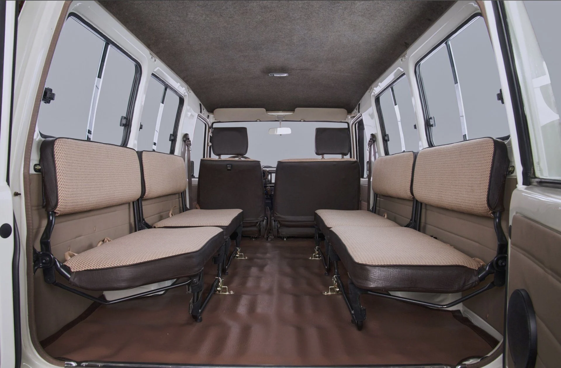

I was just looking through the photo gallery on the Land Cruiser Heritage Museum site and saw these 70/75 series photos and got me thinking again on the subject. Couple examples below...check the edges, the head liner is completely independent of anything else. This would make roof maintenance and sound deadening a lot easier and open up the ability to play around with different fabric designs, etc. These are more utilitarian looking but still clean and classy. I’ve got some ideas, but the 60 roof edges present some challenges.

If you can get the stock headliner down or a spare, you can get the template and cut out your material. Remove the existing headliner and pad, then replace with sound deadener and lay on a heavier material similar to the red troopy you posted or use a headliner material (usually is foam backed) and spray it in place. I'm not partial to glued down headliners to the roof, for maintenance/servicing, but its your truck!

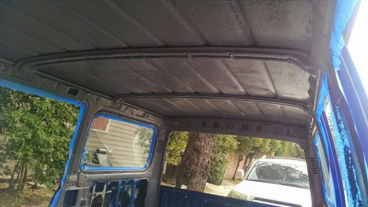

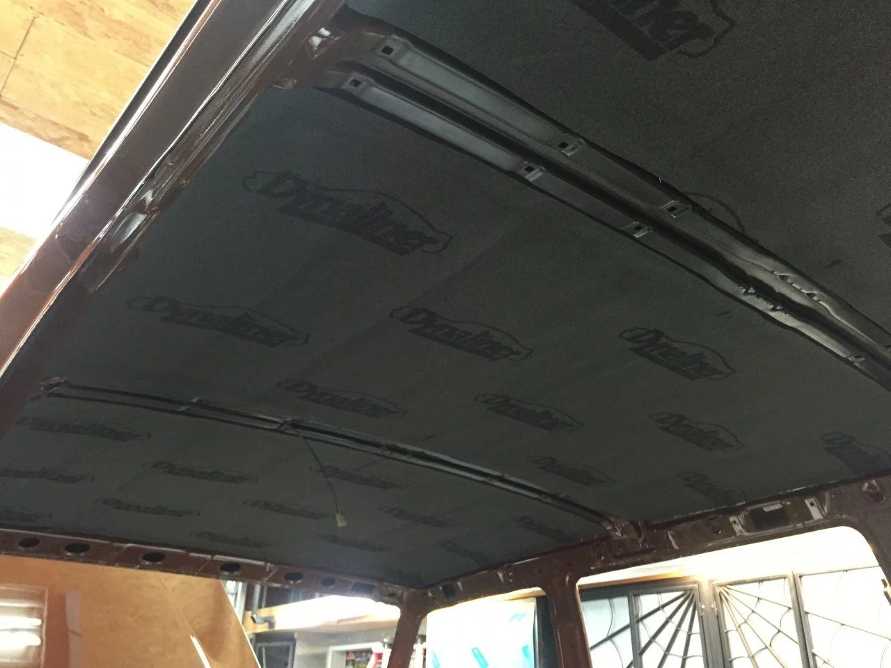

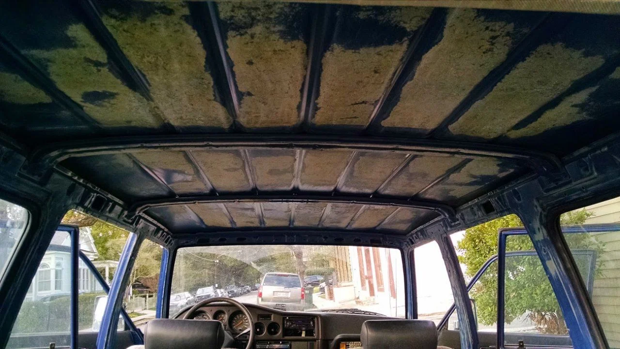

It is true, the bare metal roofline of the 60 ain’t pretty, especially around the edges, which makes blending the overhead panels to the edges a challenge. Couple pics I lifted off mud....

The dynamat truck could look good with stiffer board/material and use clips in the open holes along the cross beams. Unsightly area would be the perimeter between the doors/windows and roof skin/dynamat area. If you find a material thats thick enough to hold its shape along the roof with the clips I mentioned, but thin enough to be manipulated around the window/perimeter seals and that could work without glue.

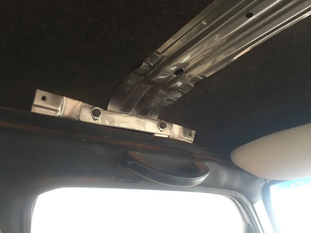

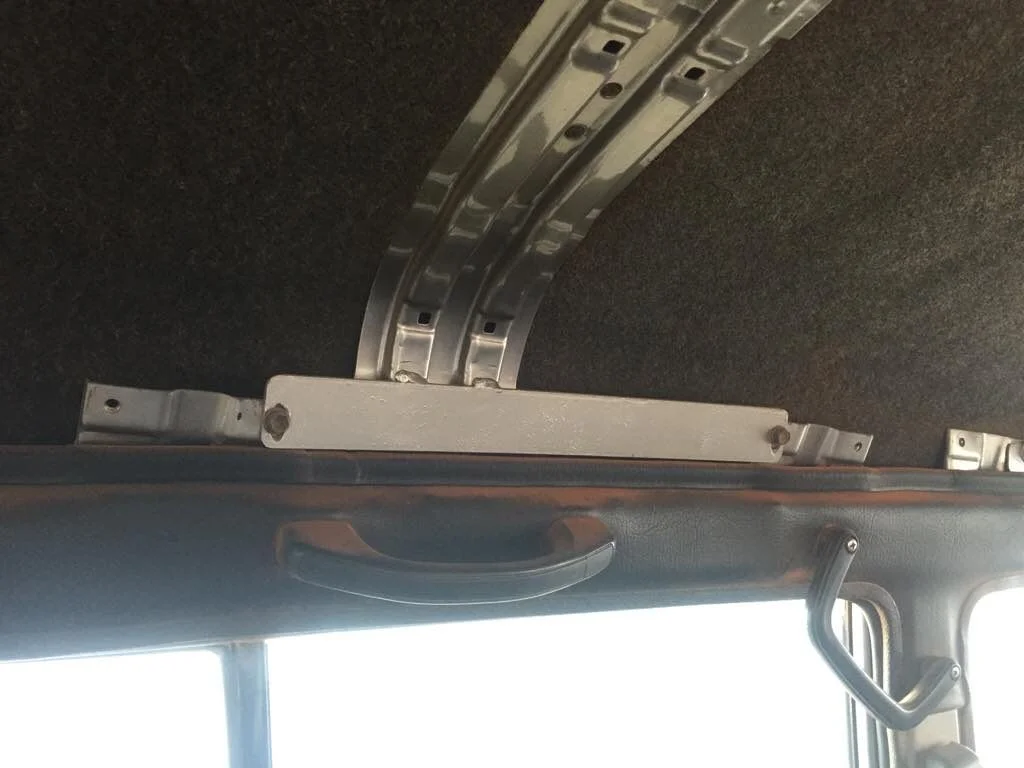

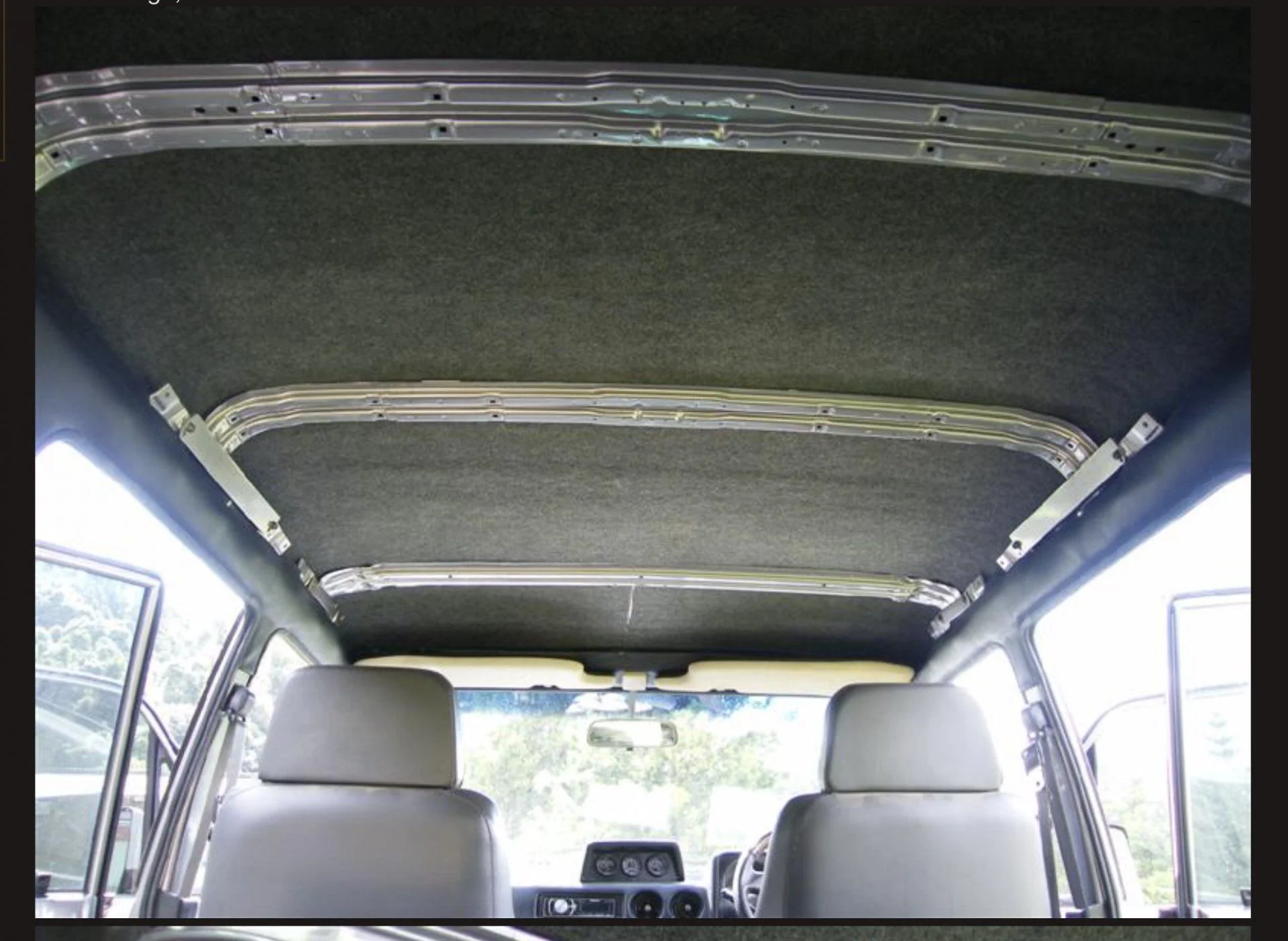

Found an interesting headliner option in this thread by @goldchaser on his hj61 hi-roof build. Not sure he frequents mud anymore.
He covered the roof panels with what appears to be deadener and glued on covering, not a fan of glue on. Then wrapped the perimeter edge in vinyl using pinch molding. Not sure whats going on with his extra sheet metal chunks though. I like this approach, but instead using removable roof panels that could be covered in whatever material you can imagine would be pretty slick. The roof ribs could support the panels, and probably need to be covered for aesthetics.

My headliner redo consisted of dynamite material, the OEM insulation pads and the SOR vinyl headliner replacement. Tunred out very functional because it is much easier to clean than the OEM fabric material. Something to consider if you exhaust modification options.

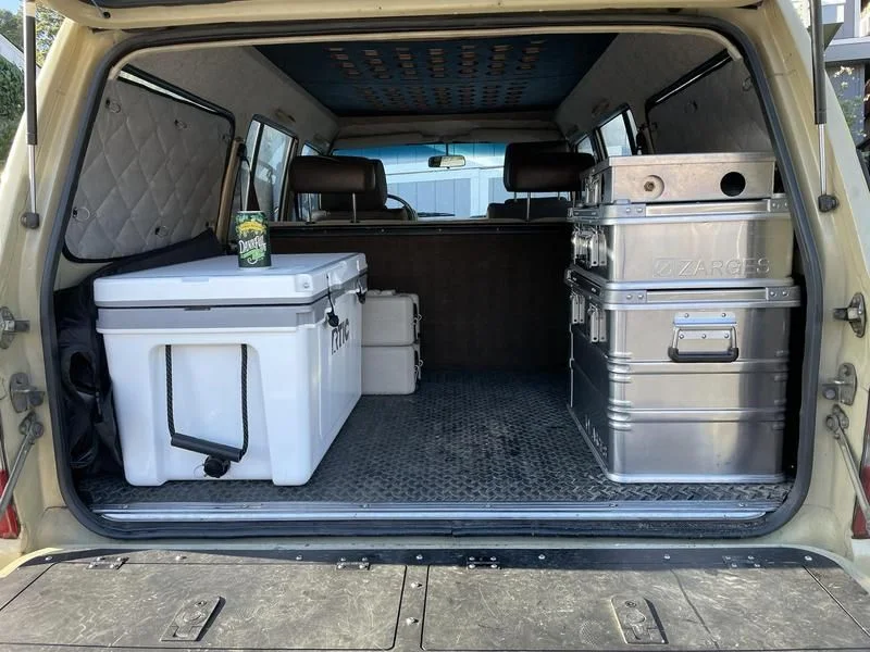

If I had more of a trail type rig I would do something similar to the Aussie rig I posted in post #11 (which is a high roof). The 60 series has some extra challenges around the roof ribs to make it a clean conversion.
