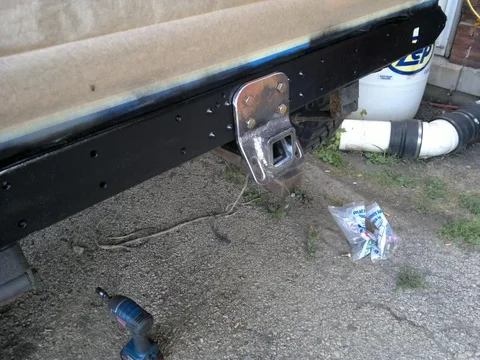

Worked a bit on the hitch and waiting now for paint to dry/harden on all the parts and need to start on the wiring too .

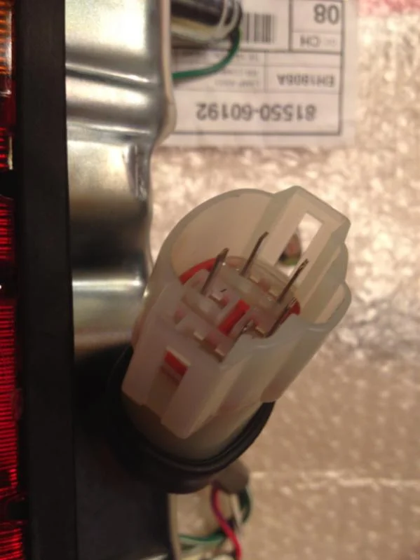

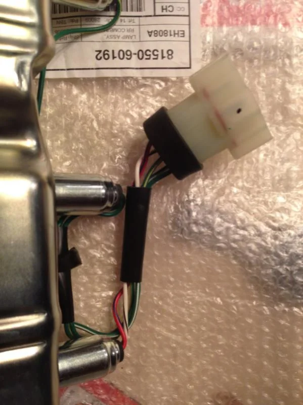

Here's how mine turned out for now , still need to finish the trailer plug and powered convertor to run standard trailer turn/brake lamps . I will install the plug behind the driver's bumperette sometime this week if it cools off a bit .

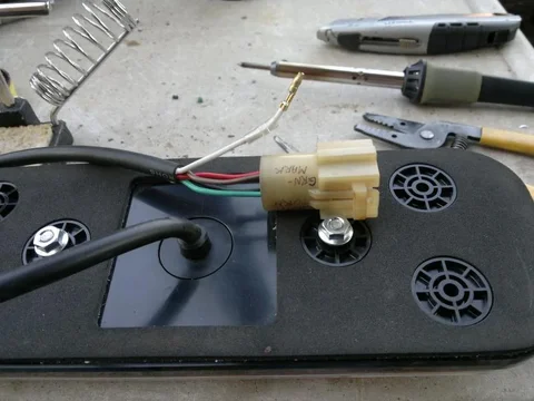

I took the stock connectors apart since they were in amazingly good condition despite how rotted the original lamps had been and re-used the blades by soldering in the new wires on the Narva lamps .

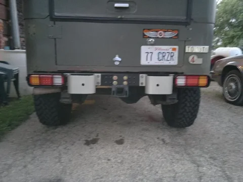

Here is everything mounted up including the custom guards I made from 3/16" steel -

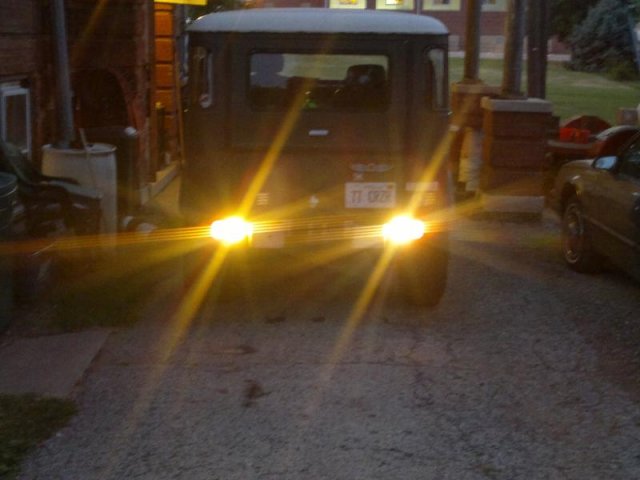

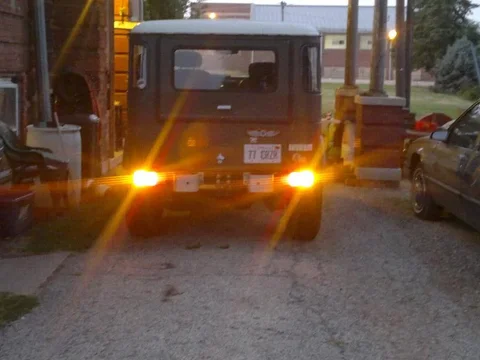

Did some testing of brightness last nite at dusk without the engine running , they are very bright and no excuses if someone ever hits it .

A buddy stopped by after it got dark - even with the guards in place the built-in reflectors light up pretty well . I'm trying to find some round bolt-in units that might sit flush into the stock bumperette for a neater look and give it a bit more reflector when parked . Still considering installing the stock round reflector units into the corners since it is sitting many times on construction sites in harm's way - just don't want it getting hit .
Next installment is installing the 7/5/4 wiring plug , powered convertor and possibly a semi-hidden trailer brake controller . This old 40's job is to work and serve to keep my nearly perfect '08 Taco in top shape .
