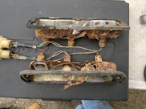

Ok , got some time to get started and tore into the old lights yesterday , what a mess -

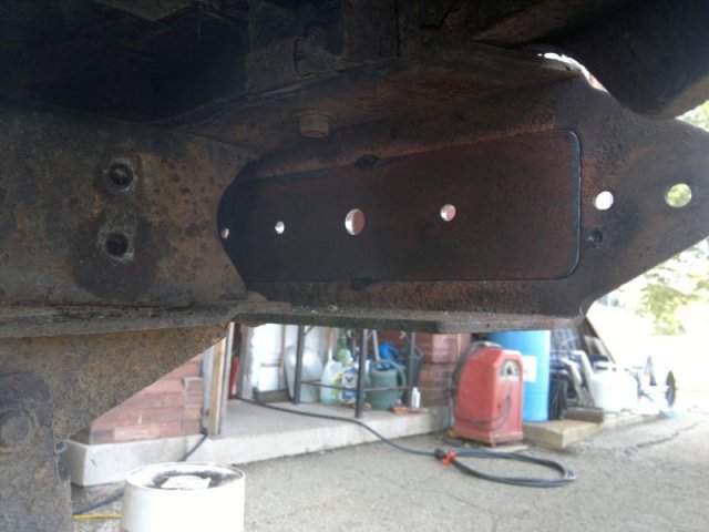

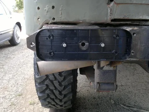

I cut a pair of filler plates to cover the oem holes to allow the bases for the new led's to be surface mounted to the rear crossmember . The filler plates were only face welded , not fully gap welded/penetrated to allow removal later if I ever want to return to oem tail lights .

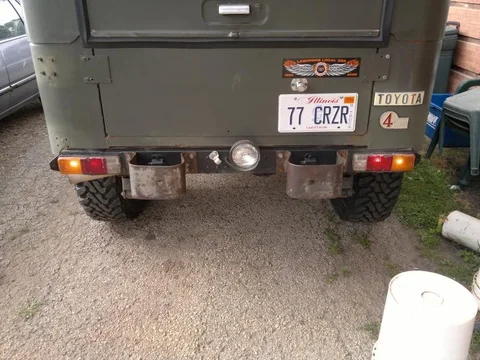

Once mounted , I set up the guards I bent up so they mount to the factory holes in the ends of the crossmember and tabs to fit over the top of the stock bumperettes .
Wow, looks like you were over-due for new lights anyway Sarge!
