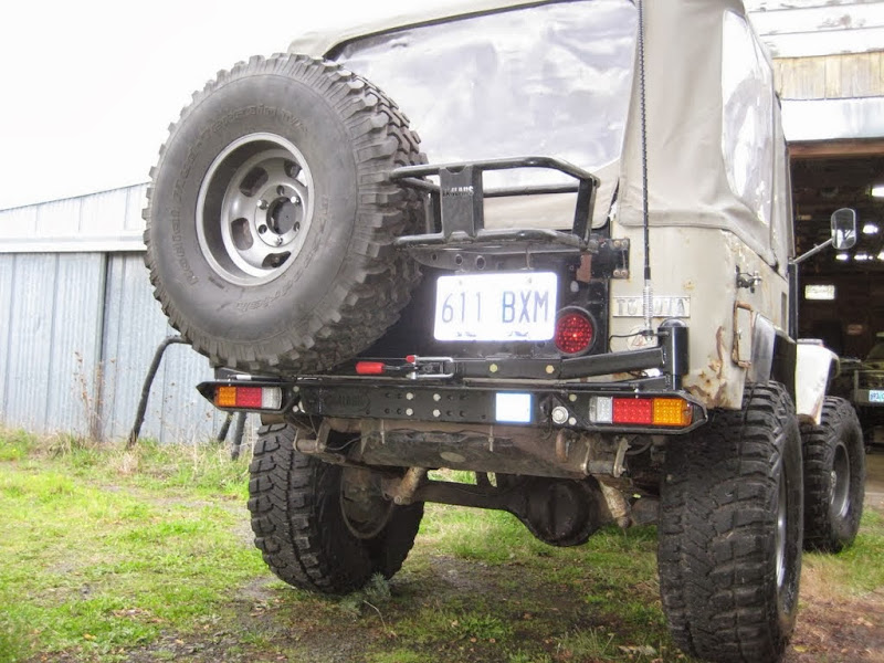

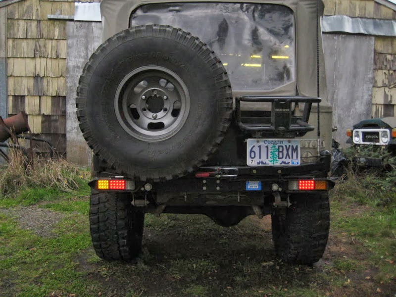

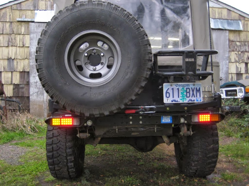

Back to business. I took time to get my bumper and tails installed before Cruisin' The Woods. Didn't get reverse found and wired, but I have Vision X rock lights with rare earth magnets strategically placed for action if needed. Then I decided to run out to Colorado for a friend's wedding and now after picking up some sweet parts in Cali and visiting with a few friends there I have time to post up pics.

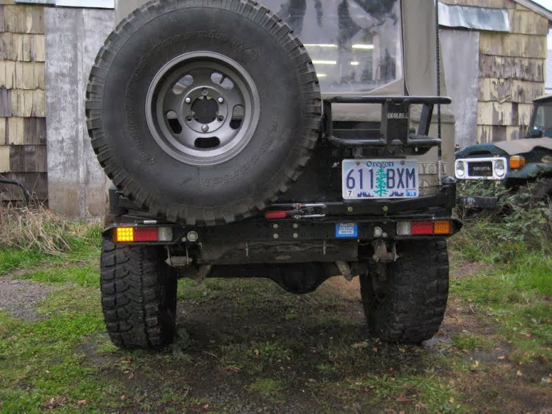

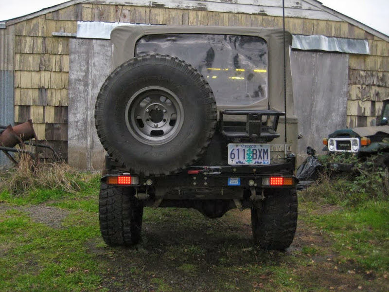

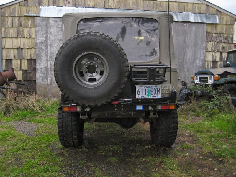

I think they are sweet! They are not over bright.. if brand new OEM tails are a 5 on dim1-10bright, then these are 6 or 7, so very adequate which is how I like my tail lights. The truck sits high enough that anything brighter would be seriously annoying to folks behind me.
[URL="https://lh5.googleusercontent.com/-K94gGa0sZF8/UldccSZ4h8I/AAAAAAAALqk/BfYXV49qMKo/s800/IMG_2639.jpg"][/URL]
[URL="https://lh6.googleusercontent.com/-ql2Hdi_ejVU/Uldcdamli_I/AAAAAAAALqs/8c0JEChfIsE/s800/IMG_2641.jpg"][/URL]
parking lights
[URL="https://lh5.googleusercontent.com/-NGXHhefTqd0/UldcegsjetI/AAAAAAAALq0/PnwgZIYrbIQ/s800/IMG_2643.jpg"][/URL]
turn signal
[URL="https://lh4.googleusercontent.com/-XVG7xTI2rKQ/Uldcf39heeI/AAAAAAAALq8/Fj4L0G_7QQs/s800/IMG_2644.jpg"][/URL]
turn signal with parking
[URL="https://lh6.googleusercontent.com/-nvoh_1WkgV8/Uldcg5lLFgI/AAAAAAAALrE/NxBcgkx2vkk/s800/IMG_2645.jpg"][/URL]
pretty crappy shot of turn signal with brake
[URL="https://lh4.googleusercontent.com/-YTbe3--Q0Hc/UldciHtAdRI/AAAAAAAALrM/QcrZfBByq2o/s800/IMG_2646.jpg"][/URL]
Man those look nice and the size is great. On the website you posted it said they have internal resisters? Did you have to do any special wiring to hook them up? How are the back up lights?
I have done nothing to the wiring, that is to say I have a bad ground somewhere so unless I have peak voltage, one side blinks and the other doesn't. I use a flasher that isn't load depended so it doesn't matter whether a resister exists or not.
Reverse is bright. If I need more, you can see the Vision X's stuck on the bumper too (rare earth magnets epoxied to them). I use them as extra bright reverses when not in night wheeling duty (which is 99.9999% of the time).

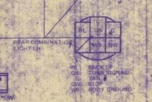

Does this help?
Left / Driver side
Right / Passenger side

Rudi's diagram should tell you all about the wire colors; I don't remember exactly which was which from my installation, but using the wiring schematic from my Factory Service Manual it was dead easy. If you need me to, I can get out the schematic again and tell you. The wire colors for the new LED are clearly shown in the included paperwork.
The load resistor is only needed for the turn signals; it just goes in series between the turn signal wire and the ground wire (on each side).

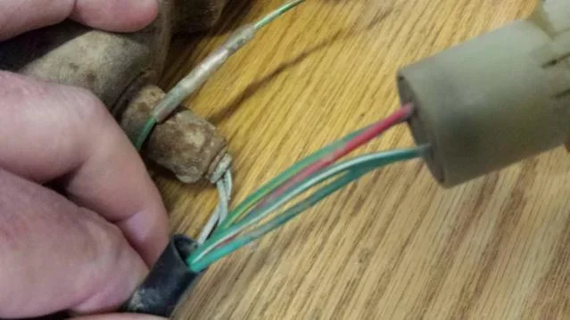

Ah that is very helpful, but I only have 4 wires coming out of the connector?
What am I missing?
What am I missing?
Mine (12/79 build) has a white with black stripe (ground) coming from the stock connector, that yours seems to be missing. Yours is a '78 (from your sig.)? Do you have the wiring schematic from the FSM for it?
No. Ground was run separate. Got it figured out and working well.
